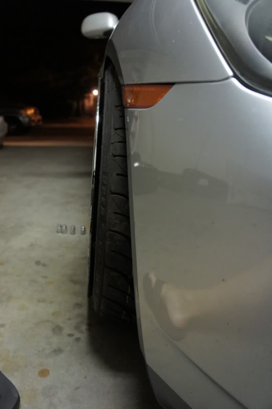

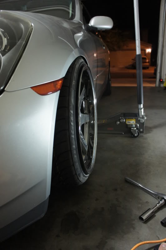

Trying to decide to which route to go, 10mm or 15mm spacer...
This is 9.5 +12 with an added 8mm spacer putting final offset at +4.
Im leaning towards the 15mm spacer to get for the fronts for final offset of -3.
And this was for sh*t and giggles, I took the 10.5 and added it up front with the 8mm spacer.

Leave the 10.5 in front

doet!

Agree Do It !! lol
