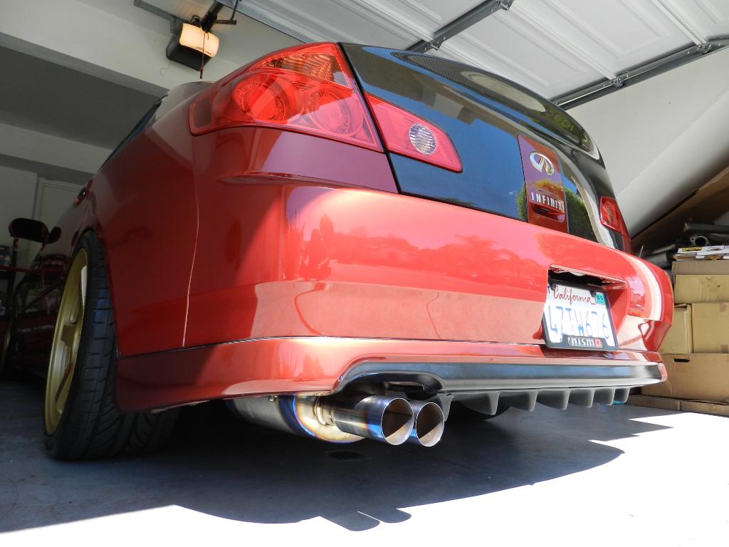

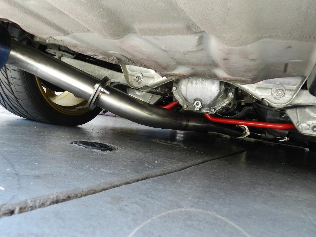

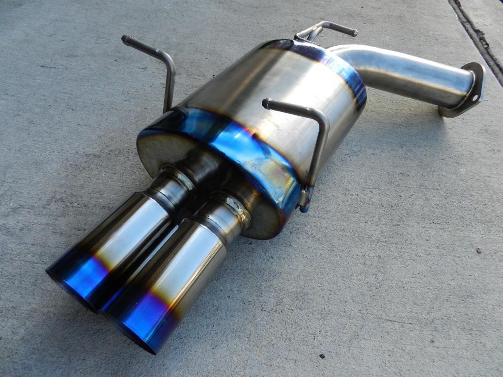

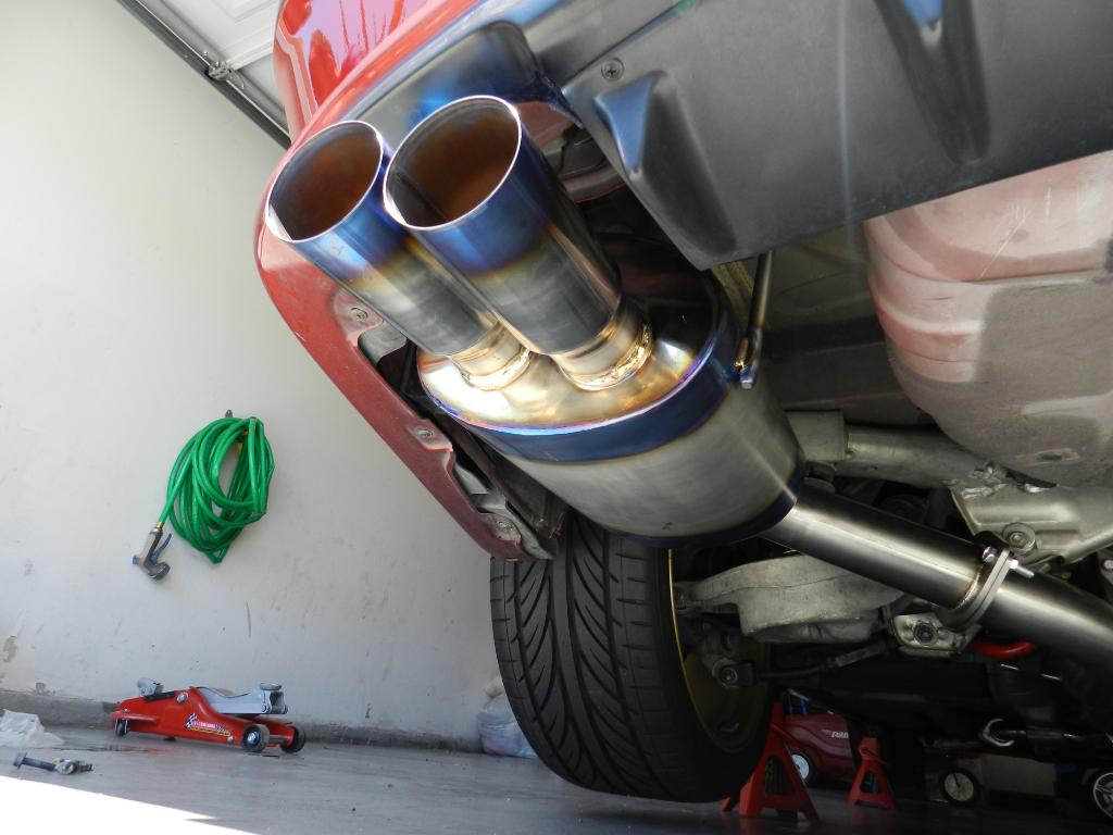

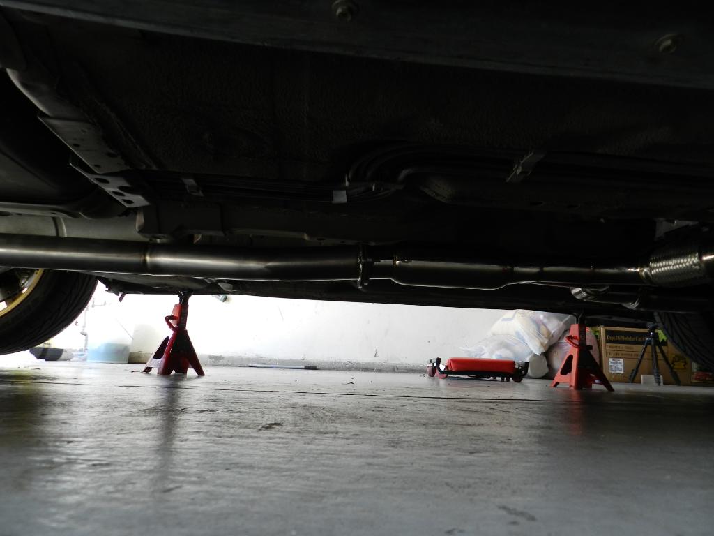

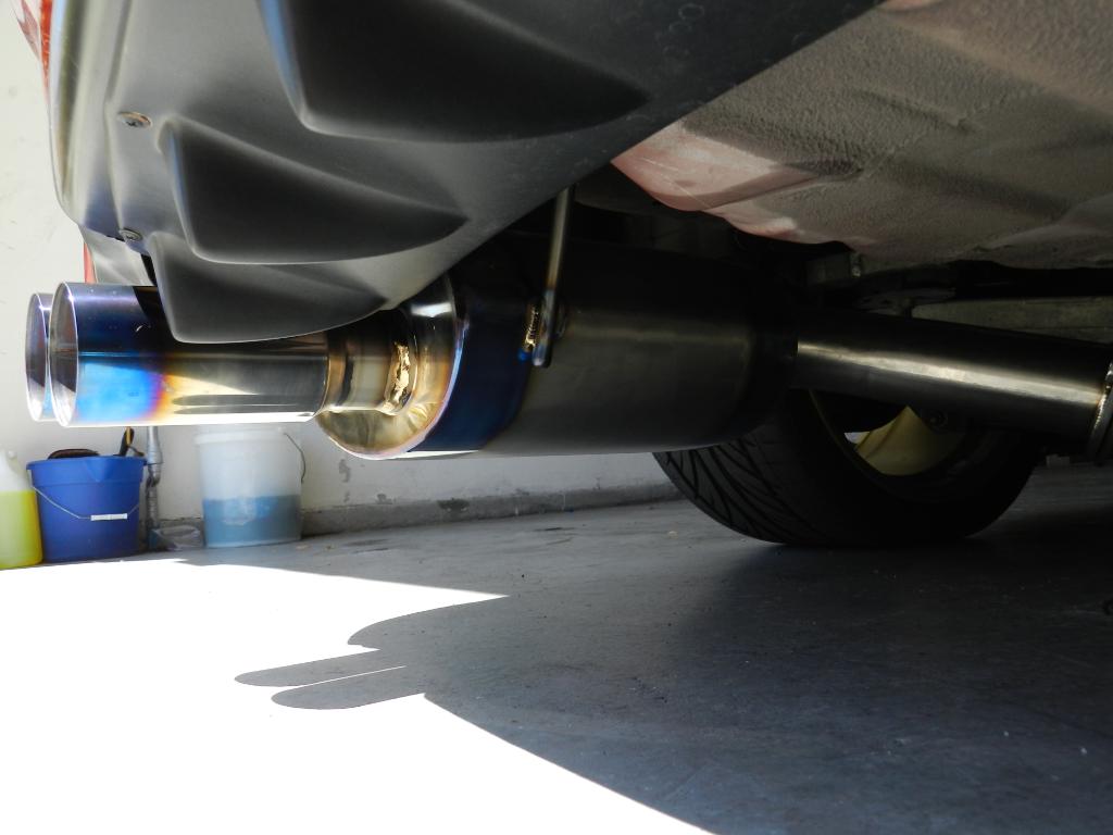

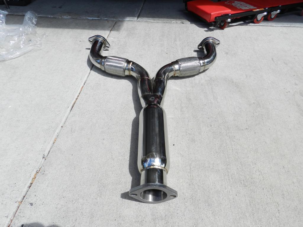

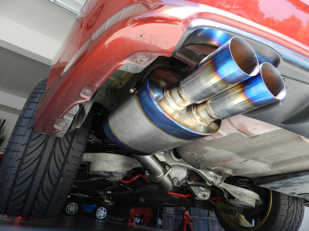

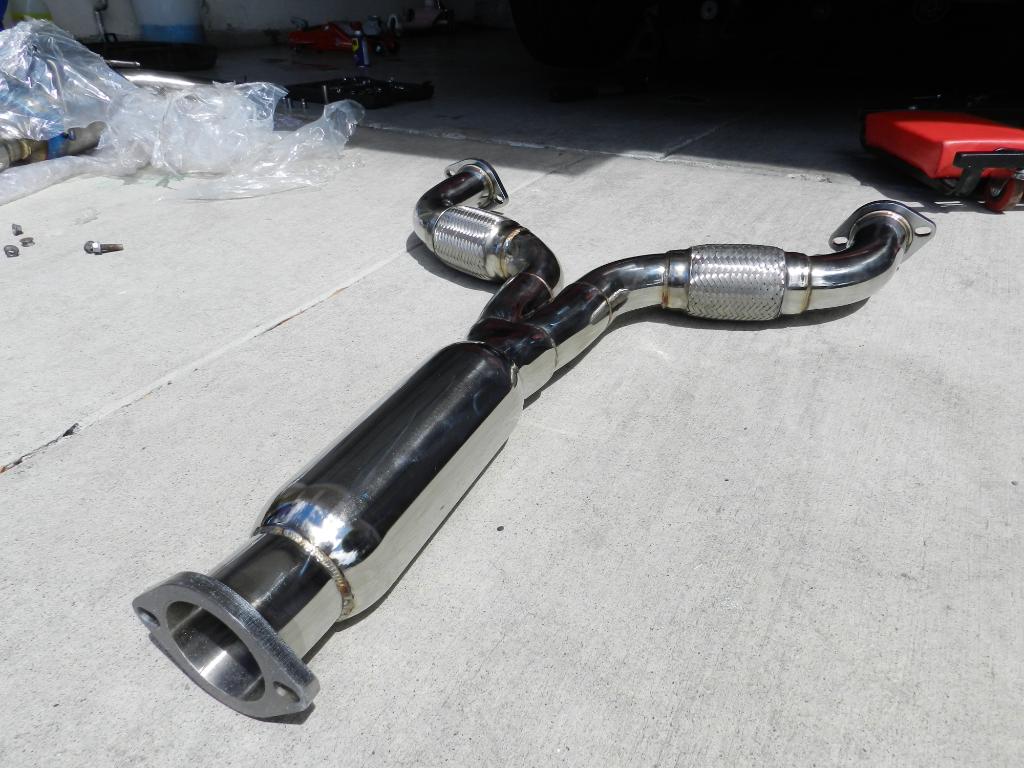

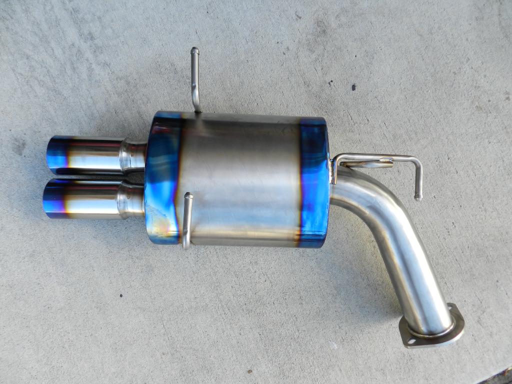

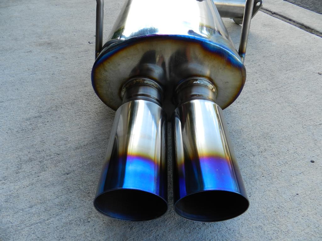

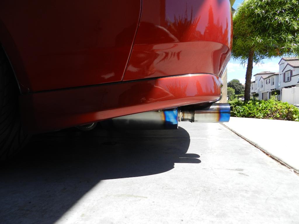

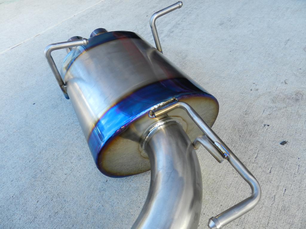

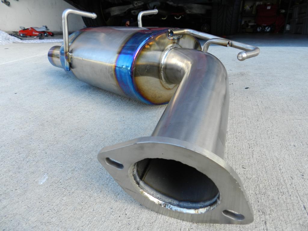

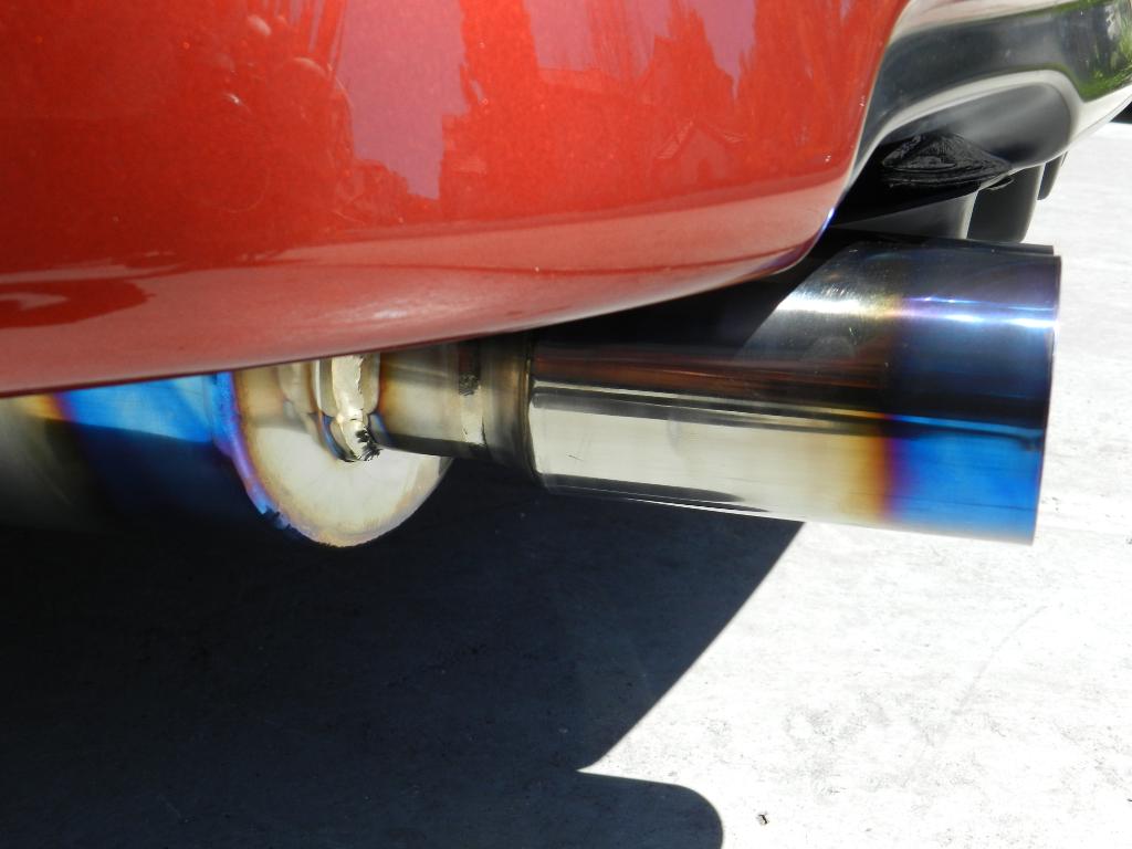

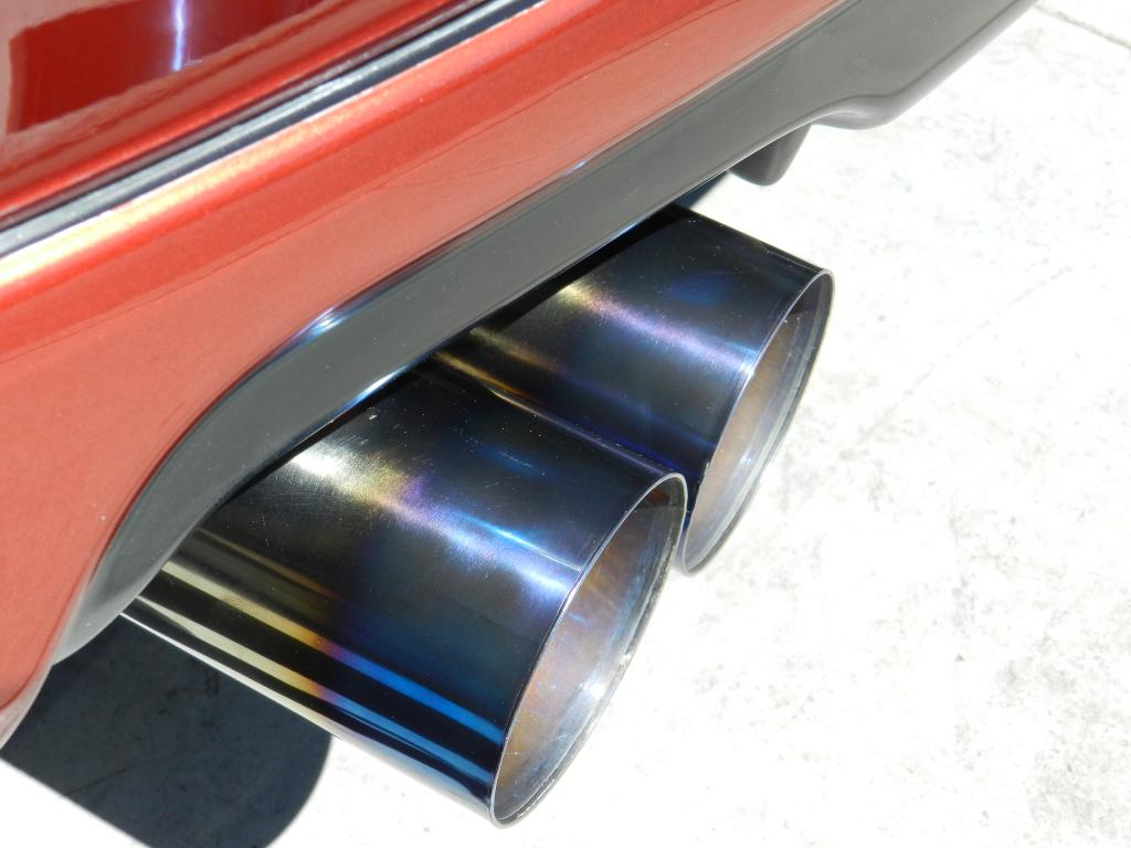

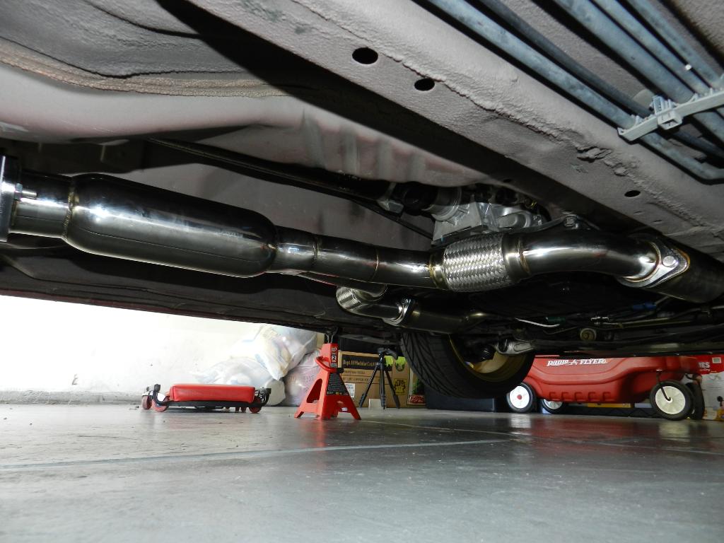

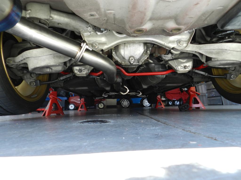

Litespeed Racing Titanium Cat-back Exhaust
Resonated y-pipe: 2.5" inlets/3" outlet (Stainless Steel for now while waiting for Titanium version to arrive)
Straight through(un-resonated) mid-pipe: 3" (Titanium)
Twin tipped muffler: 3" inlet/3" tips (Titanium w/heat treated "burnt blue" accenting)
Ti middy + Ti muffler = 14lbs
Ti resonated y-pipe = 6lbs
OR
SS resonated y-pipe = 10lbs
*gonna revise the hangers to make it sit higher/better in a week or so

looks good Mark!! Is it leaning lower on the right??

thanks, yeah the hanger couldn't reach so it's sagging. gonna have it fixed during the week

SOUNDS LIKE A BEAST!!!!!!!! never seen anything like this before?? titanium?? where did this come from?? who made it?? is it alien?? hhahahah jp. definitely uncommon. your car is so clean even the bottom end is clean.... lol. Keep inspiring Mark.

Wow, I've never heard a exhaust like that for our cars that stay deep toned even in the higher rpms...Info on how to obtain one of these setups? Not only does it sound good, it sounds powerful!
