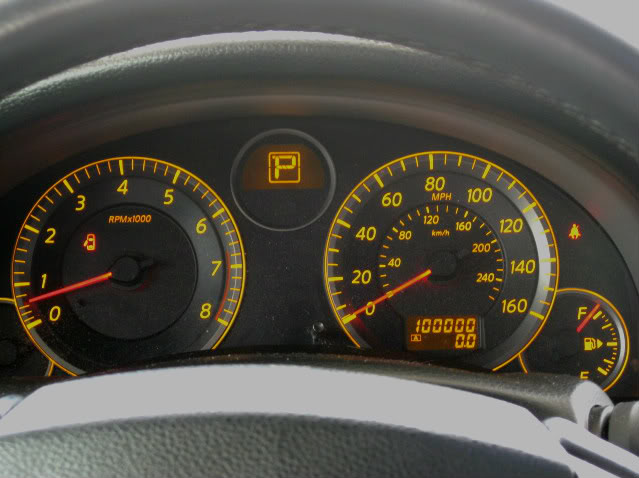

Update 12/9
Wheel was repaired so that's a big load off of my mind. I think I would shed a tear or 2 of I ever damaged one of these beyond repair as I can't just go out and buy a new one since they've been discontinued for so long.
On another note my girl officially entered middle age yesterday so she's right there with me.
I'm looking forward to the next 100K...............

damn tim 100k...crazy you and your car are old ROFL!

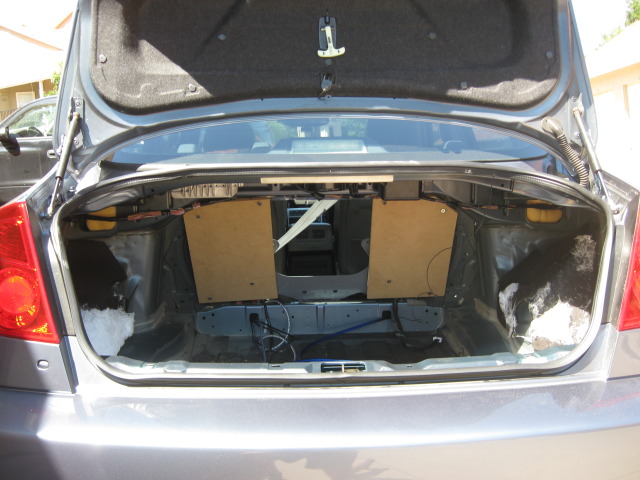

Wow for all of you that think this is an easy task I'm jealous. A friend of mine and I have invested about 22 hours into this project and all I have left to fix is the back up camera. I learned a lot along the way and helped troubleshoot a few issues as well. Started off with stripping the rear seats and the trunk liners.
Show more
Show more
Then pulled the HU

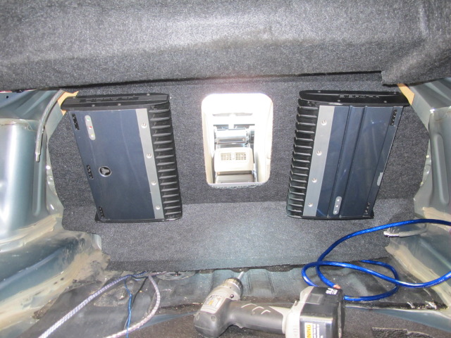

Wasn't happy with mounting points for my amps so I built 2 mounting boards out of 1/2" MDF to mount them which are painted Lakeshore Slate, same color as my car. Amps are JL 300/4 and 500/1.

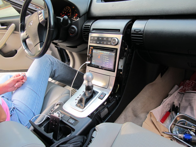

On to the HU and all the BS that went with it. Fabbed up the Bose plug for the Metra 7550 and it worked like a charm, thanks to those who posted links on this.

Mounted the sub in the 4080 box, the back up camera, and the amps to the rear deck. Still having an issue with the camera but that will be worked out shortly.
Show more
Show moreThen pulled the HU

Show moreOn to the HU and all the BS that went with it. Fabbed up the Bose plug for the Metra 7550 and it worked like a charm, thanks to those who posted links on this.

Show moreMounted the sub in the 4080 box, the back up camera, and the amps to the rear deck. Still having an issue with the camera but that will be worked out shortly.
