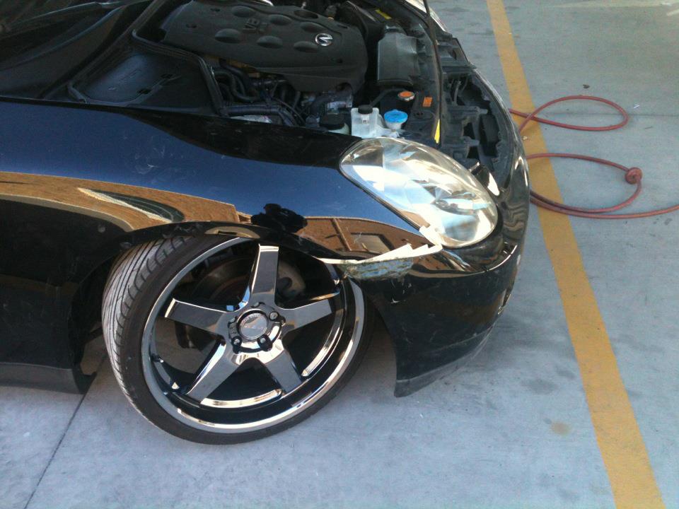

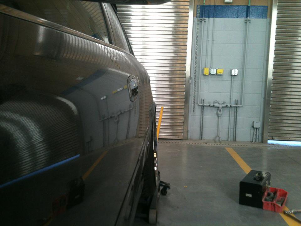

Fixed a couple of dings

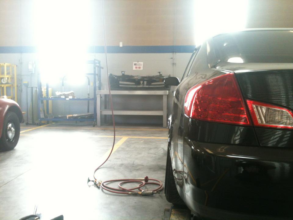

Filled in the holes where the sidemarker went with kitty-hair and fiberglass mat... It's not done just yet, I left it unfilled at the end so I can shape it to the fenders when they are done...

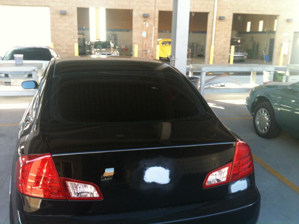

Shaved and filled in the little holes where the emblem goes...

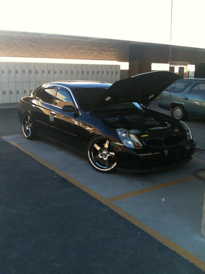

It's a bad angle in the pic, but the car looked sooo good as I was walking towards it and had to snap a pic... lol

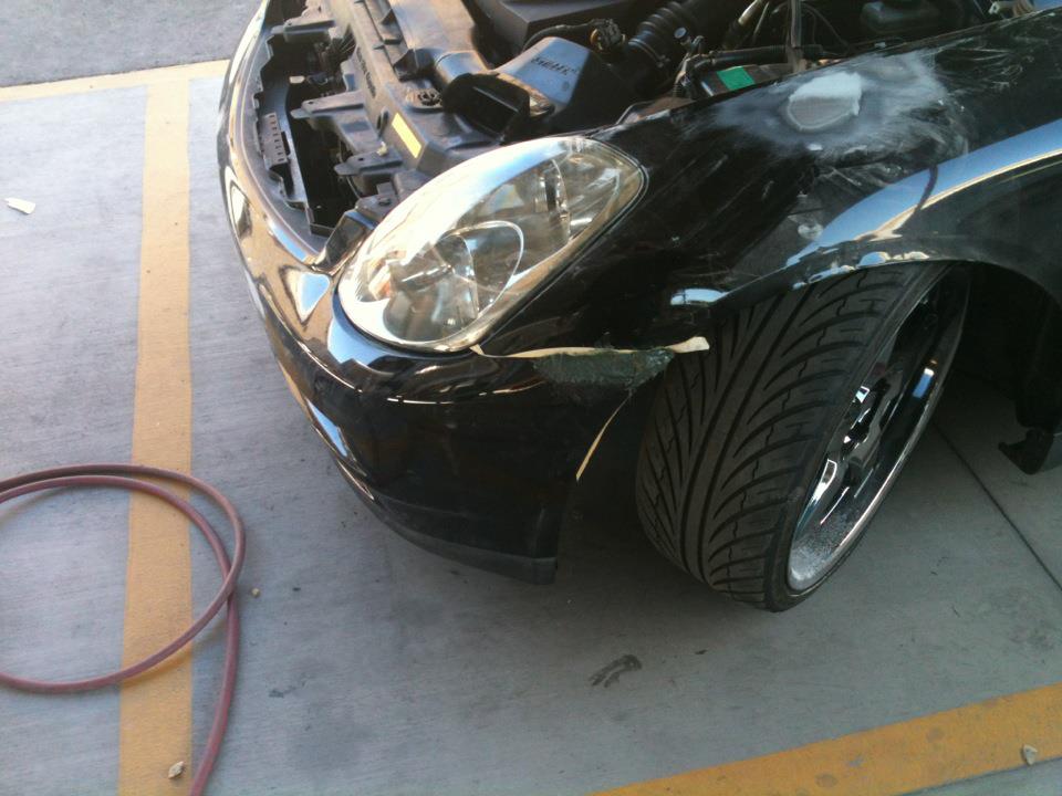

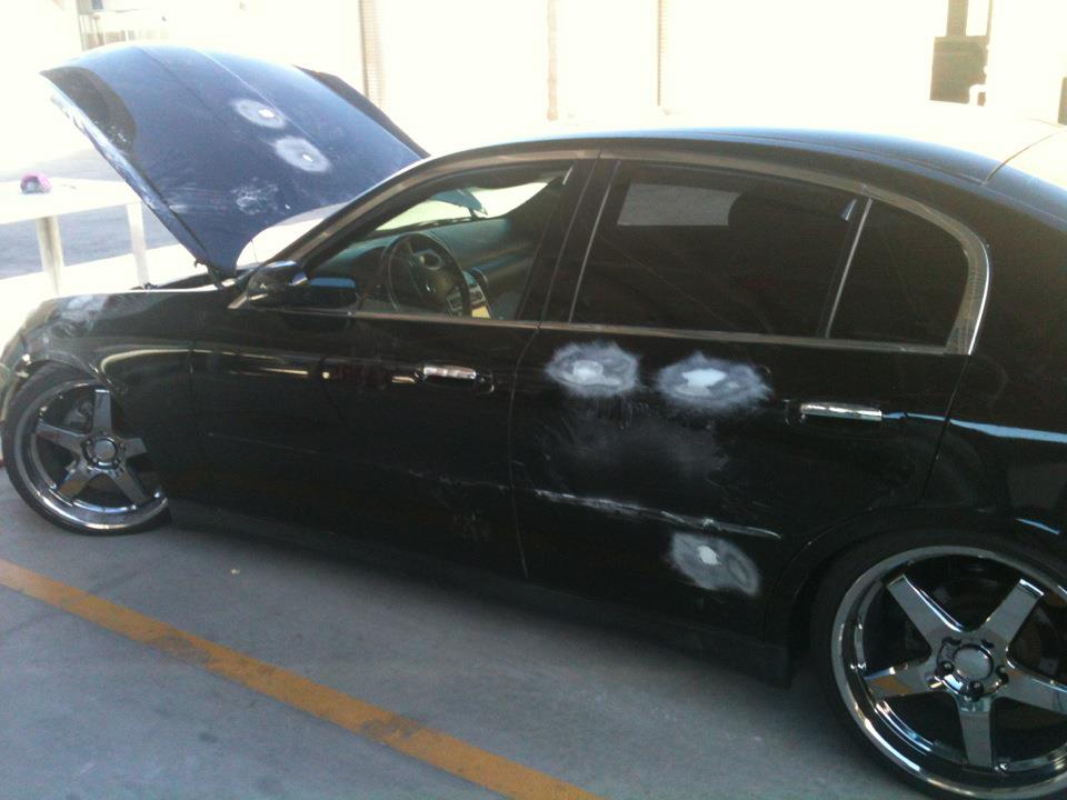

Dings, dings, and more dings.... GRRRRRRRRR lol
Don't know why these pics came out rotated, but if you flip them, you get the idea, haha

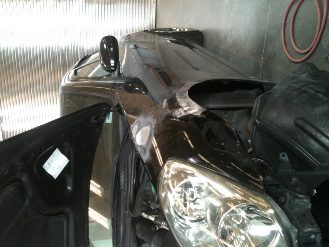

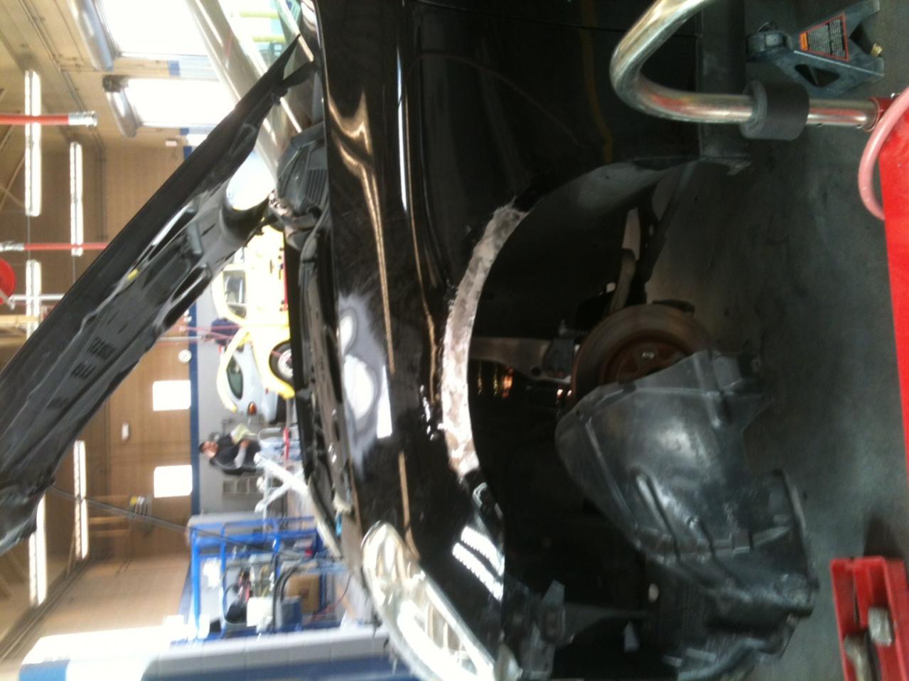

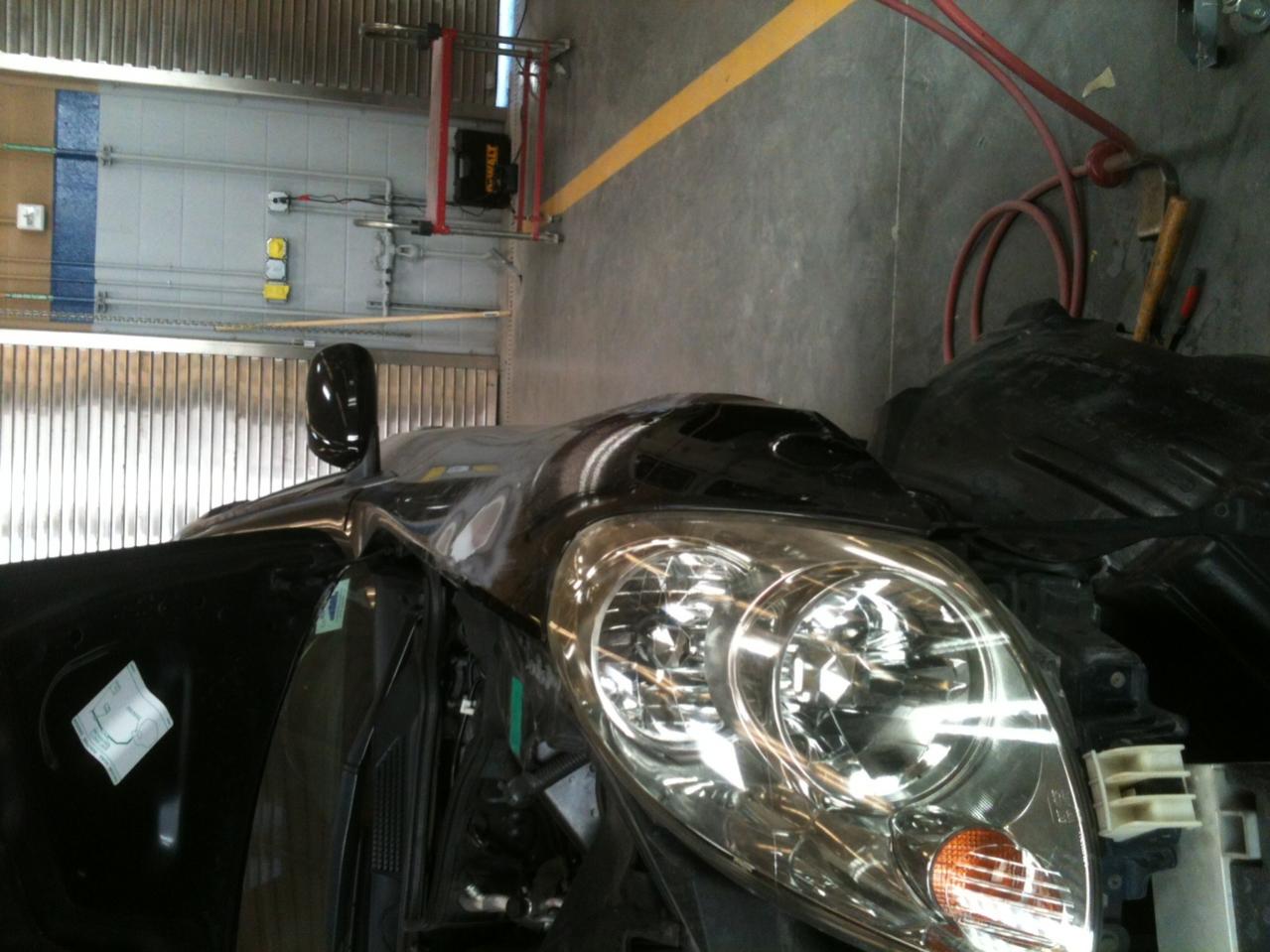

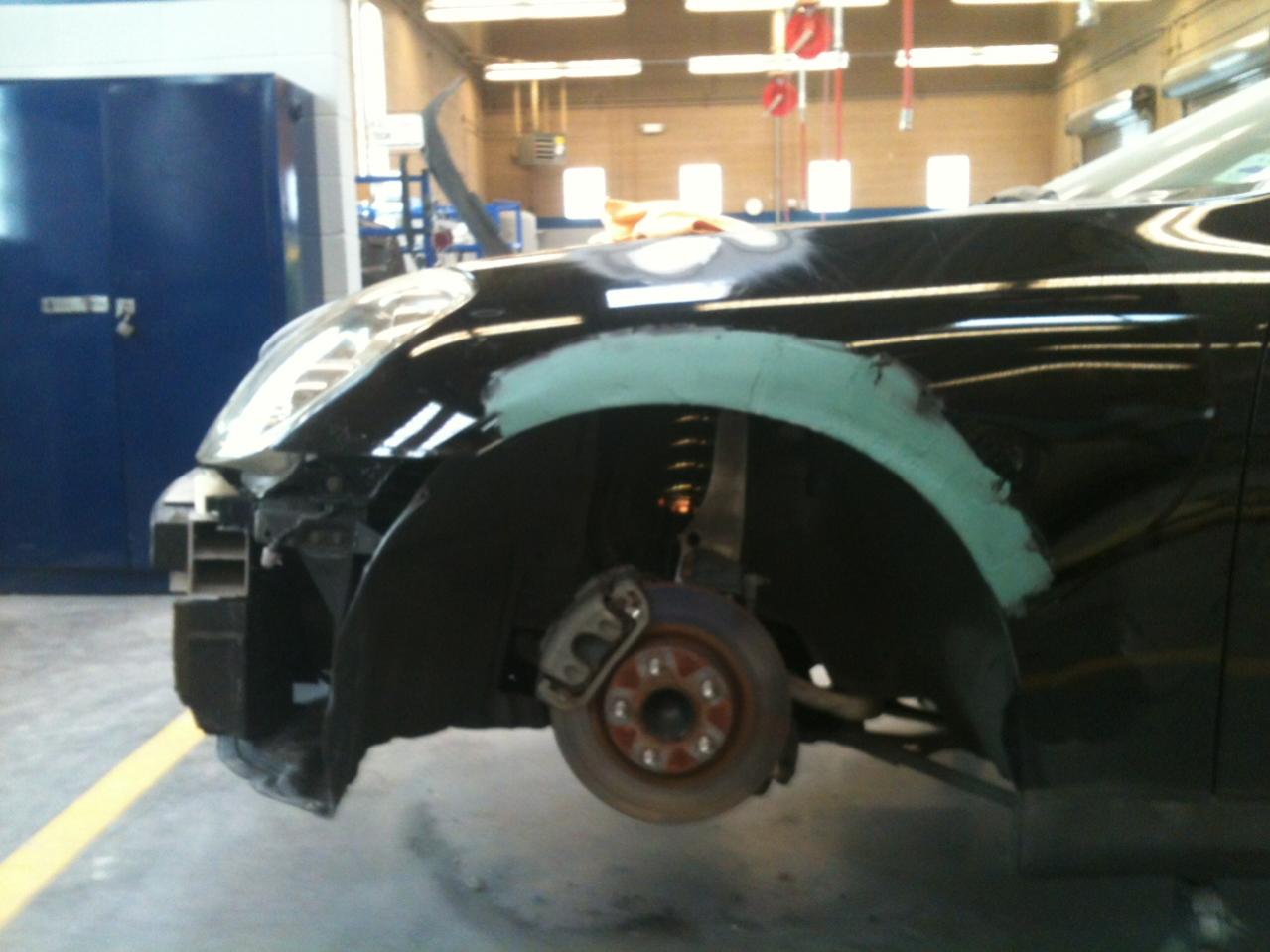

The beginning of the fender pull/flare on the driver side... If you look on the pics above, you can see that the fender was a little bent out of shape... What had happened was that I was tucking tire and backing up on a small slope and the tire caught my fender and pulled it inwards... I just grabbed a fender roller and did what I could at the moment asap...

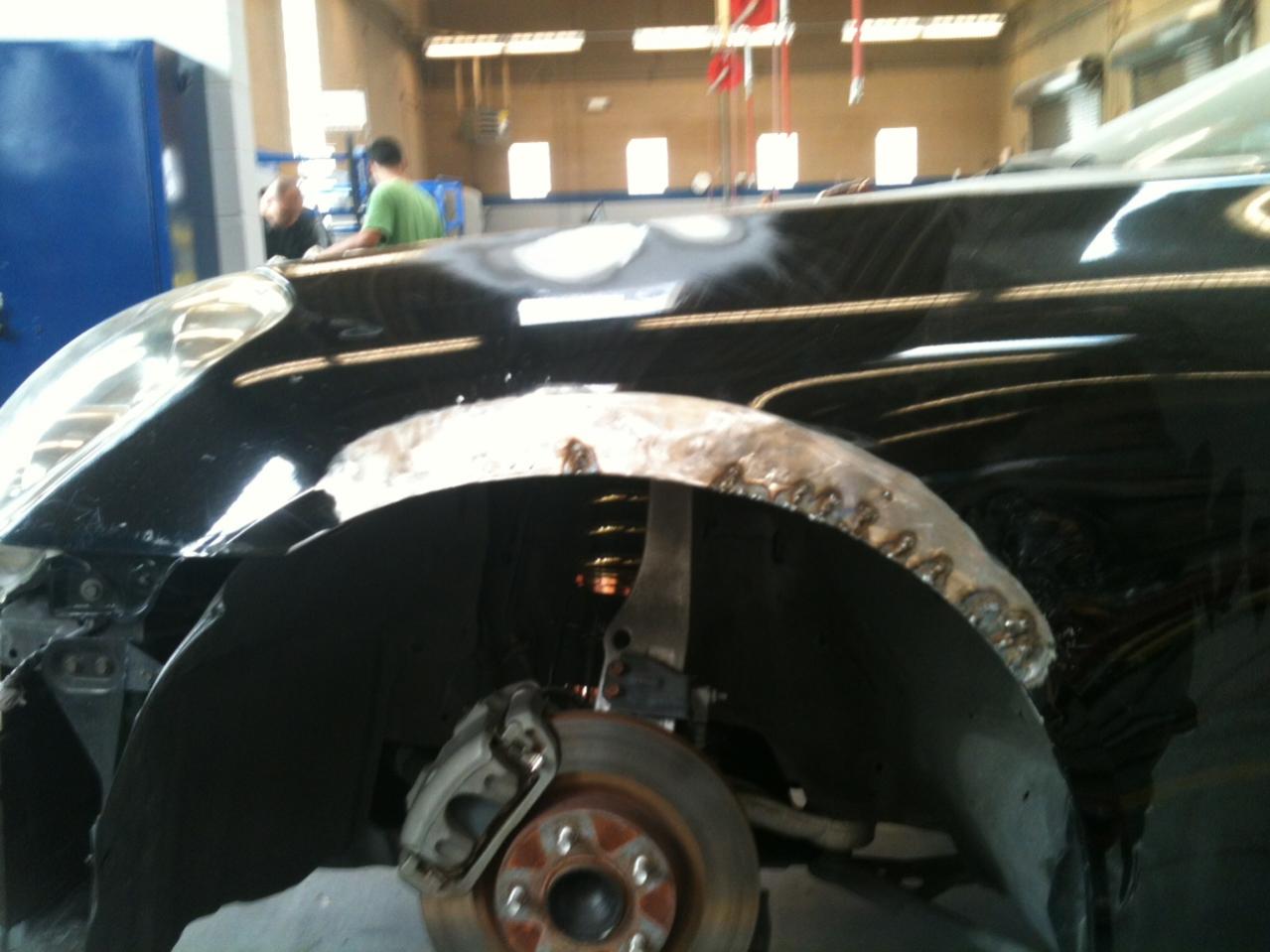

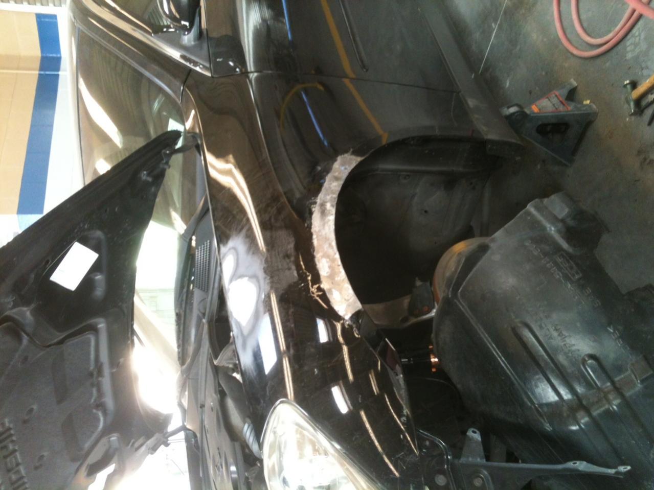

Once again, don't know why this one is rotated either, haha
What I did here was cut into the fender a bit and flare it out a little and weld it back up... Note: I am by no means a good welder, but this will do for now, lol... My welder buddy was out of town so I had to take matters into my own hands!

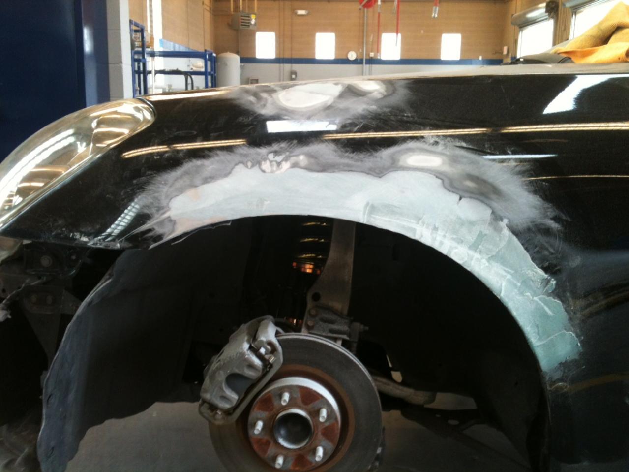

A little Marglass to build up and smooth down! I love this stuff!!!
This is the first sanding with 80 grit, I should have started with 36 grit, but I didn't want to knock too much off as I still need to fill in some low spots on the right side of the fender, and I still need to hammer in some high spots and hammer out some low spots...

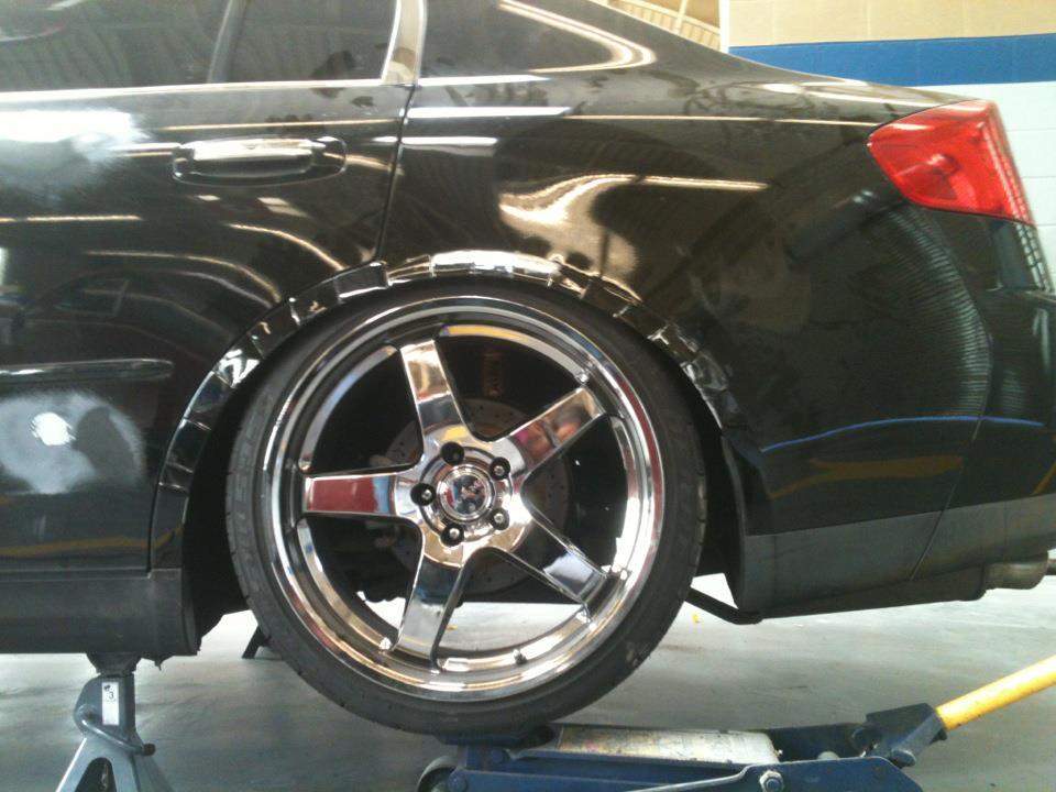

So I've decided to just tackle the rears since I think it will be much faster to finish... I started to flare out the rear driver side, but I haven't welded it yet because I'm still deciding how far out/big I want the flare to be... I will weld it 2moro and will post pics...
The pics kind of suck because of the light that comes into the shop, it's an iphone, I'm not a good photographer, etc...
