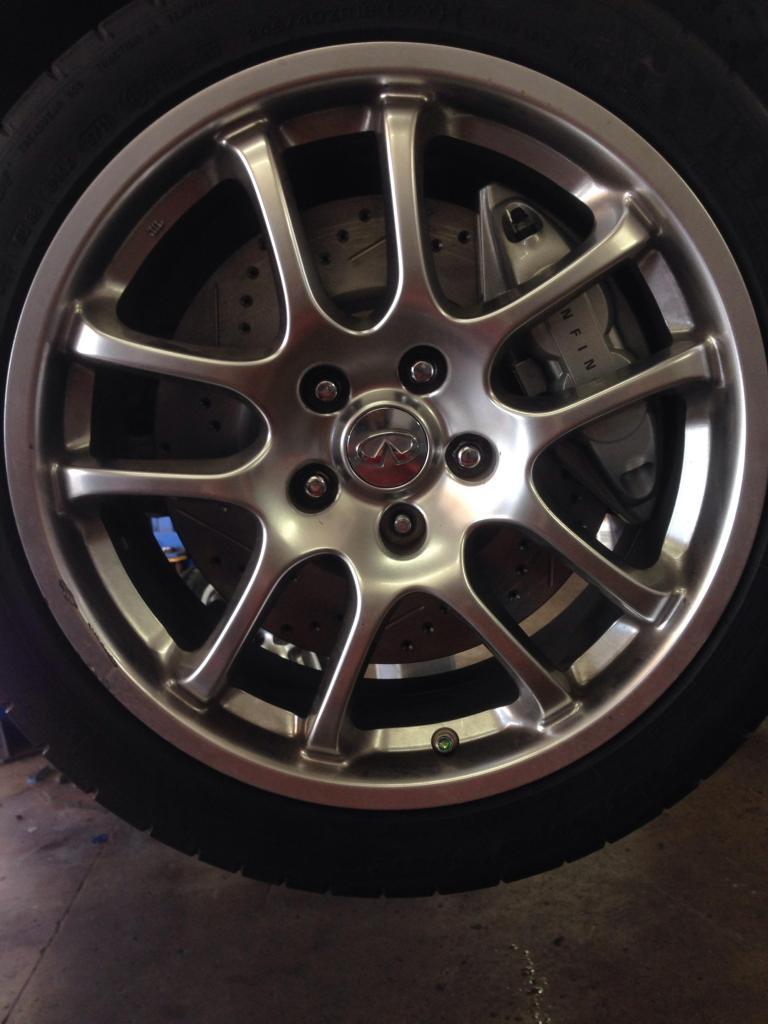

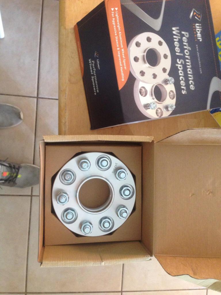

Got my 20mm spacers for the front, still waiting on the rears. Test fitted the wheels as well and they clear with the spacers. Only issue now is I did not realize the g35 and the g37 use different brake line fittings as one is with a bango bolt and the other is a direct connection so I'm waiting on the hybrid brake lines to come in before I can get her on the ground and feel how the brake upgrade performs.

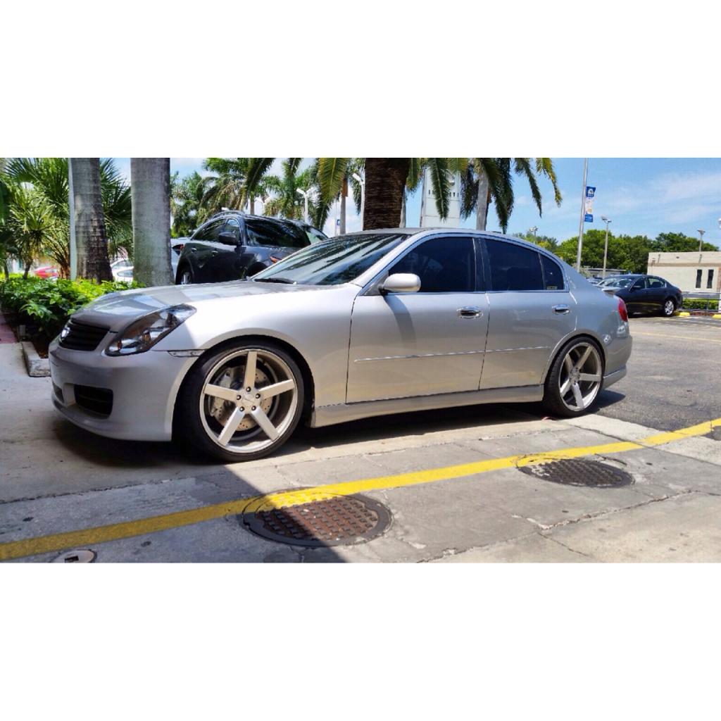

Finally got the front akebonos finished and they look/feel great! Also now running a set of Vossen CV3 20x9 +38 & 20x10 +45 let me know what ya think

lookin good man

I have a set of 20x8.5 and 20x10's. Rennen C10's on my coupe and it looks extremely well.

Akes are also a pain in the ***** to get wheels that clear. as Crispy found out the hard way.
