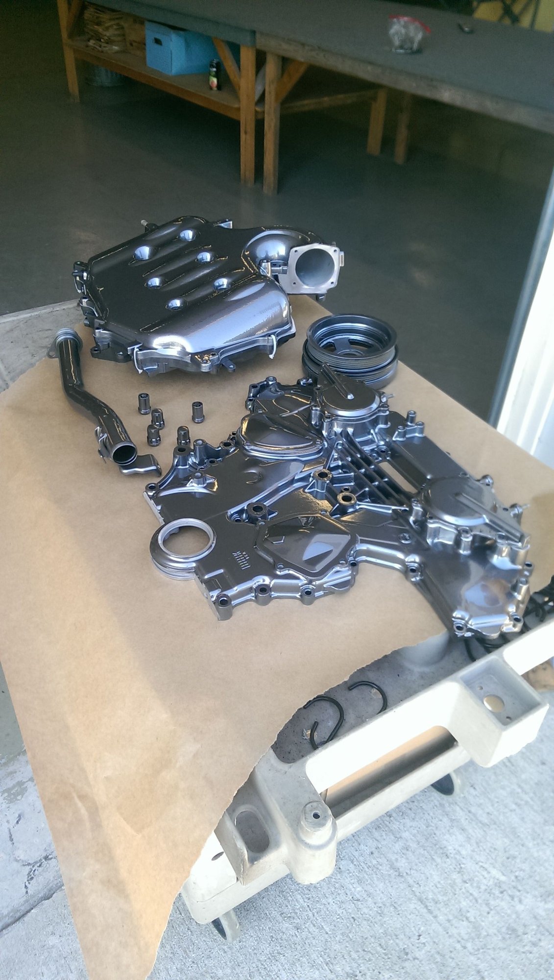

Sending all parts out for powder coating, what a joke of a paint job before. Timing cover and plenum will be color matched to the wheels. Tracked down stainless SHCS's for every bolt on the engine and in the bay.
Sending out battery covers, radiator support, and potentially a new bumper out for professional color matching to the body.

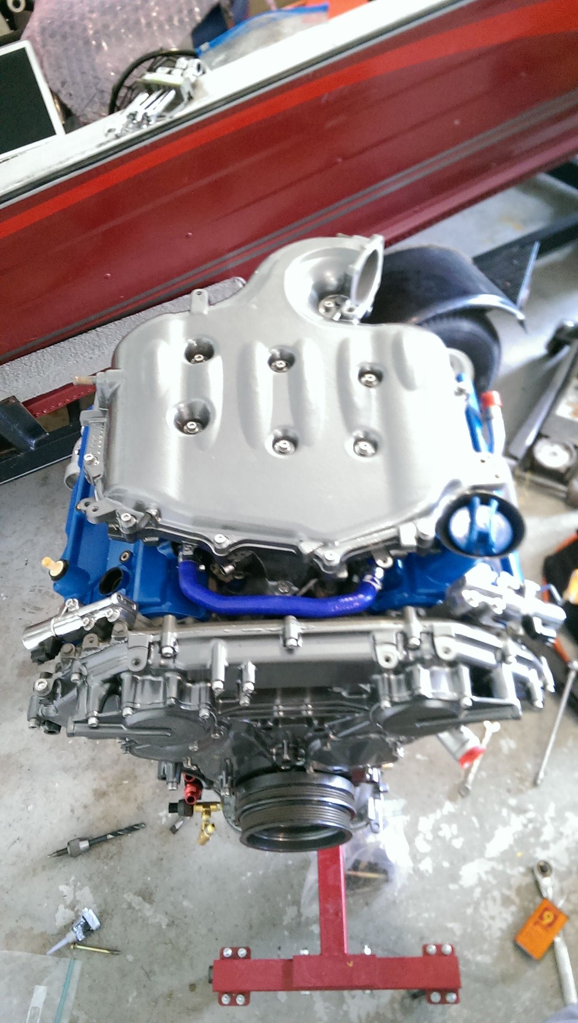

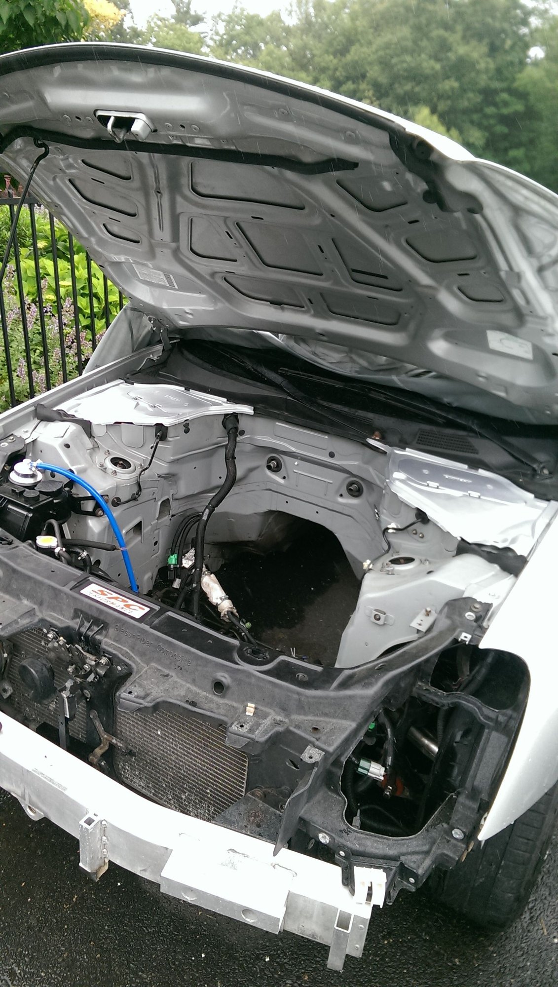

UPDATE: Had a big weekend!
Drifter, I did not have to make a delete plate, I ground down the long part of the collar that holes the cooler on so that it would screw into the engine far enough to make my oil cooler adapter plate seal against the block. See pic. Anybody see an issue with that setup? I want to be sure I don't mess up anything in the oiling system or the coolant system with all of the deletes/mods.
Everything went together well, all that is left in order is:
Repair the radiator I just bought, scum bag lied on my350z. Got some AL-802 to try to braze/solder it up...
Mount up passenger side turbo (manifold is at welder)
Heat wrap everythang
Drop in engine (tranny arrives today, CD009 with 52,000 miles, $650 shipped)
Purchase Front bumper
Fab up some intercooler piping
Purchase EBC/Wideband
Purchase some silicon hoses for the radiator
Purchase GT MAF
Pic of radiator holes to be repaired. Opinions? I got my $ back from the guy, $130 shipped. Just buy a new one?
Almost all of what's left can be done with the engine IN THE CAR woo!! $2k left in parts including base map. Getting there...
Made my rear toe arms adjustable... Pretty cool IMO.
Greddy guys, did you pull the drivers side manifold/turbo to install the engine or is there enough room to have both mounted?
Here's some eye candy. Please post concerns, comments, flames, idc. Anything is appreciated.

Lol right now I'm definitely on the home stretch. I have about $1750 more to spend including a base map. Depending on your schedule, yeah I might win!! It's looking like November is the date for me! I'm dropping the motor/tranny this Sunday after final prep on Saturday. Still not sure if I'll have to remove one of the turbos or the manifolds, hope not.
Regarding the oil cooler collar modification I didn't take off much at all, just enough so that it would squeeze the adapter plate before bottoming out in the block. A bench grinder made quick work of it.
I got pretty serious with the coolant line deletes. If it wasn't the upper/lower radiator hose or the two heater hoses in the back I deleted it and brazed the holes flush. Those are the only lines I have left... Even relocated the passenger side heater hose and coolant bleed valve onto the rear hard pipe.
I kept the ECU, cluster, and brake pedal but yeah I will probably have an issue this weekend with motor mount alignment or something ridiculously unplanned for.... I'm running my AWD motor mounts so they will line up with the front X member but I had to take a sawzaw to them to provide clearance for the turbo kit... Yikes.
I got every bolt in the bay in SS. There is a thread on here that gives all of the bolt dimensions. It wasn't cheap.... But at least it was easy. I have them all bagged up and labeled where they go now which is nice for re-installation. They do not strip easily if you get quality ones, but with cast aluminum it is always eminent. Not sure where I would go for them, I have a hook up at work to order them for a lower price than most...
Thread: https://g35driver.com/forums/engine-...olt-sizes.html
Pic (check out passenger hard line/passenger heater hose relocation)

Getting there
Had an extremely productive weekend...
THE DRIVE SHAFT FIT! First G35X 6 speed swap!!!
Go ahead X drivers. 6 speed swap away. Everything lined up like it should.
Next up is intercooler piping, wiring, and a bunch more little things.
Front bumper (Kurookie) and FMIC are in the mail... FMIC is rated for 850 HP. Should suffice... lol.
Ran into two problems.
1. I can't get the clutch to bleed. I'm going to make a pressure cap this week so I can hook up a few PSI of air. I also have a vaccuum pump but heard that won't work. The system is totally brand new so everything is completely empty. Pumping the pedal does nothing,...
2. the FSM wire colors for the ignition coils did not seem to correlate from what I saw... Could somebody please tell me the colors of 5 out of 6 coil pack wires so I can be positive mine are hooked up right after all of this tucking etc? Thanks!!
Edit: #4 coil should have a gray wire, #6 will have a gray/red wire. Found these two so far.
