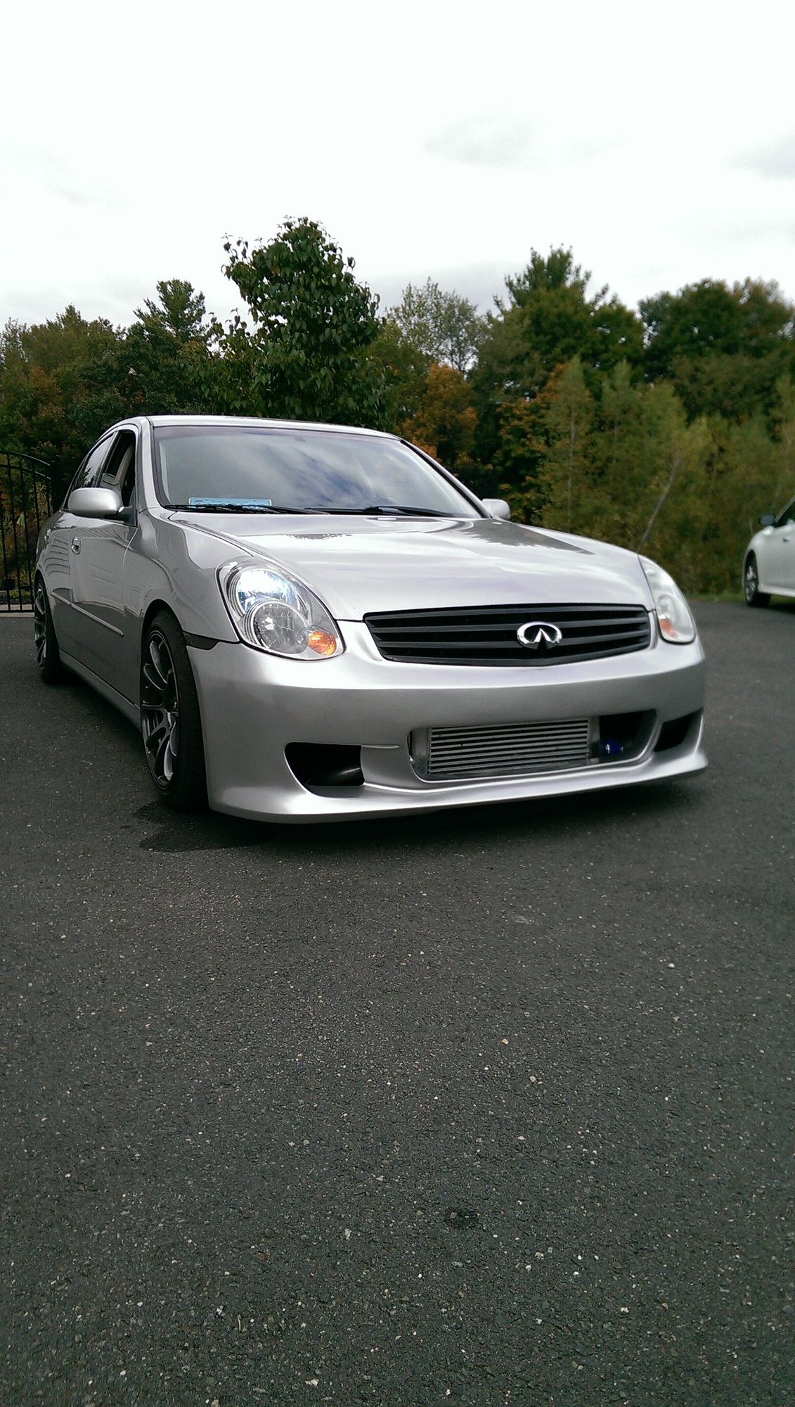

I wish my G was the color of yours. Seriously. I'm thinking blue chrome vinyl soon. Keep the edges tucked so it doesn't look funny with the hood popped.

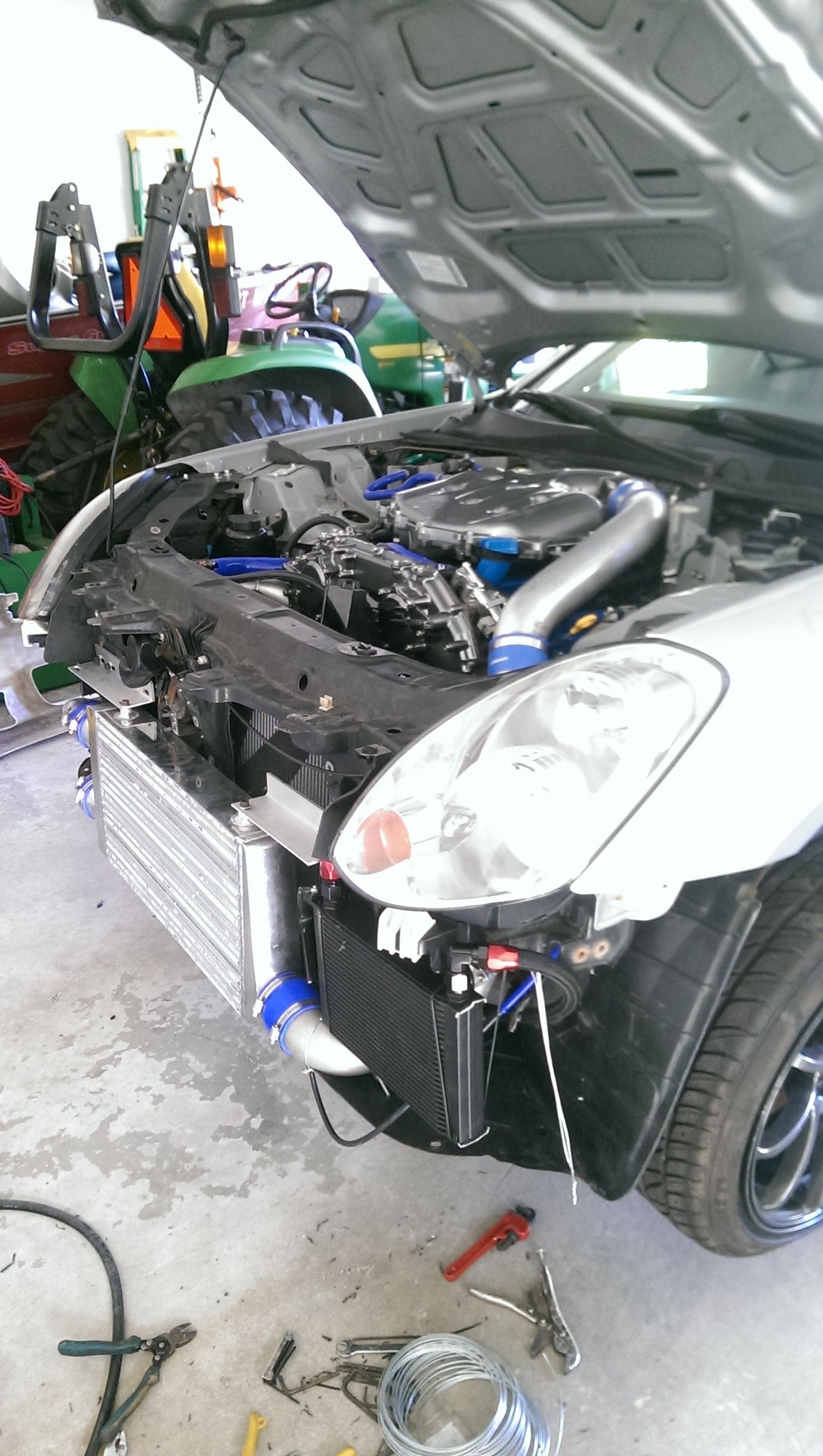

Here is something I'm proud of from last weekend... Lotta wires attach to that bad boy haha. They're all ran, zipped, soldered, done right. No corners cut. Innovative SGC-1 DONE.
I'm lined up to have another huge weekend. I actually made my tentative appointment to tune at RT in PA on the 2nd of October.

Can't beat it but you can add to it! The oil cooler is a nice complimentary piece in the vent on the drivers side.

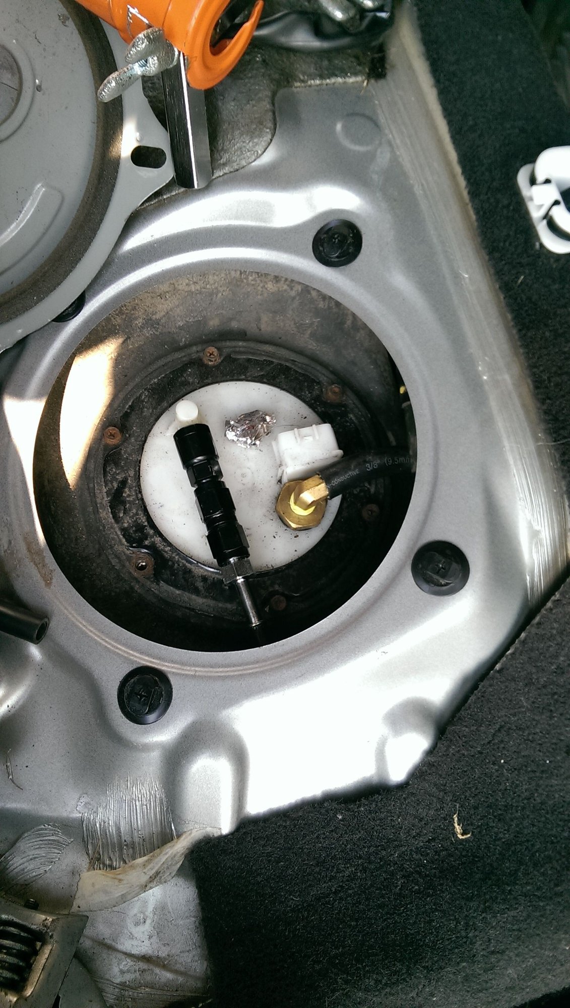

This may be helpful to someone who is running a 350z bucket in their sedan, or wants to.
The nylon fuel line is 5/16. press on AN adapters are available through summit racing.
Here is the link for the 350z bucket to AN fitting.
http://www.summitracing.com/parts/rus-644123
Then all you need is the 5/16 hardline to AN and an AN union fitting.
A jig is required to press the fuel fitting into the hardline, I used a caulk gun modified to fit a brake line flaring tool clamp that grabs the line as you press. You can actually see the tool a bit in this photo.

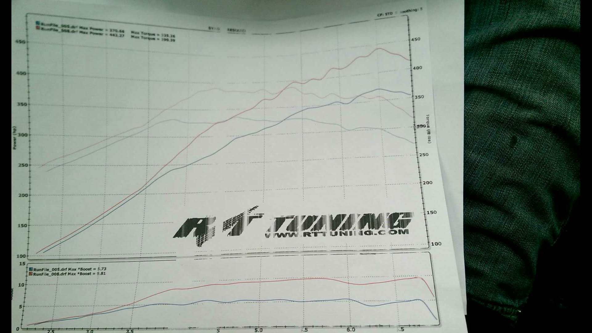

Numbers
Originally Posted by CV35Driver
Sweet Progress Man!
Looks and sounds great!
Thanks! It was sick on the dyno. Nothing but boost.
Update: Had no issues driving to PA or back. It has been raining so I can't use anything lower than 6th gear on pulls. 5th is dangerous...
Final numbers were 443/391~
I have a video I will upload when I get it from my buddy. The guys at RT really know their stuff. I'm definitely going back and would recommend them to anyone. I came in with a few vacuum leaks and left with none, just a great tune. It could have made more power but I have 5 PSI springs in the wategates and Vince said you shouldn't or can't really go over 2x the WG spring pressure with an EBC. With 7 or 8 psi springs this car would make a reliable ish 475whp and 420 ft lbs of torque. Vince is an amazing tuner. He set me up with launch control too. It isn't perfect with uprev but it will help me at the strip. I posted this in another thread but it hasn't been moved yet...will delete when I'm ona CPU. I did get to drive in dry conditions since then. Basically you're on the verge of death the entire time you're floored in 4th gear. Fun! Lol...

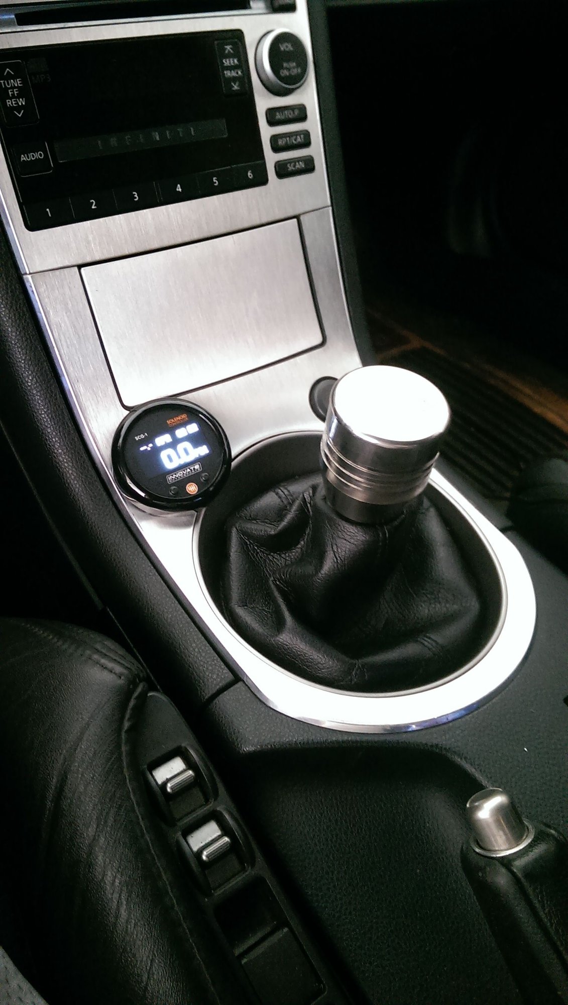

Old Dec 27, 2015 | 12:55 PM
  #71
yosip1115's Avatar
Joined: Jun 2011
Posts: 1,089
Likes: 75
From: CT

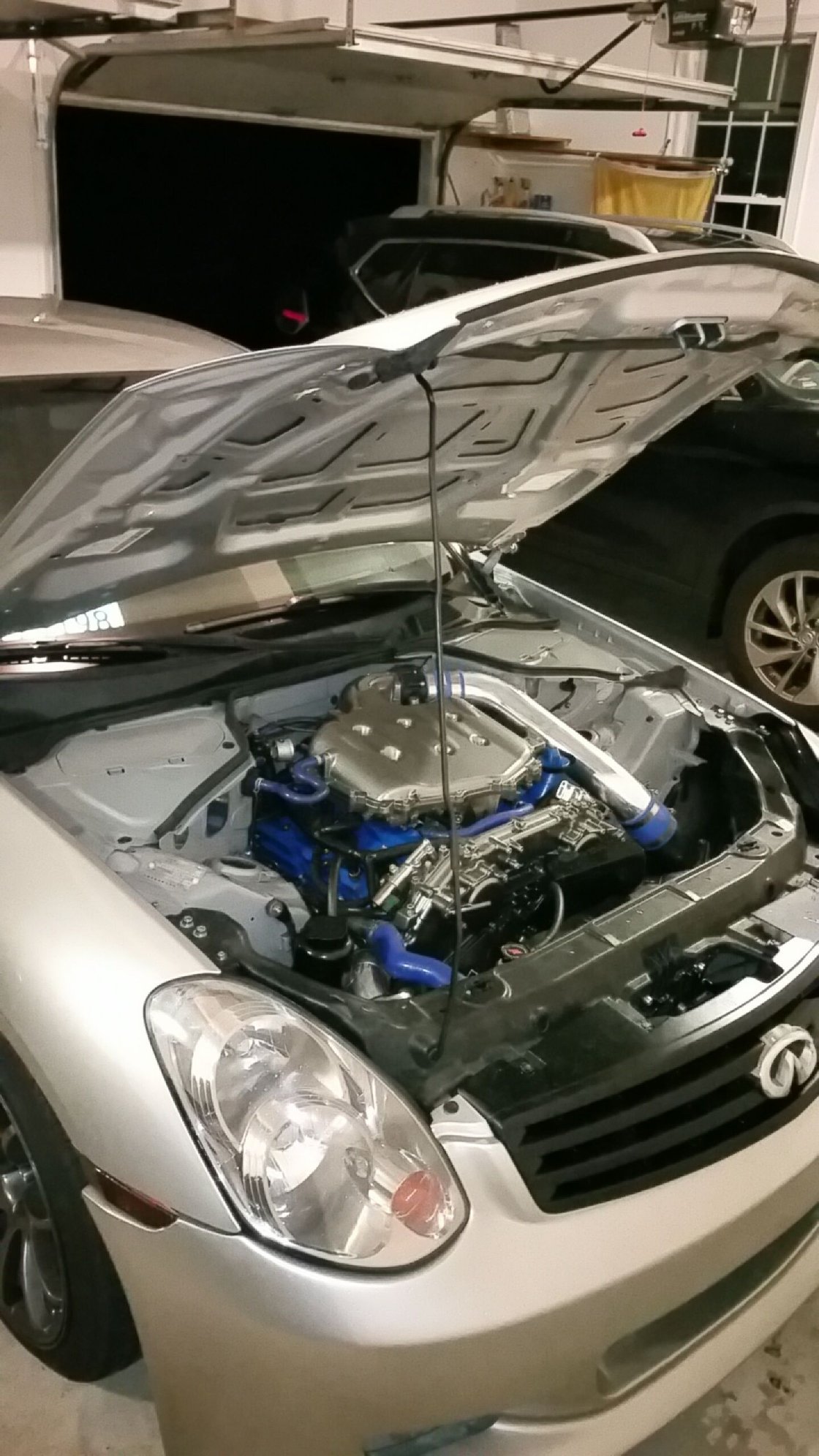

What I've been up to
The engine bay is getting there...
I am going to get a polished PS tank and overflow tank, then after that I will be really close to being done.

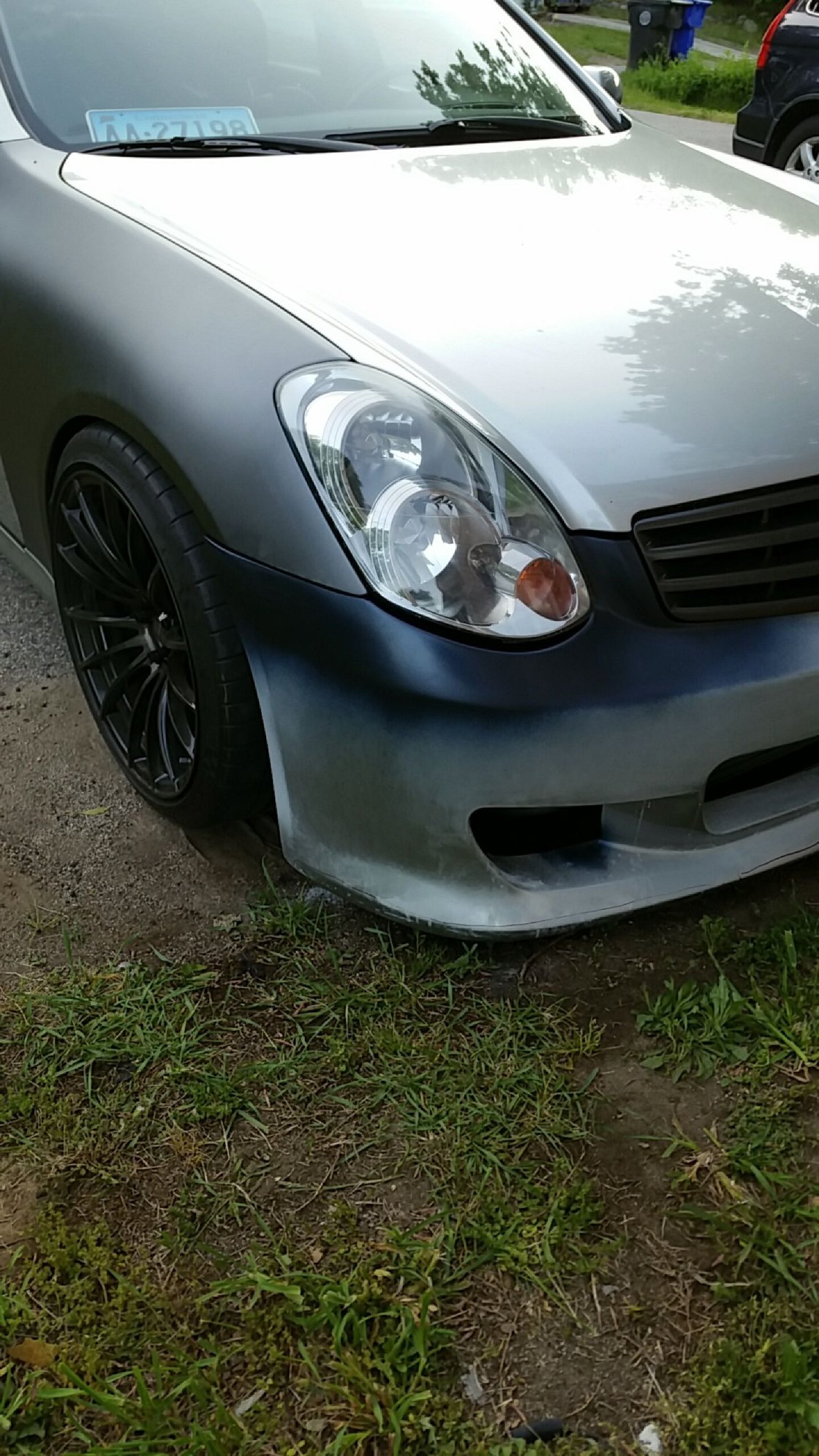

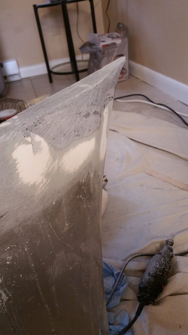

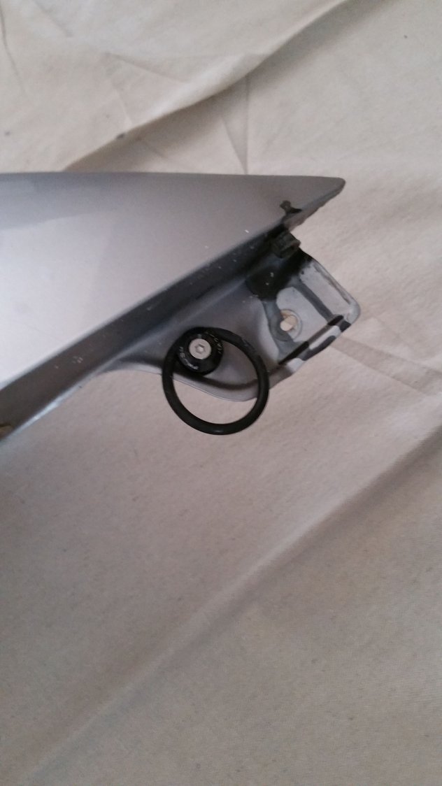

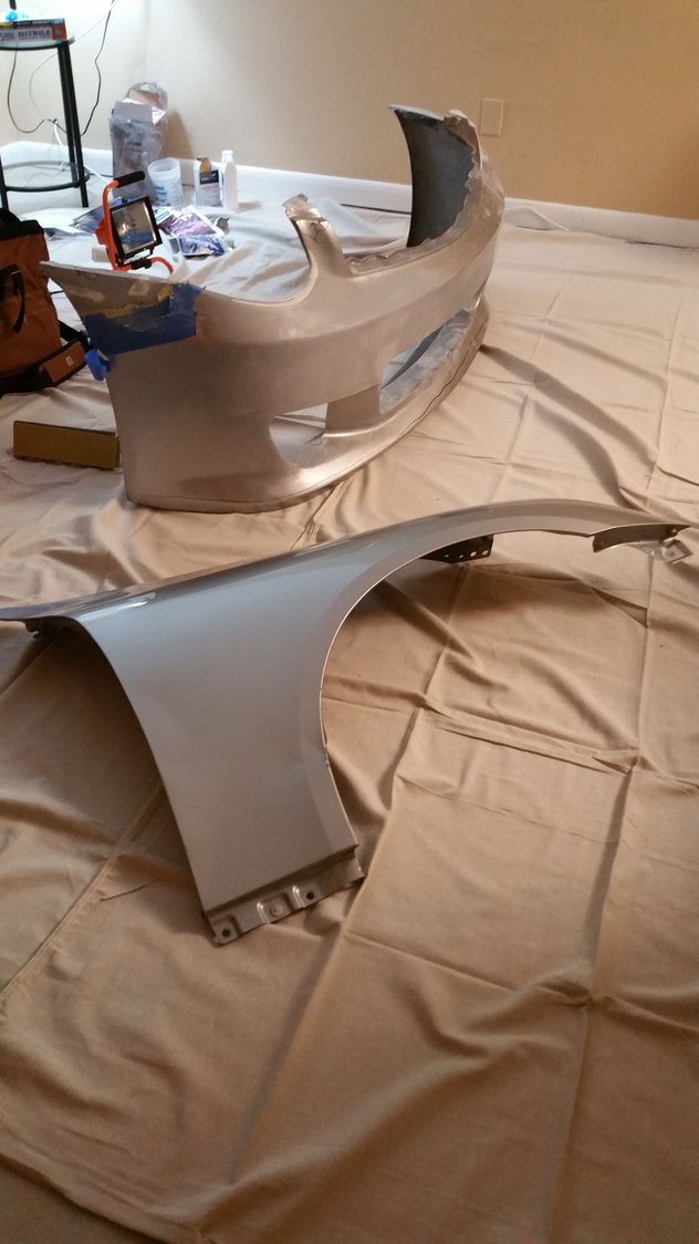

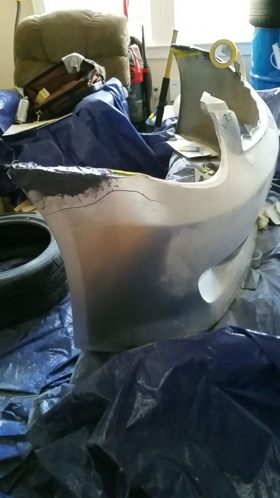

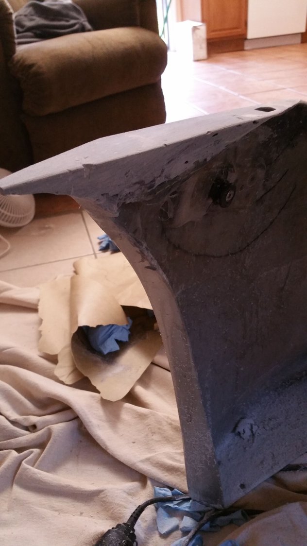

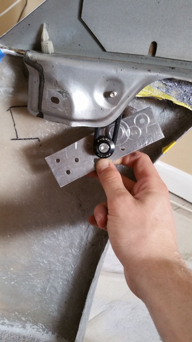

New wheels, interior work, new 14" wilwood BBK, and a lot of fiberglass work has been keeping me busy.
New paint is on the horizon; TV-2 (R34 GTR Blue). I'm doing all of the body work myself to save some money. Rear lip is coming in, Nismo side skirts, oh and some BC coils are on their way, too.
I had to pull the fenders to fit these 275-35-19 Michelin pilot super sports so I'm taking advantage of the situation by shaping them for flush fitment before paint.
Also before sending it off for paint I'm going to shave the bay and have him spray it down. Maybe it'll see a show or two before the end of the summer. I'm more excited to see what kind of time I can run at the drag strip with the turbos.

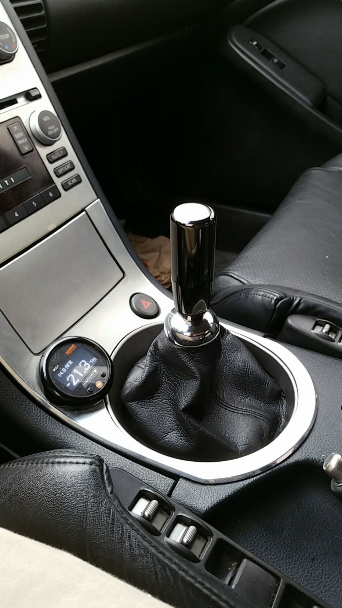

Mishimoto Shift ****
Mishimoto lug nuts on the 19x10.5/9.5 +25mm Wedssport SA-15R's
