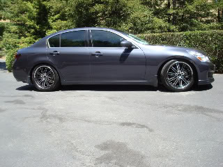

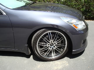

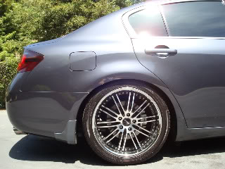

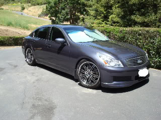

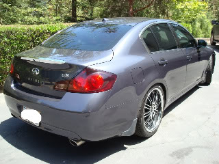

Been a while since I posted pics of my car. Have since added the front lip and BC CO's.
Old Jun 4, 2010 | 04:48 PM
  #868
2GoRNot2G's Avatar
Posts: 2,588
Likes: 24
Looks great, man! Love the wheels!
