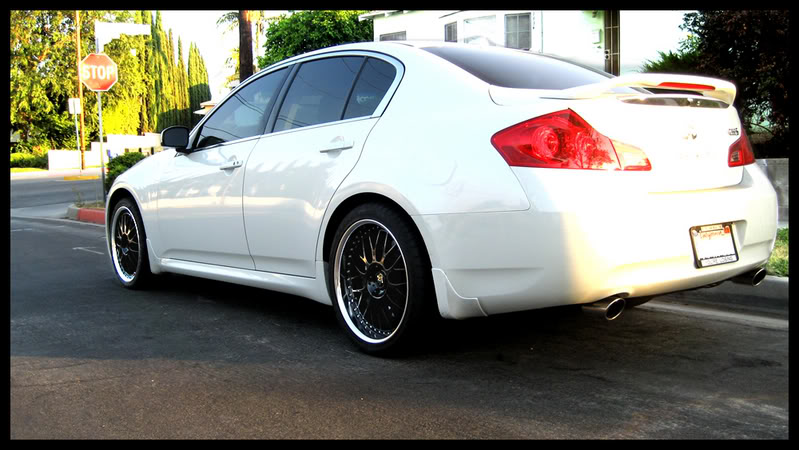

Hers mine before the drop. Hope this helps.
Specs are
Fronts:
19 x 8.5" + 40 245/35/19
Rears:
19 x 9.5 +42 275/35/19
