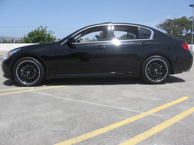

Who says we have to look like monster trucks?! Just get the right size tires to fill in the gap more.
I have 19s and went one size up from the recommended 245/40 and 275/35 combo -- I used 255/40 and 285/35. I caution, however, that it really depends on your offsets. I was scared 255 would be too wide in the front, but since my offsets are not that aggressive I took the chance and it paid off. I also chose to use Toyos because I was told they are generally made thinner (width-wise) than other brands.
Attached Thumbnails G37 coupe rims mounted, *New pics on page 5*-img_2973a.jpg

In all honestly, I don't like the way that looks. It makes the wheels look really small. I'd rather just have the gap.
But people seem to say that you can go with a mild drop and not need any camber kits or anything like that. We'll see what happens.
