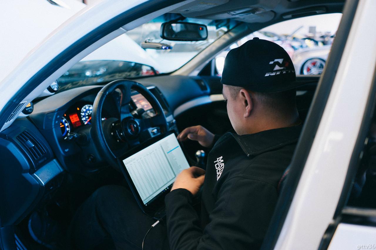

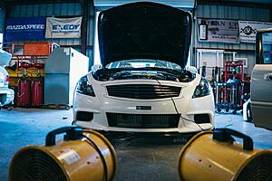

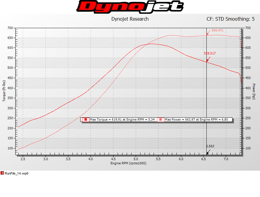

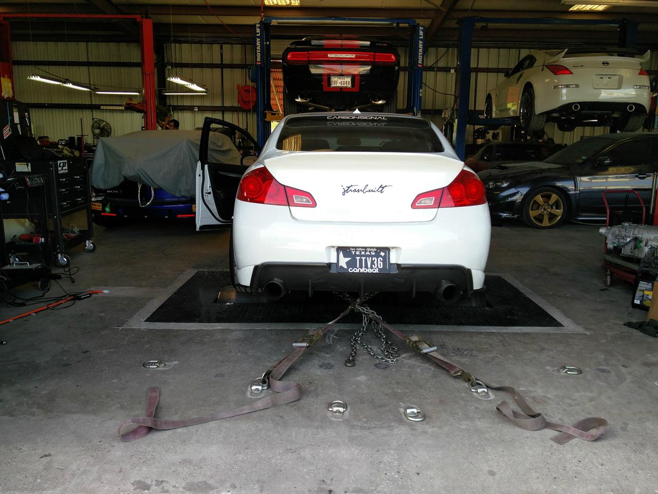

Just got back from tuning. We ended up at 13psi and a tune that Johnny feels is safe. The car didn't make much more whp, but made almost 100 more wtq with the 3psi bump.
It looks like I will have to switch to E85 if I want to go any further. For now I will enjoy the car and wait for CJM's HR rails so I can upgrade the fuel system even more.

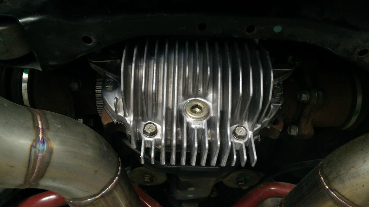

I was testing my new differential at the shop earlier.

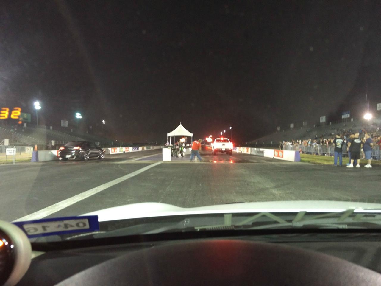

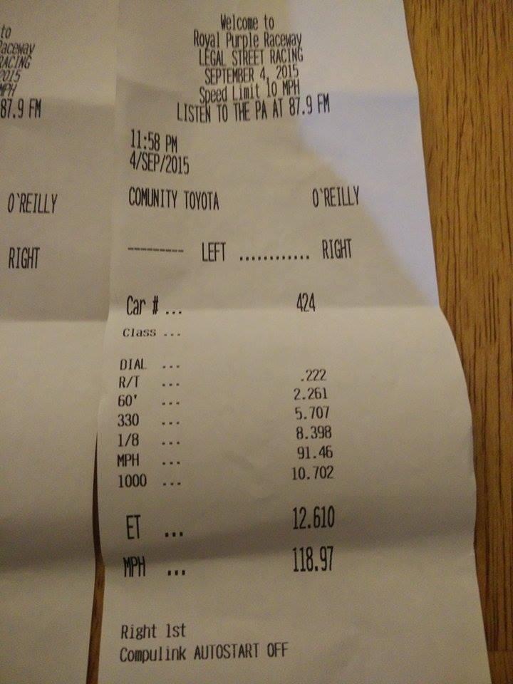

My first time ever to the drag strip tonight. My best time for the night was:
I think that run was 12.7, I need to learn how to launch better without spinning first and second. I'm sure better tires and/or drag radials would help.
Inside my very first run. I didn't even know where to line up hah
Here is another video from the inside where I got toasted by a bad **** truck on drag radials. He ran a 12.5 and I ran a 12.6. To add insult to injury my passenger got kicked out! Hopefully I can learn how to launch the car properly at the strip.

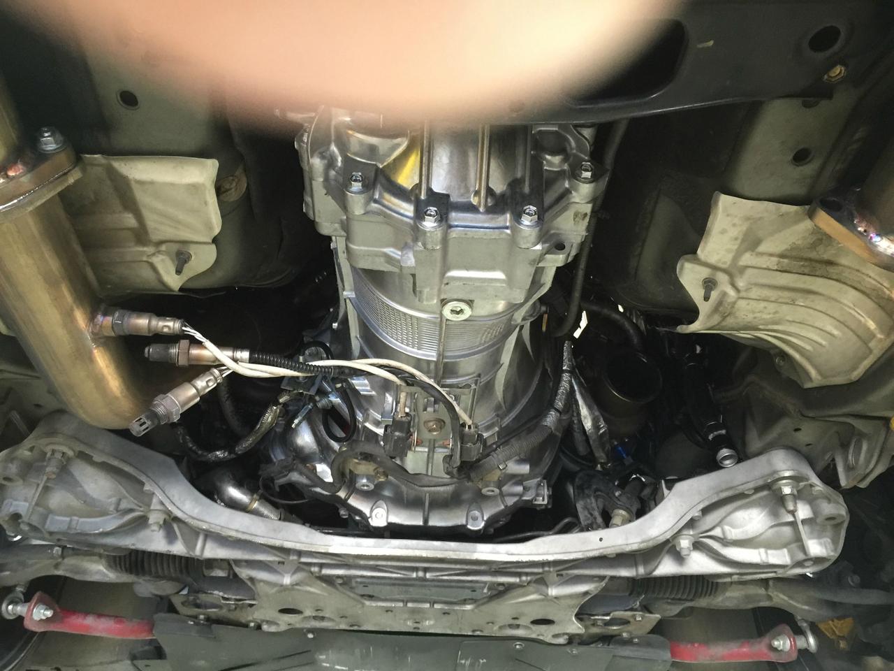

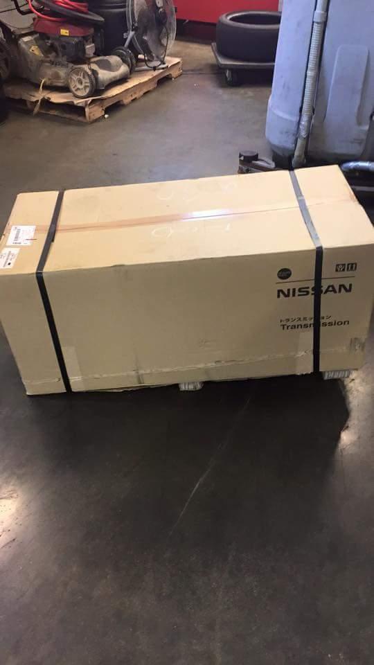

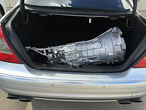

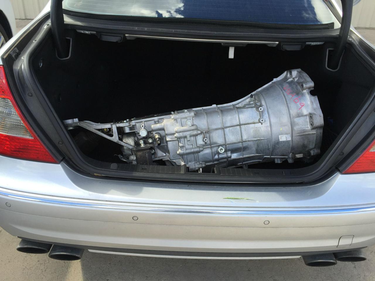

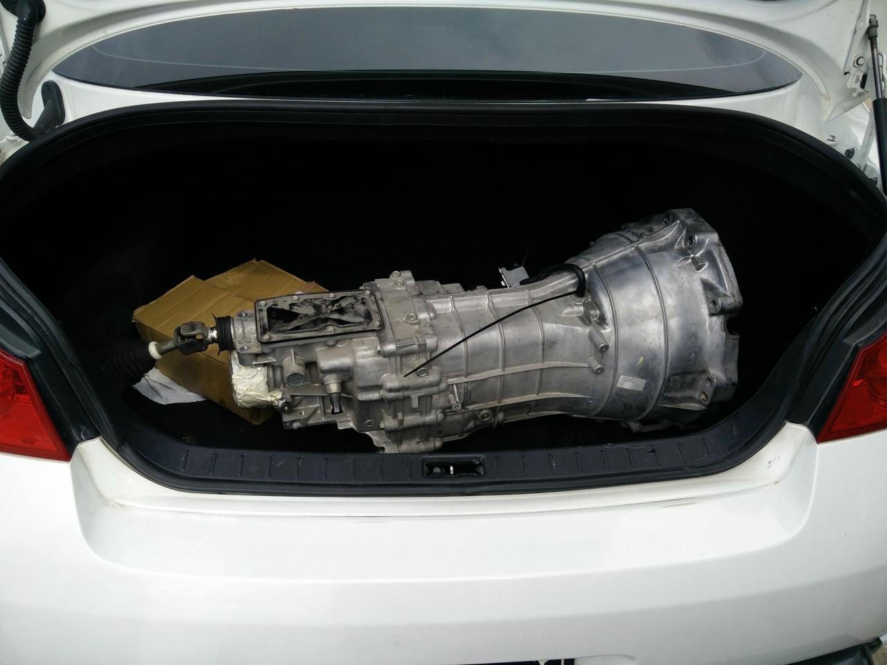

One thing I forgot to mention in the most recent posts is that the used transmission I got from the salvage yard, which was put in with my new clutch, actually grind 5th gear as well!
I was told it had 'only 40k miles' - another testament to the 'do it right the first time' lesson that all us modders constantly struggle with.. Luckily the salvage yard would take the transmission back, however the time and money spent on installation and removal is lost..
I used a bit of my time delivering transmissions here and there to ensure things kept moving along smoothly.
My original 99k mile transmission was delivered as a core:
Then the used transmission was returned to the salvage yard:
And finally the expensive 'do it right the first time' lesson that I consistently struggle with (major props to David for hooking it up!) :
Pretty much a brand new car now:

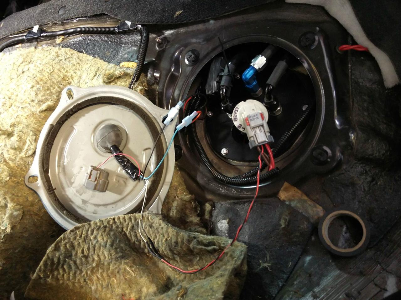

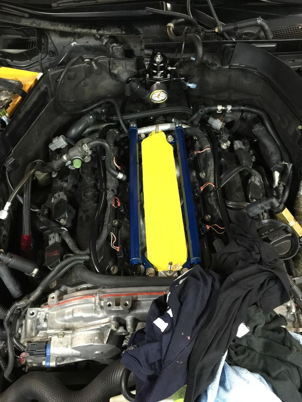

Since I didnt 'need' my car back right away I decided to finally go ahead with the install of my CJ Motorsports Stage 3 RFS.

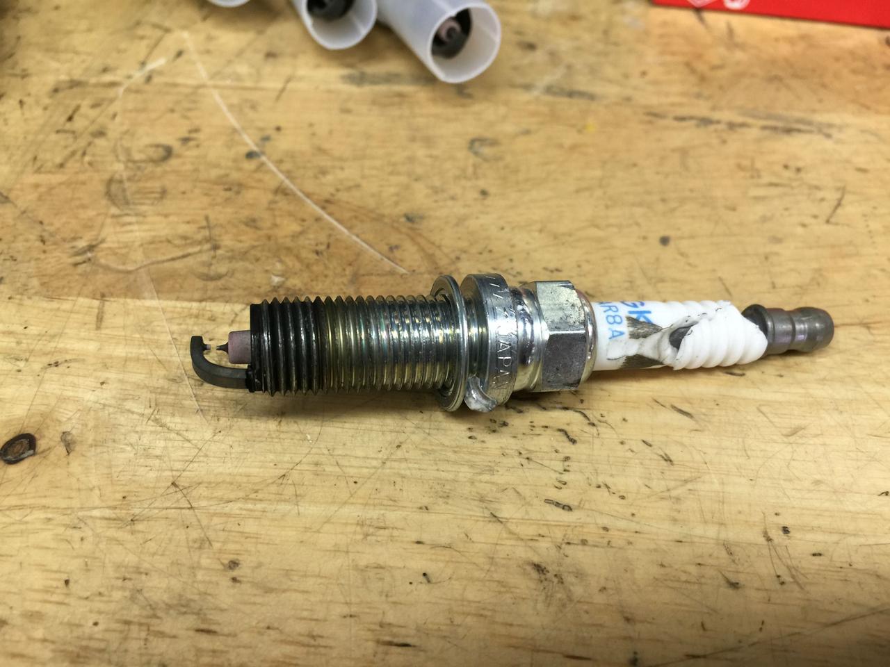

Turned out this was one of the best decisions I have made, because when we pulled the plugs one of them looked like this:

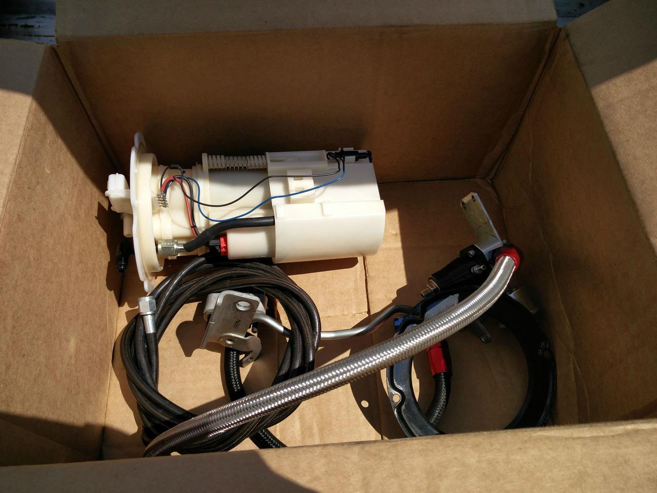

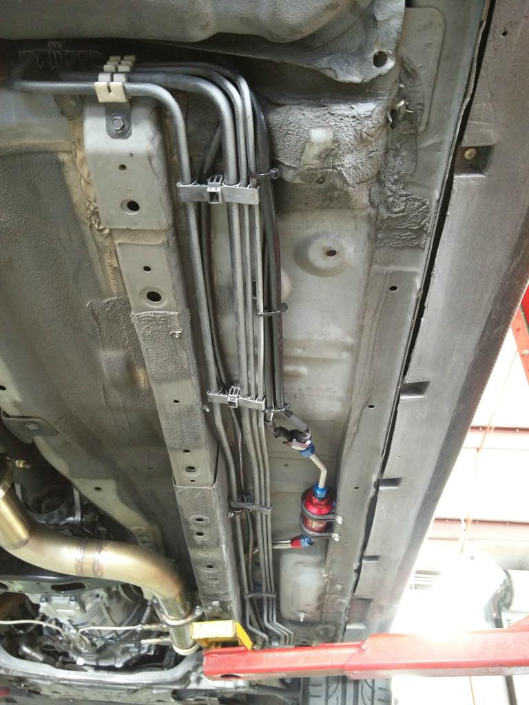

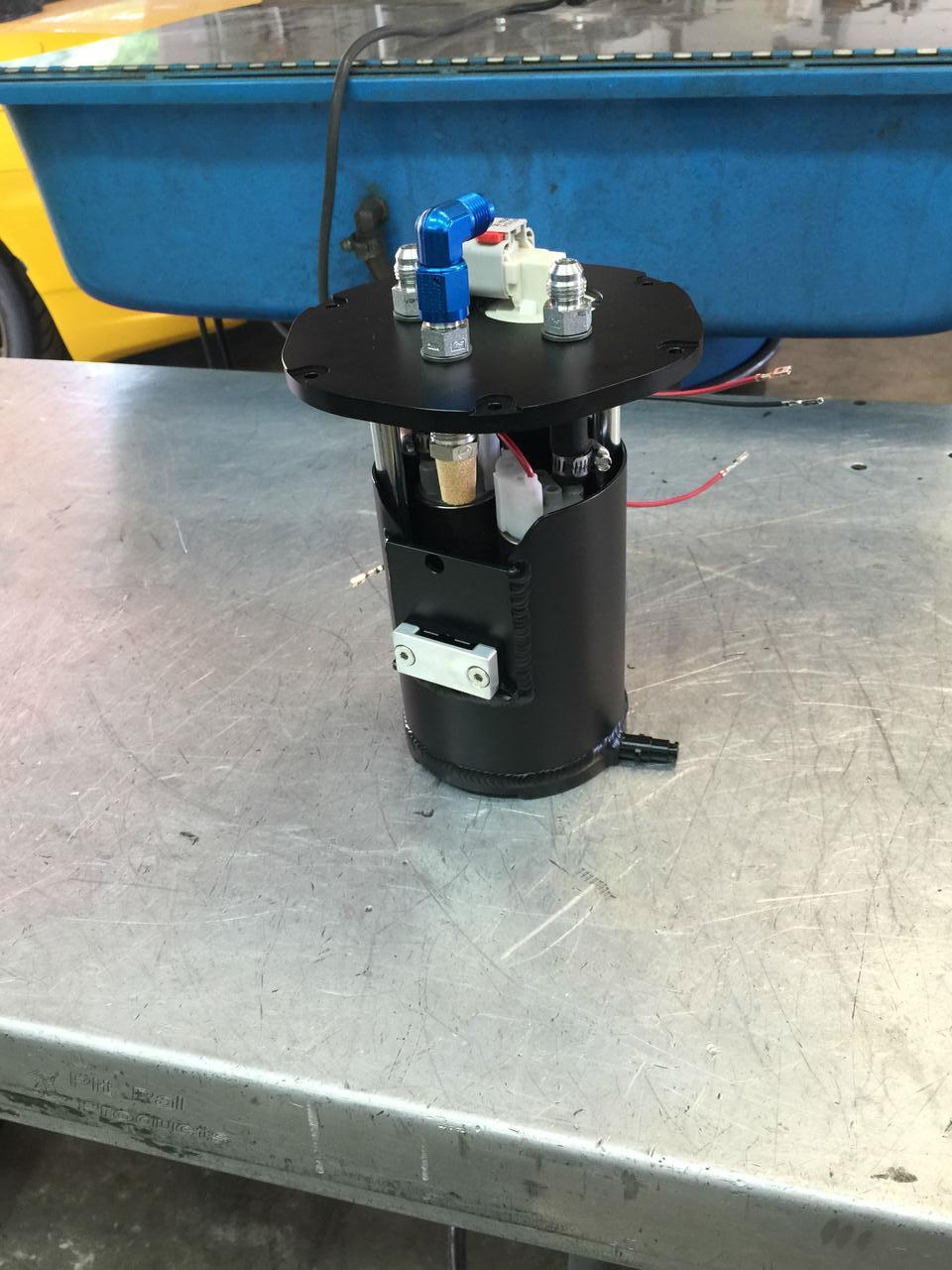

I was waiting to install the upgraded fuel system before I switched to E85 and this sign was also added to the list of reasons.

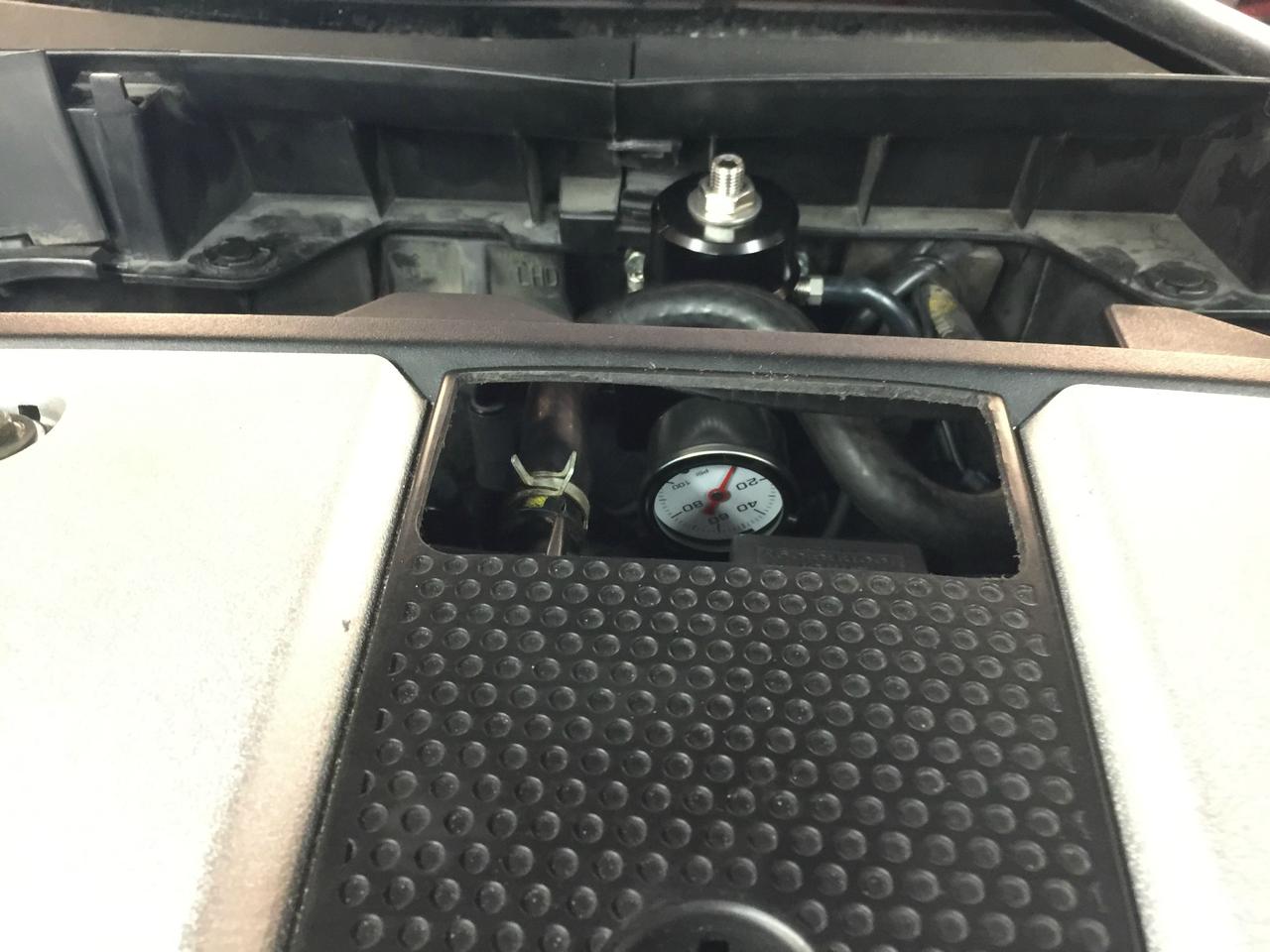

I always wanted a peep hole in my cover:

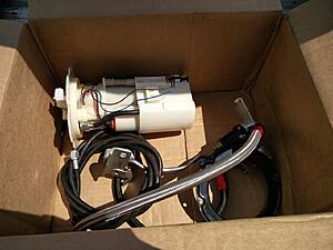

The beautiful CJM in tank twin fuel pump module:
Only to be not seen:
Ron ended up modifying some of the design and not using most of the hard pipe, but overall it came out quite clean:

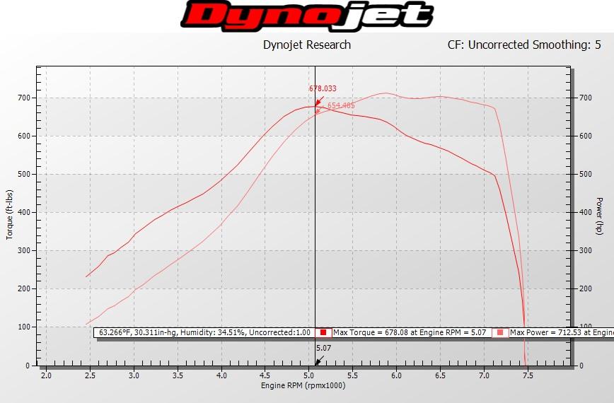

That leads up to the last video where the car was filled with E85 and put on the dyno:

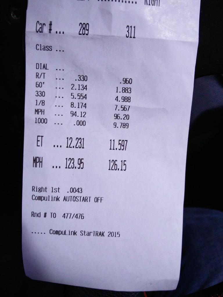

I got owned by a fast evo:
I am 289 on the left:

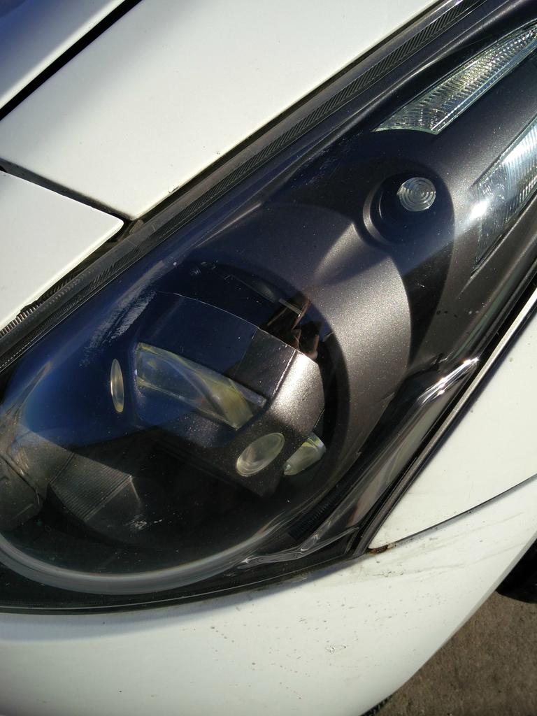

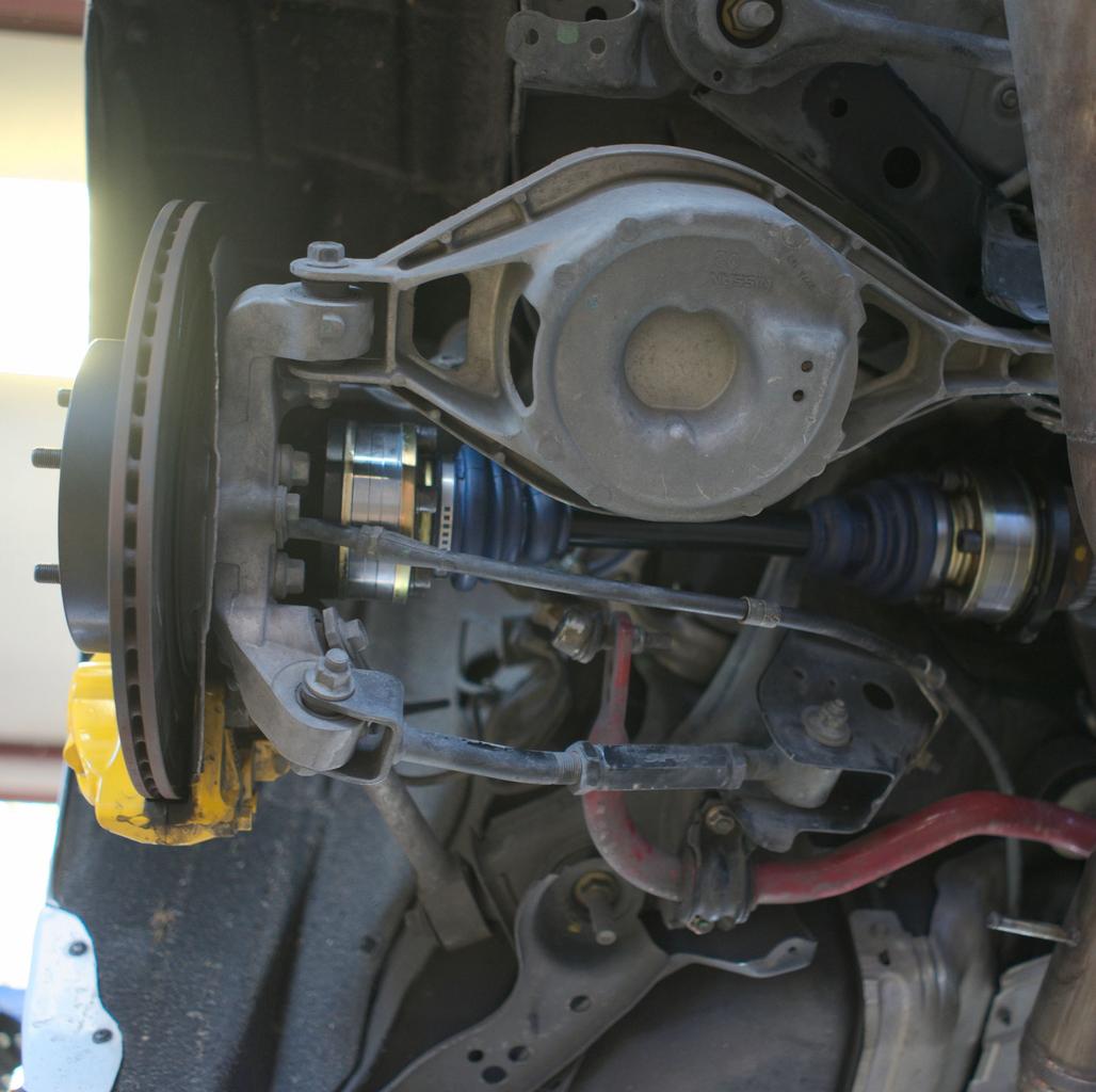

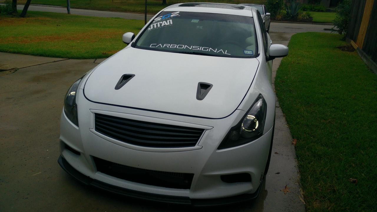

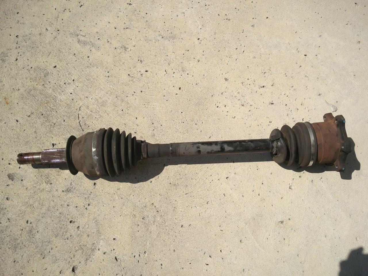

As mentioned above I broke an axle at the track 3 weeks or so ago. The day after I noticed that the axle wasn't the only thing that broke. I guess QuikSteel just wasn't enough to hold the shroud in place:
Took things apart and epoxied the shroud back in place after rebaking the headlight again:
Then replaced the axle since the car was on stands:

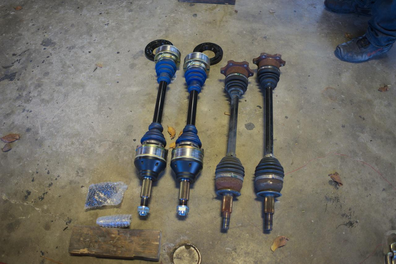

Nothing has really changed as I'm still waiting on the DSS axles to be made. They are supposed to ship soon, but with Thanksgiving next week I'm not holding my breath.
I was waiting to install the upgraded fuel system before I switched to E85 and this sign was also added to the list of reasons.I always wanted a peep hole in my cover:

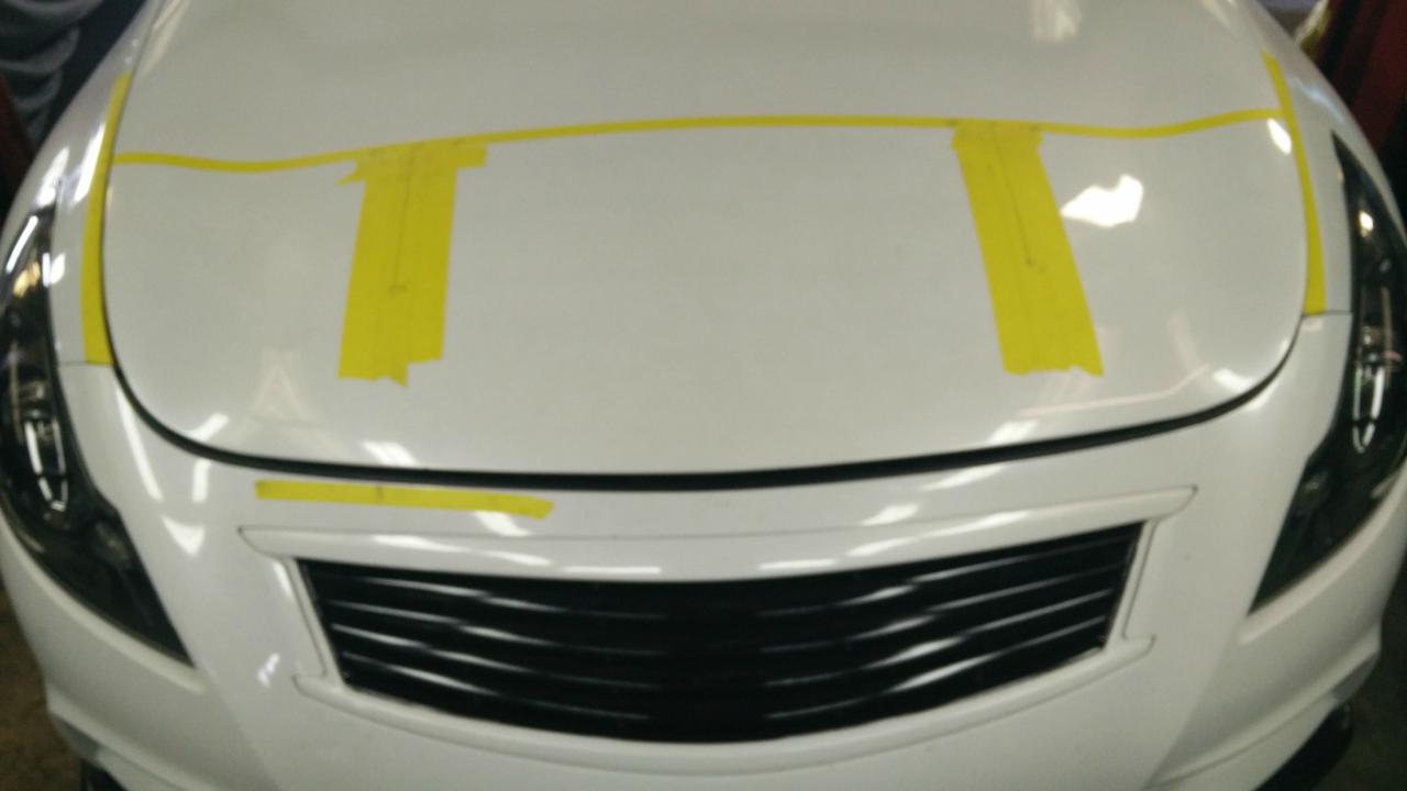

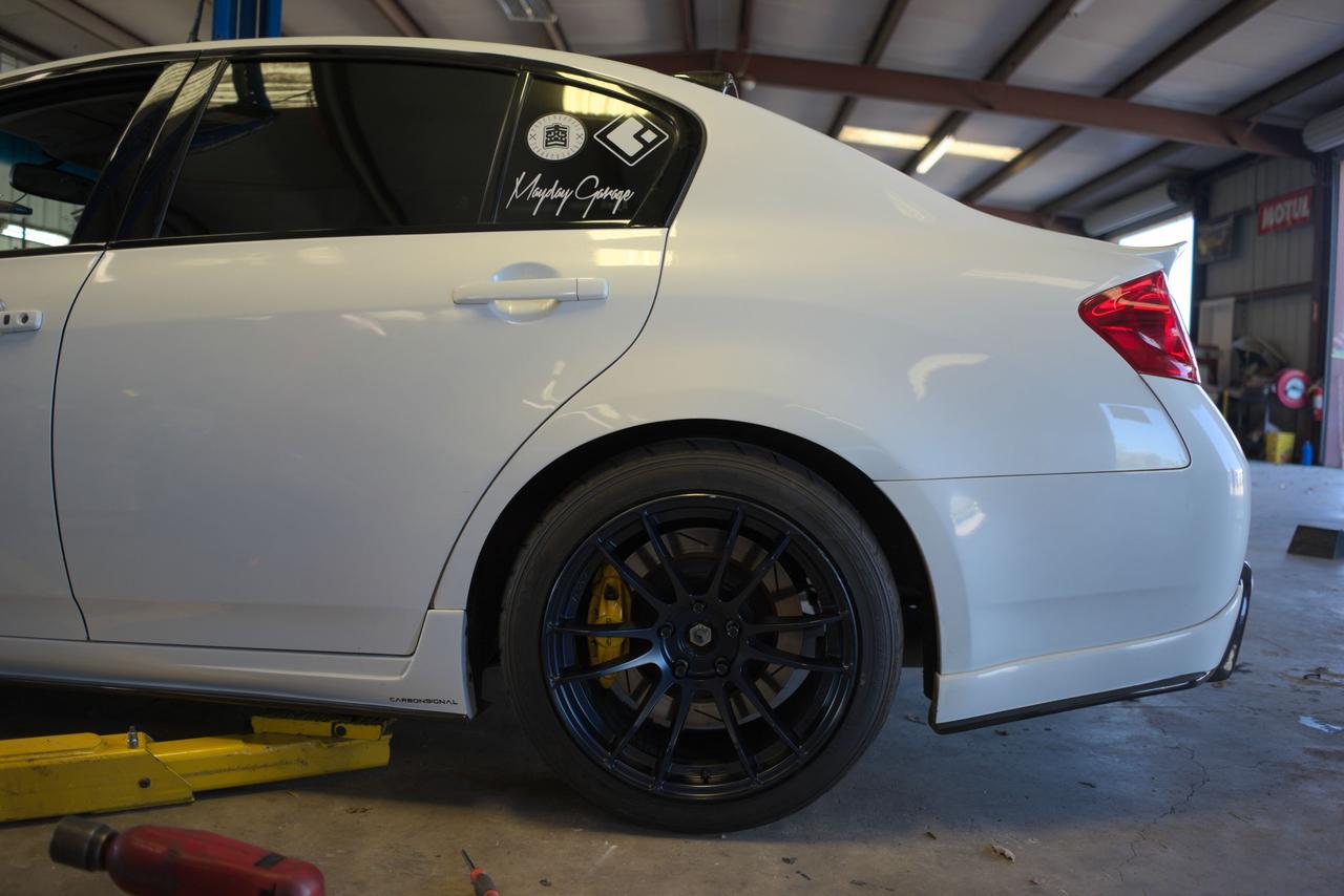

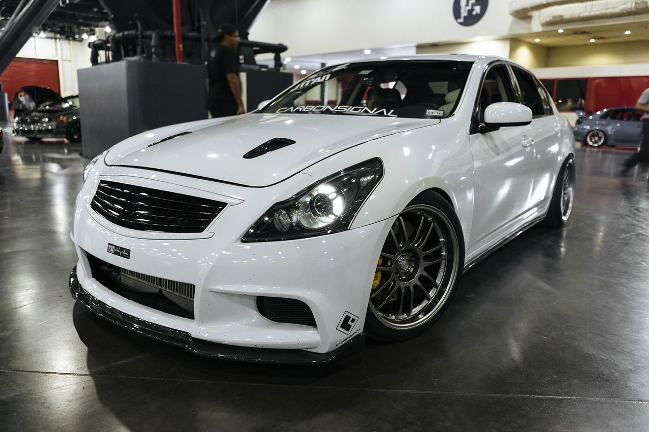

This past weekend was Wekfest so I went to support Houston's Mayday Garage who hosted the premeet:
Then showed during Wekfest:
Took home this little guy:
Truly am humbled that the vision is appreciated since the car isn't slammed/stanced like many of the other cars that were showing. Probably will be my last car show for awhile as 2016 is when I hope to really beat the **** out of the car on the track.

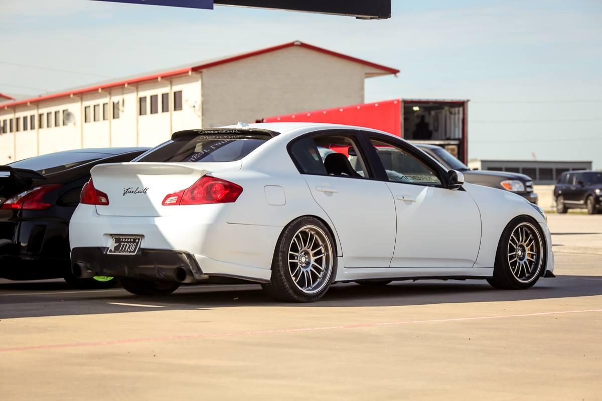

Weather was nice today - Sunny with a High of 62 degrees - so I took the car up to Jtran Motorsports and got the final E85 tune. I say final because the Borgwarner EFR6758 turbos will not make anymore than 21 PSI with the medium actuators that come with the AAM TT kit. Because of this we are basically out of boost control and have also ran out of room on the ID1000s.
So that means my power mods are pretty much done. Now the mods to put the power down and handle it will commence in 2016 while I track test and tune!
Big props to the Jtran Motorsports family!

My axles finally came and went in at Jtran last week:

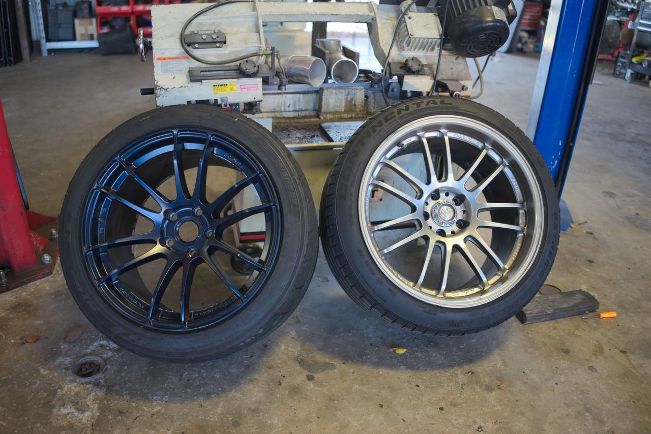

I got a pair of Gramlight 57xtreme 18x10.5 +40 rear wheels a few weeks ago for a steal and mounted 295/35/18 Nitto NT05s on them as these will be for my track/drag days:
I'm going to need to get a matching pair for the front now, but for my immediate quarter mile goals just the rear should be fine.
