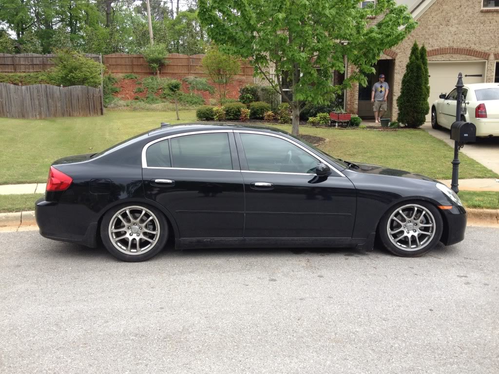

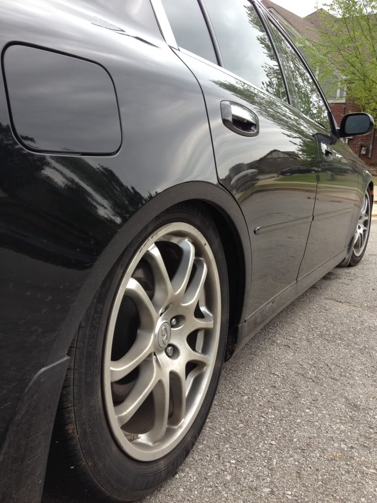

Coilovers are on. Time for a fender roll and some wheels!
Wheels were already curbed by the previous owner, by the way haha.

Sigh, another one goes the way of show instead of go. You might as well have gotten an automatic.
The "gap" exists for a reason. Because of our suspension geometry the tire doesn't camber that much on bump, so it needs some sort of vertical clearance. If you go for the hellaflush look and push out your wheels, your going to lose the little bump travel you have left.
If you intend to run your car that low, I would suggest you at least get some roll center adjusters.

If I wanted a race car, I definitely wouldn't be driving a luxury sedan. Obviously I'm leaning more toward show than go, it's a 4 door boat with leather interior and heated seats.
