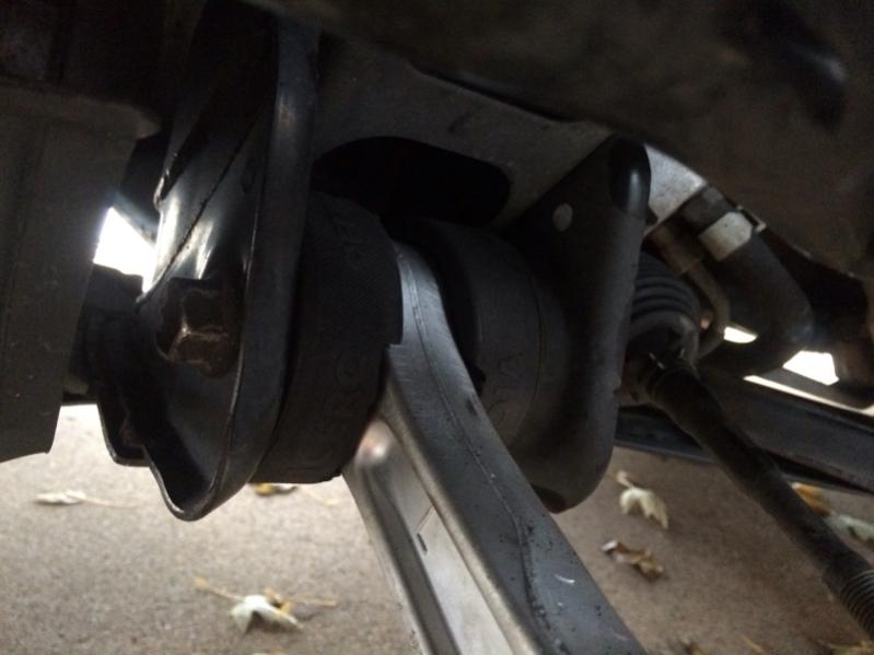

I did my compression rods last weekend and my lower control arms today! I'm sick of redoing these every year and a half, so I added hockey pucks to my lower control arm bushings...saw a guy that did it in a nico forum, looked like a good idea. I drilled a 1 inch hole in the puck just off center with a spade bit on a drill press. Then trace out the control arm with a pencil and carefully chisel out a 1/4 inch from the hockey puck until it is flush with the edge of the oem bushing when put on. It slips on right over the oem bushing, and adds a nice bit of stiffness where our suspension needs it the most!
Attached Thumbnails New member/suspension issues-image-3144854449.jpg
