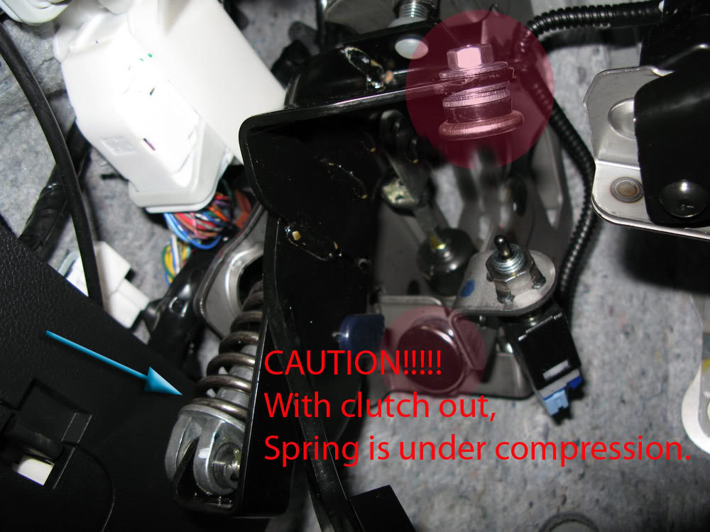

For your cruise control check the switch on top of the clutch by the dash to make sure it is making contact. If not you can adjust it and see if that fixes your issue with cruise control. Your window motor could be going out which is a common issue with G35 / 350z. I would either clean it and be ready to clean it again or just replace it with a unit that has lifetime warranty on it. Try regular conventional oil 10w30 and see if that slows down your oil consumption.

Thanks Faiz. The pictures are a great help. Strangely though, the CC didn't work at all once I got back to Nashville for the first week. And then all of a sudden it's working perfectly. I did notice a change in the clutch pedal feel when leaving and returning to the very top. It had an unnatural feel. A kind of pop when I first pressed the pedal down and then a snap at the very top when releasing. I suspect something may have lodged in there somewhere and is now dislodged. Now the travel is smooth as silk.

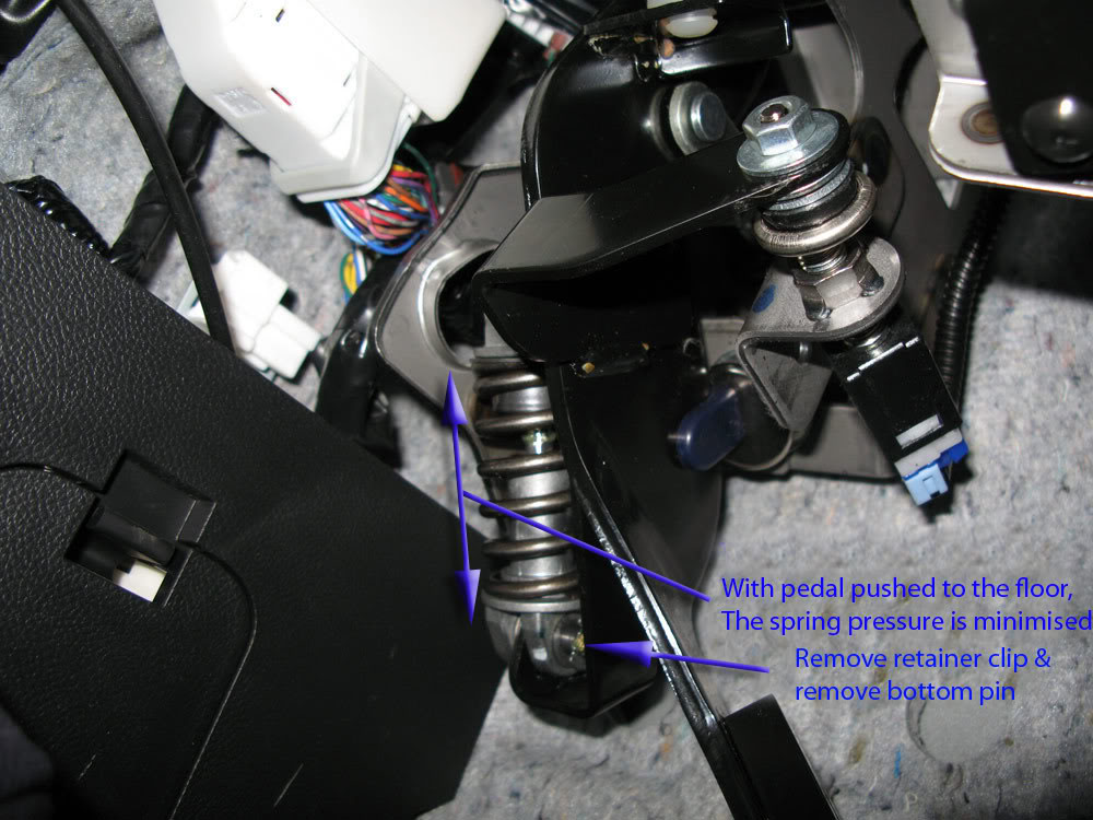

I would change out your clutch fluid and while you are under the dash looking at the cruise control. Maybe do the clutch mod where you remove the clutch delay spring. You will really enjoy the vehicle and the clutch which will be much more predictable than stock. Go a step further and pickup the RJM clutch pedal.
https://g35driver.com/forums/v36-diy...t-feeling.html
https://g35driver.com/forums/drivetr...g-removal.html
http://www.rjmperformance.com/350z--...edal-kits.html
