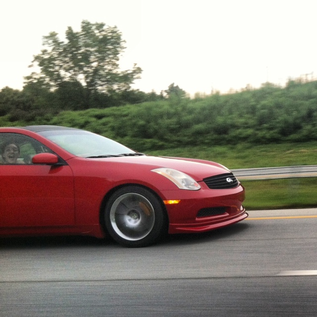

hey guys so ive had my g35 for a few years now and finally decided to put some wheels on. I have a slight drop with stech tein lowering springs and I really wanted to get these for my car. they are Varrstoen 112 19 inch. any suggestions on offset and wheel size i should go for? thanks guys look forward to talking to u all.

Roll the fenders and do a 19x9.5+12 front and 19x10.5+22 rear
Make sure via varrstoen their disc sizes will clear your brembos

my rear fenders are already rolled. not the front tho. I read that i need a +12 offset to clear my brembo brakes. will i need to roll my front ones if i just go with 245 tires?

they should be fine
Don't listen to +12 clearing brembos
Disc size is what clears bbk not offset

Go with what Taylor said, except in the rear I would go less offset. I'm running 19x9.5 +12 in front and 19x11 +15 in rear with 245/35 and 275/35 respectively. Next time I'm due for tires, I am probably going 255/35 or 265/35 up front, and 275/30 or 285/30 rear. I personally think that the 35 height on the rears is too much, but its all in taste man.

With your drop stevoo I'd suggest some 20s. 245/35 275/35. Offsets +15 front/+20 rears. And you wouldn't be looking bad.

Almost forgot, 20x9 and 20x10(front and rear)

Wheels are 19 inch Varrstoen ES6 and Im on HKS coils (3k springs) which are as low as they'll go (not very low.) Rears are rolled, fronts are not, and I still have full fender liners. As far as fitment, its all about camber. I'm running -2 up front and -1.7 rear. Fronts rub under hard compression while turning, but no big deal. And no spacers. 9.5 width with +12 offset in front and 11 width with +15 offset in rear. You can add spacers as you please to get the amount of "poke" you want, all in taste man.
