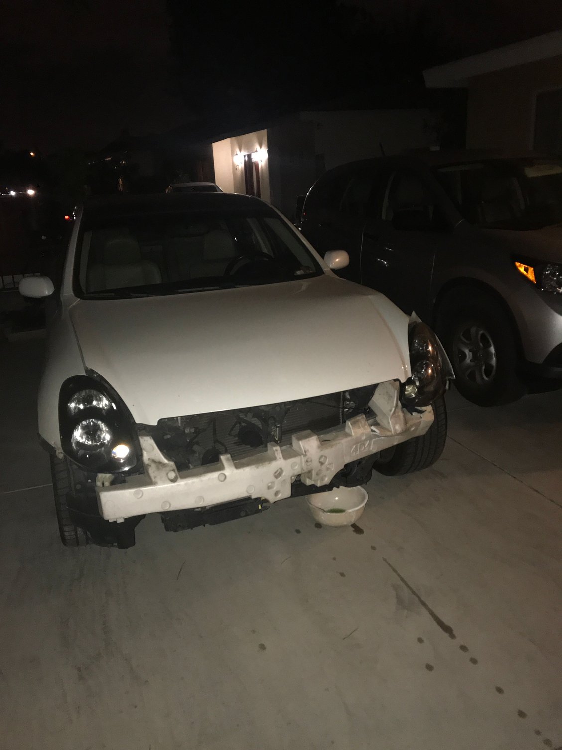

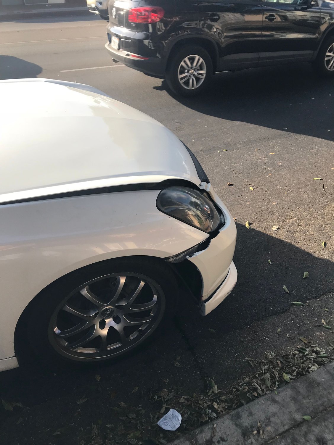

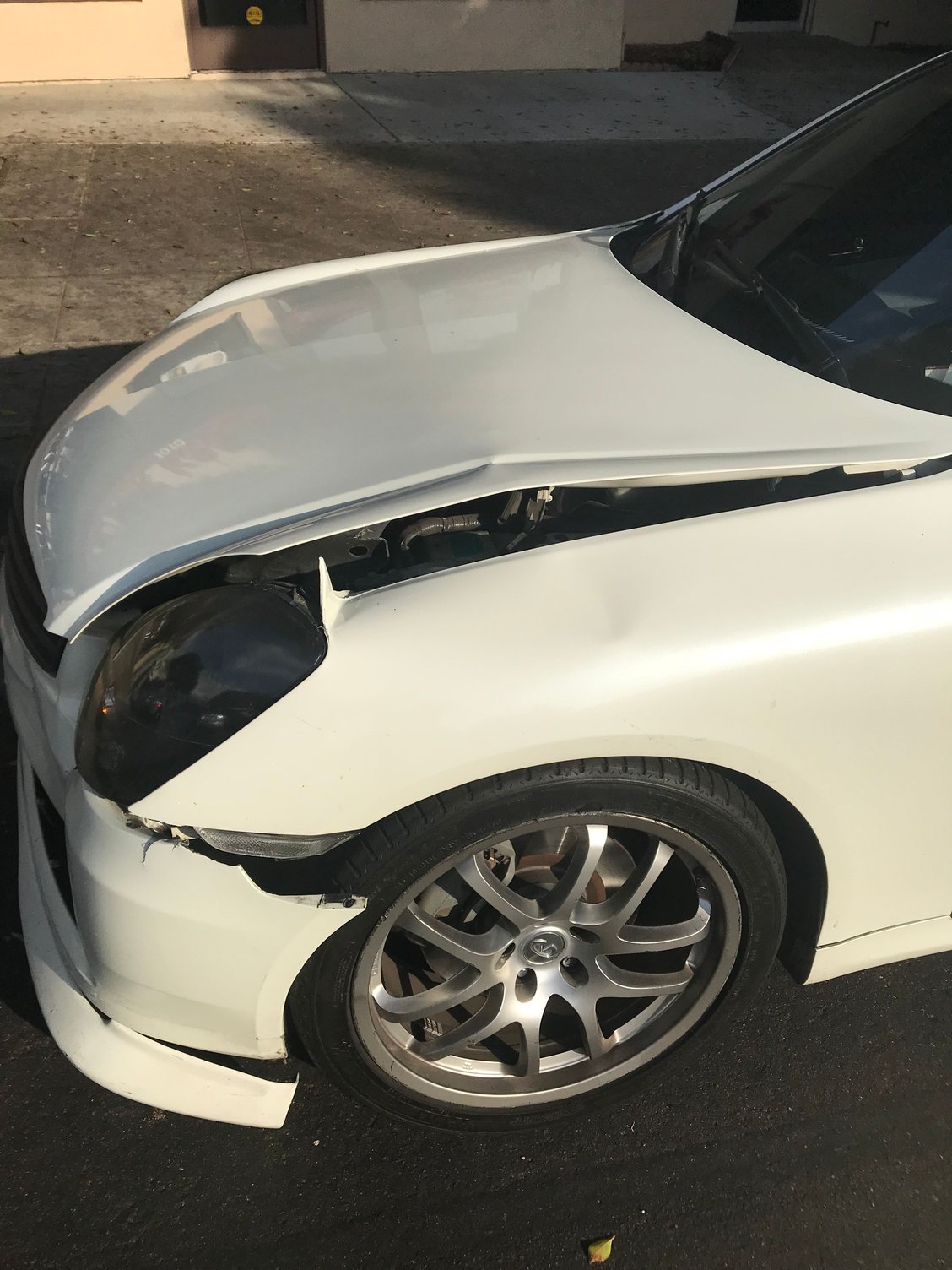

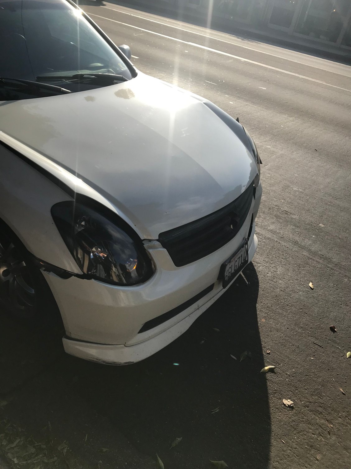

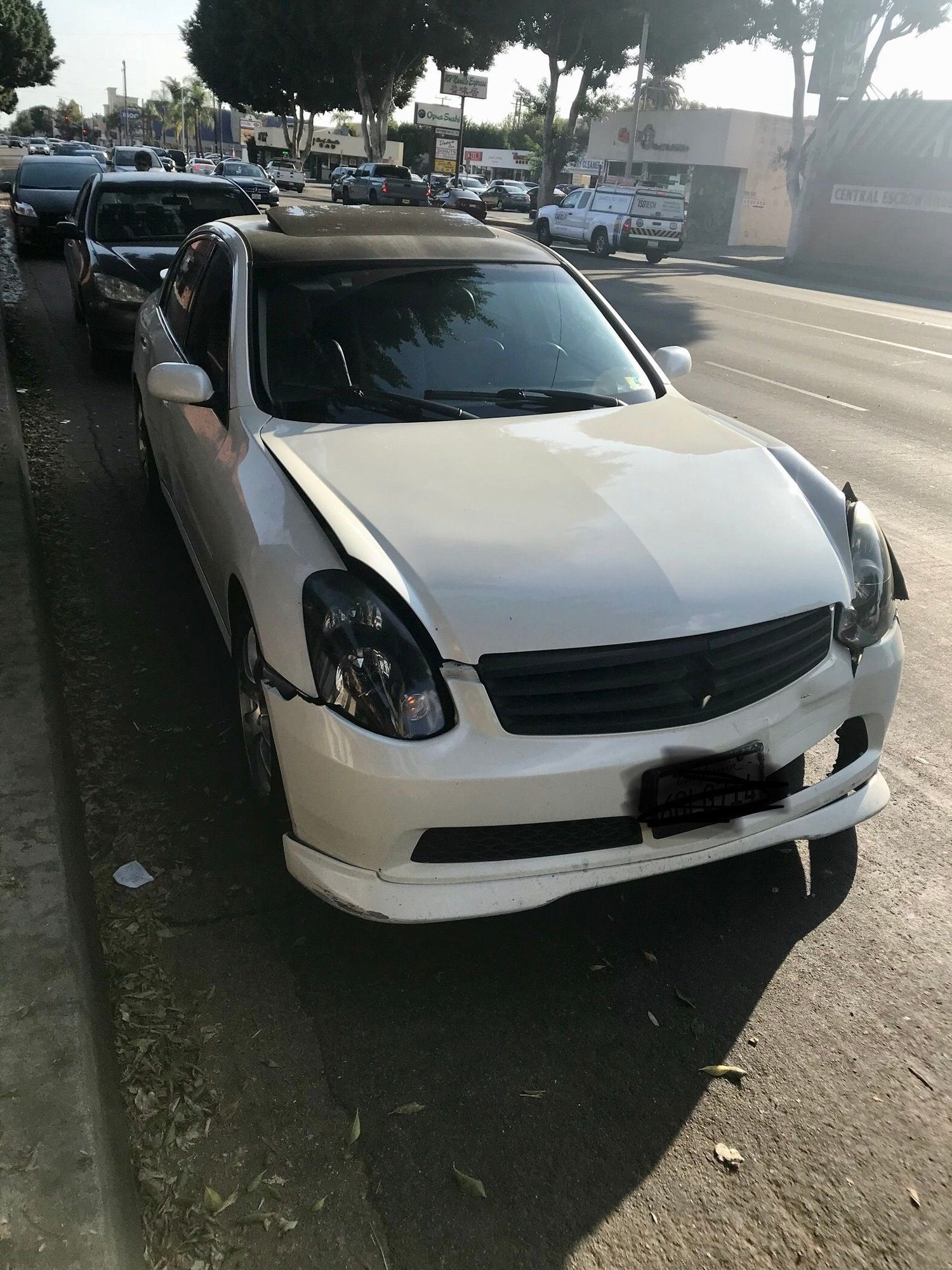

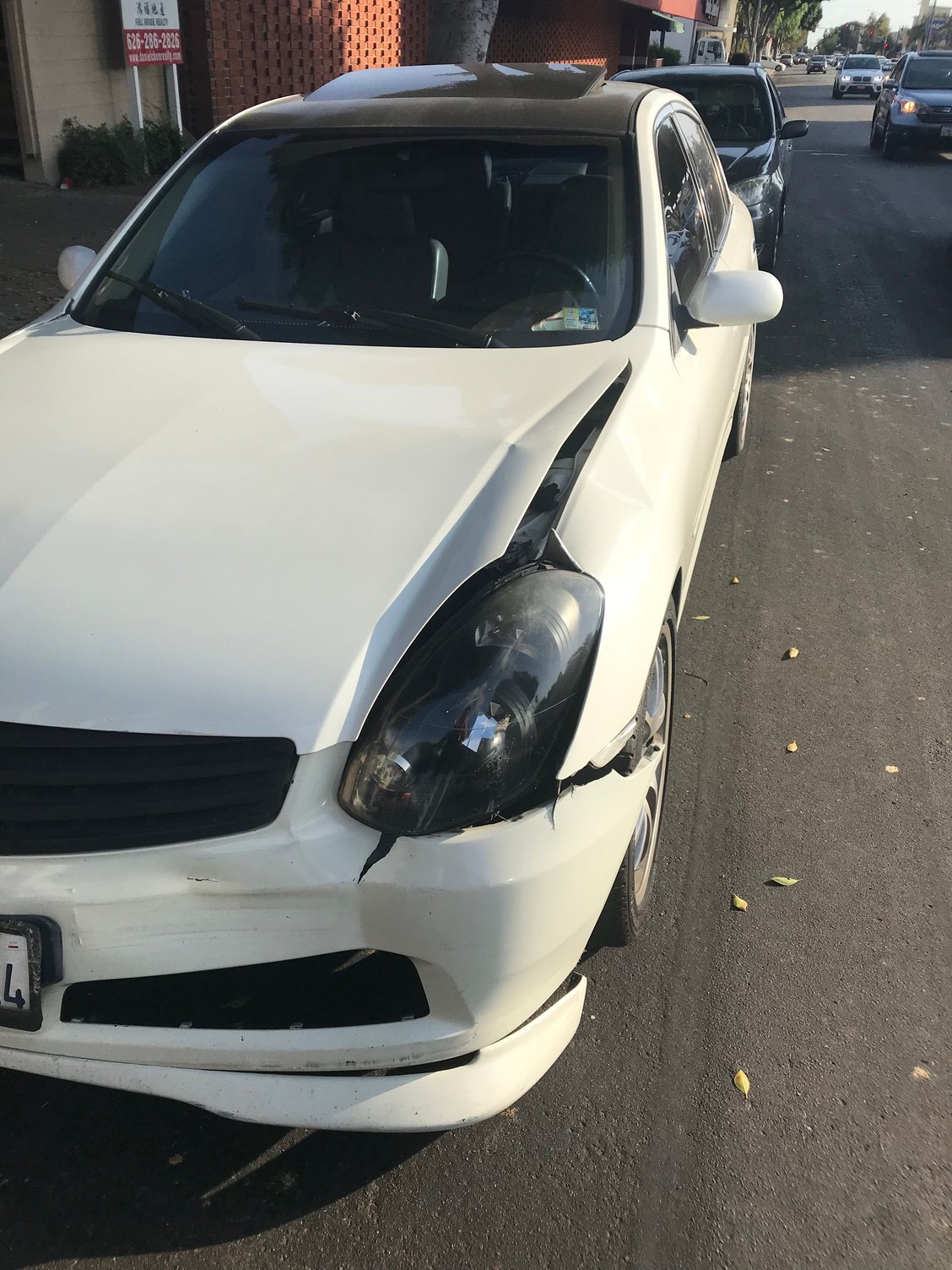

Unfortunately I just had to get in an accident with my g35. Would very much appreciate any kind of help or advice on helping me fix it back up. It is a 2005 g35 sedan. Love this car to death so help me revive it!

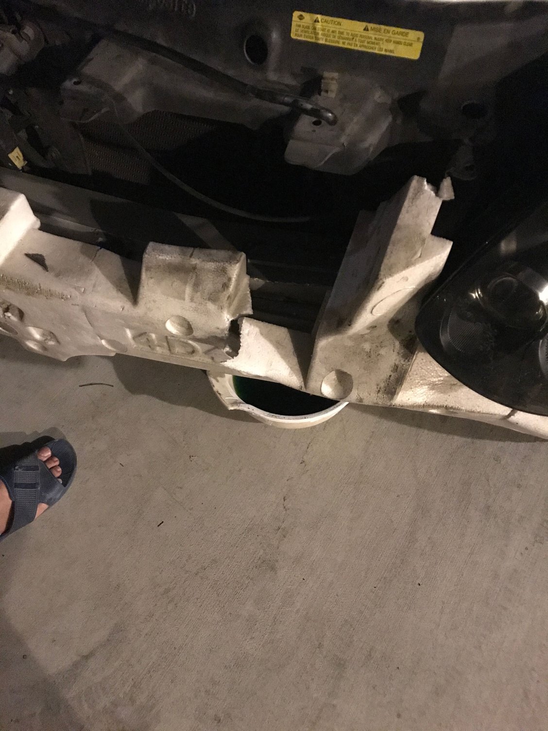

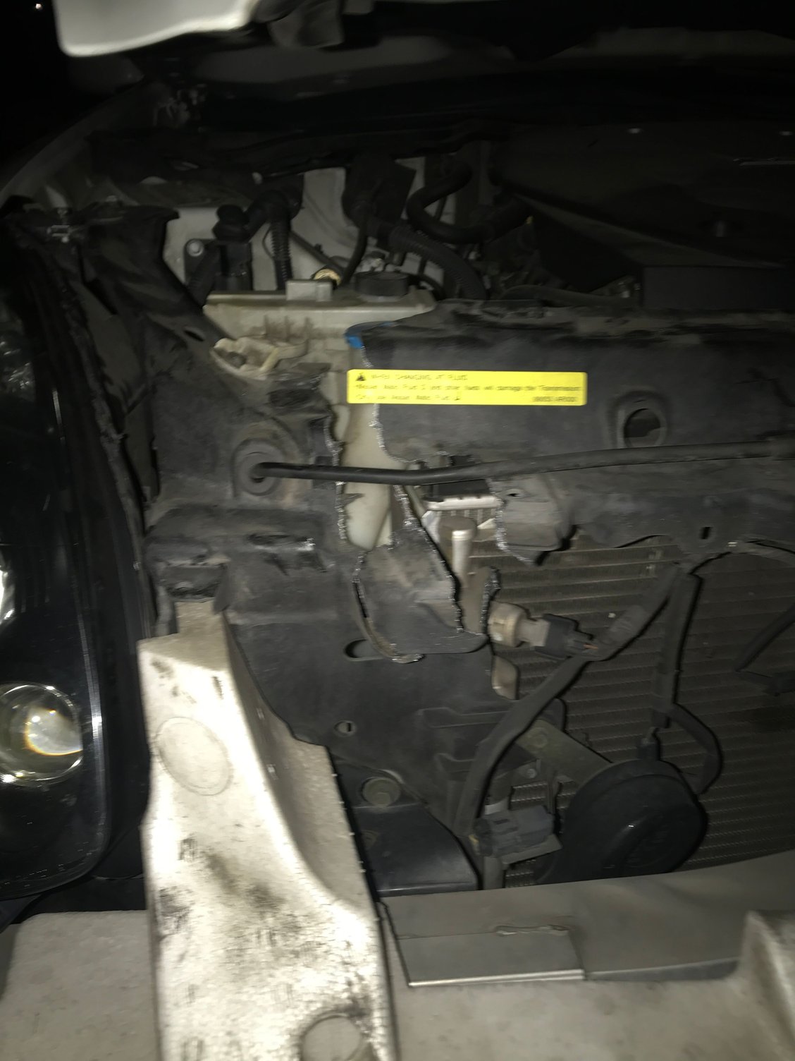

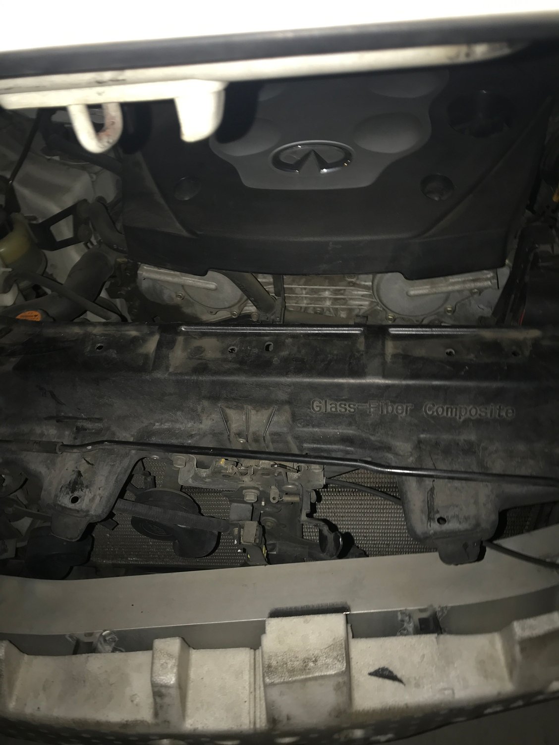

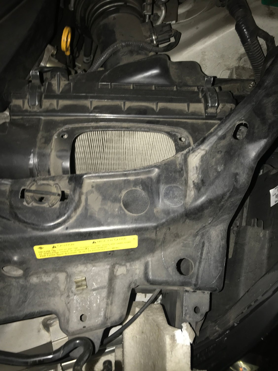

Significant damage, complete replacement of all front components, no apparent frame damage. Talk to your insurance company but they will likely total out the vehicle.
If you want to tackle the project yourself I recommend finding a donor vehicle with either a blown up motor or significant rear end damage. You should he able to find something for about $1000 and then it's much easier to pull all the pieces at your leisure, salvage all the remains.

No airbag deployment correct? I would disconnect the battery and leave it off at least until you have the frontal crash sensor disconnected so you don't accidently deploy while taking stuff apart. Replace the frontal sensor since it took a pretty good whallop.

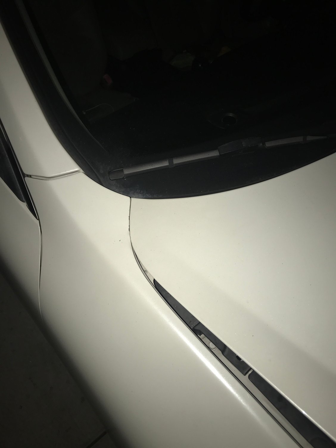

Yea airbags did not deploy. My insurance does not cover so everything is coming out of my pocket. Would u know if i had to replace my hood too?

Yep and the hinges, whole front is shot.
