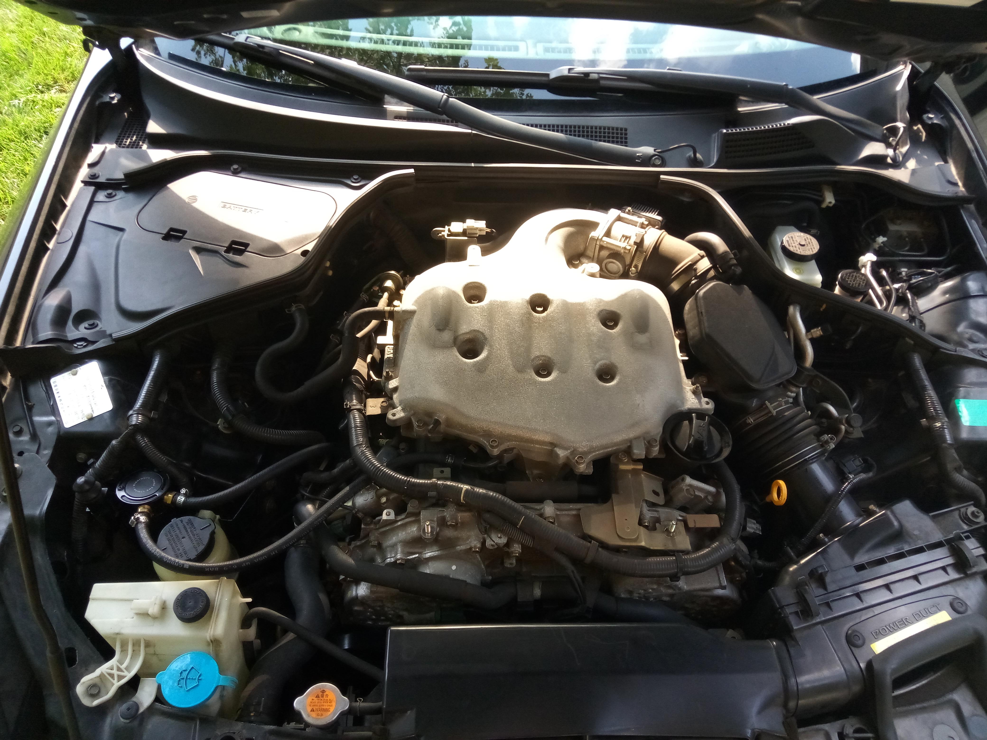

Hey all from Charlotte, NC. Love this forum, an absolute godsend for people who work on their own car. Purchased my 05 sedan about two months ago at 130,700 and it currently has 133,800. So far, I have changed the oil, diff oil, trans oil, power steering fluid, clutch fluid, and installed a Mishimoto compact baffled catch can as well as had the wheels balanced and car aligned. About 300 miles ago the power steering pump went out, so I had it replaced by a local Nissan mechanic for about $450. He noted that the power steering pumps usually never go out on these cars, so I am not sure what went wrong. The clear coat is absolutely horrid, but not a big issue for me. Also, my windshield cracked the other day, which is what I assume to be the product of being black on black and sitting in the sun.

Congrats on your new addiction lol. Our cars are a blast to drive and you made a good choice with the 6MT. Pay attention to your oil level, the rev-up engines, which you have with the manual, are prone to excessive oil consumption. The 5AT motors are as well but it seems the rev-up has more of an issue with it. The crappy rings Nissan installed on these motors are the culprit, but it usually doesn't turn out to be a big issue until it gets really bad. If you do suffer from it just keep a quart of oil in the car and top off as needed.
I will suggest looking at aftermarket sway bars as your next performance mod, they will completely change the way the car drives and handles which I think you will appreciate. Read, read and read some more and you will probably learn more about your car than you care to. Welcome to the family and we hope you enjoy your stay for as long as it lasts.
Congrats on the new vehicle. Next thing you should do is completely clean up the ground system, battery cable is a jumper to the chassis, under the coolant reservoir (remove single 10mm bolt and lift straight up, leave the hose attached) is another 2-bolt lug like the battery cable chassis connection, it attaches to the timing cover, also clean the single ground connection at the TOP of the timing cover and both headlight grounds on the front of the wheelwell.
Use a wire brush, clean the bolt threads and the wire lug, coat with a very light layer of electrical anti-oxidation grease (NOT dielectric which actually BLOCKS current flow), and retorque, it will help prevent future grounding issues.
Some day in the future you will definitely want to replace the rear diff bushing but in the meantime you should at least inspect it for cracking to see how much life is left in it, if it's cracked then it's shot and likely bled out it's goop a long time ago.
I'm sure you've already noticed this but the rev-up motor usually likes to drink oil, you can buy the Nissan conventional 5w-30 for pretty cheap on the internet, Amazon has 6 packs for $22 with free shipping, it's a lot cheaper than buying from the dealership. Always check your oil level weekly
