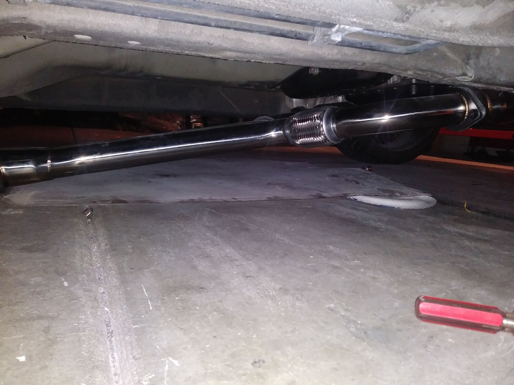

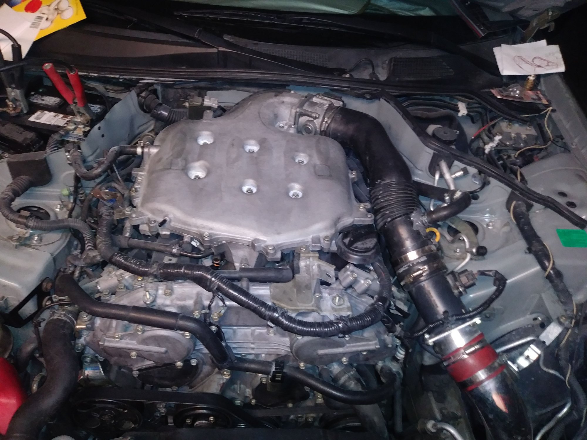

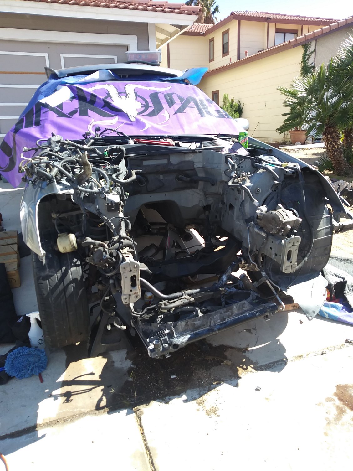

I've done a VQ35DE swap on my 2005 G35 Base Sedan (3.5L V6, RWD) with a VQ35DE JDM motor from Japan with 44k miles. It has bank A and bank B VVTI replaced with G35 VVTI solenoid's. I have a brand new stock G35 fuel pump. I have headers with mahle OE Spec gaskets, high flow down pipes by MeaghanRacingCo. with anti-reverb O2 sensor trickers, a Y pipe by MeaghanRacingCo. 3 inch stainless mid-pipe with resonator, 3 inch stainless flow master muffler. Car also has a cold air intake.
The car starts and runs but is currently backfiring once every revolution of the crank. I have unhooked the mid-pipe to see if I was getting any gyration, but it's still backfiring.

First things first, the original and donor engines were NOT the rev-up motor correct? I know the one in the photo is not a rev-up but you did an exact replacement yes?
I would swap over the old cam/crank sensors and see if that helps. Since the sensors are so notorious for failing you might as well swap to a known good pair.
Is it BACKFIRING or is it just MISSING ? Swap the old coil packs over and see if that fixes anything. If it's actually backfiring then you definitely have a timing issue.
Either way you need to do a compression test to see what's actually going on inside that motor.
