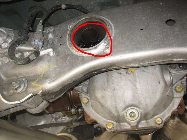

Actually I bet I know what it is, your rear differential bushing is probably 100% shot. Maybe even missing big chunks out of it. You can look up under the car with your phone and take a picture to see if it's missing large chunks, if it's the OEM rubber bushing they're usually pretty shot by 60k miles, I imaging by 300k there's probably nothing left.
Most folks replace them with a polyurethane bushing.

So thats under the rear wheels right?? Also can u tell me why this only happens after i have been driving abou 30 to 45 min? Thank you god bless u sorry i just know nothing about cars

Yeah it's the rear differential, that's basically the big round part in the middle hanging from the subframe cradle. It might not be the issue but it's a common failure point on these cars however it shouldn't make any difference in how long long the vehicle has been operating.

Hey is there 2 of those one under each tire?
