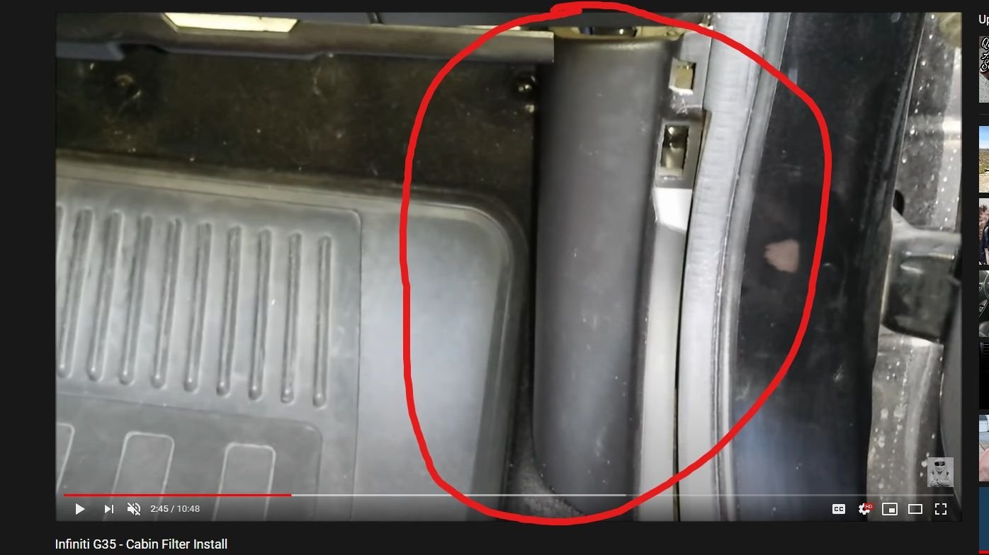

Make sure you are getting the correct transmission. 2003 to Early 2004 cars have the TCM in the passenger side lower kick panel, Late 2004 and on cars have the TCM inside the valve body of the transmission. You can verify by removing the kick panel:
As far as I know, late 2004 cars you have to take the car to Nissan/Infiniti to have the TCM and ECU 'married'. Not sure about the earlier cars...
