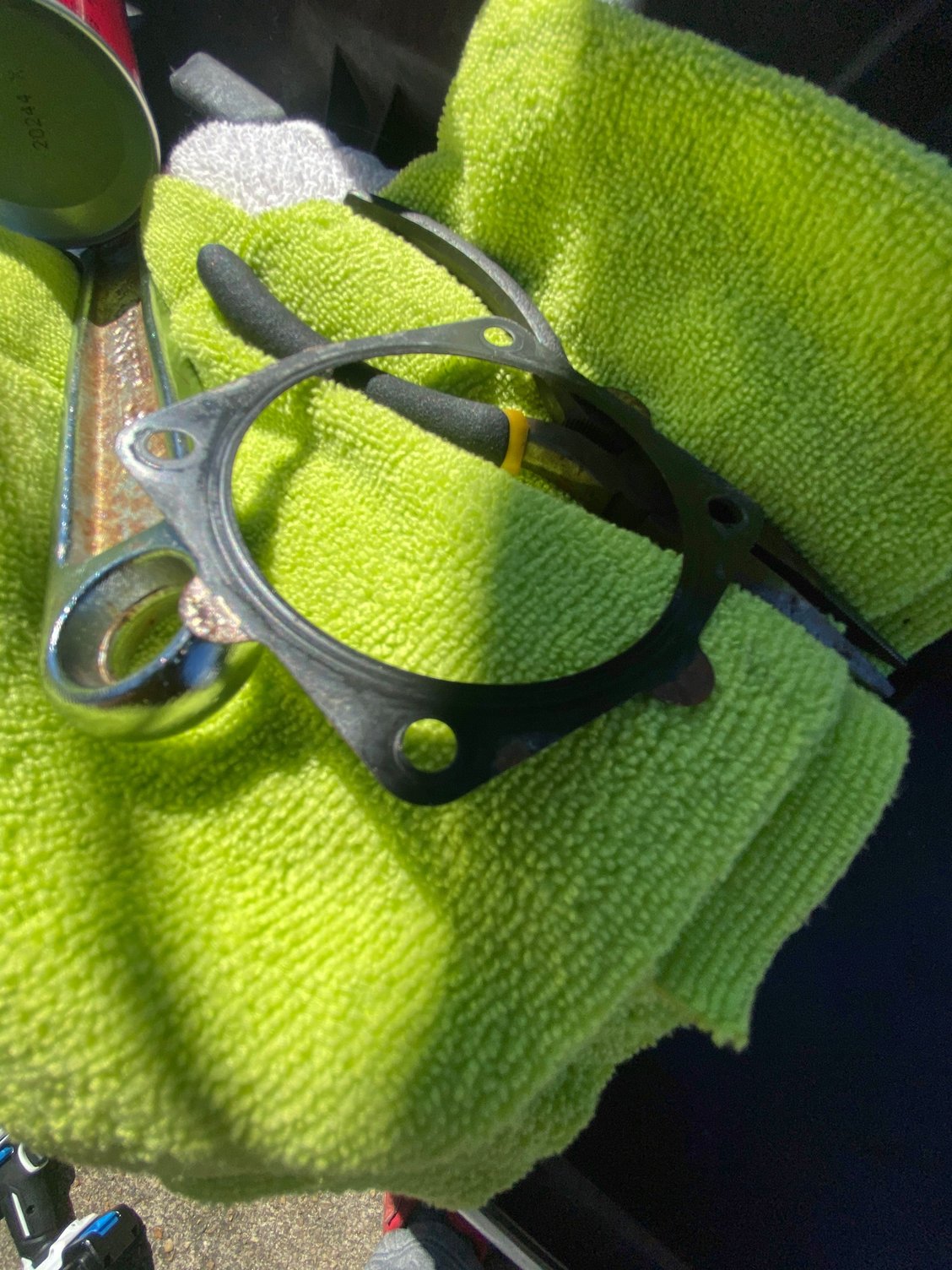

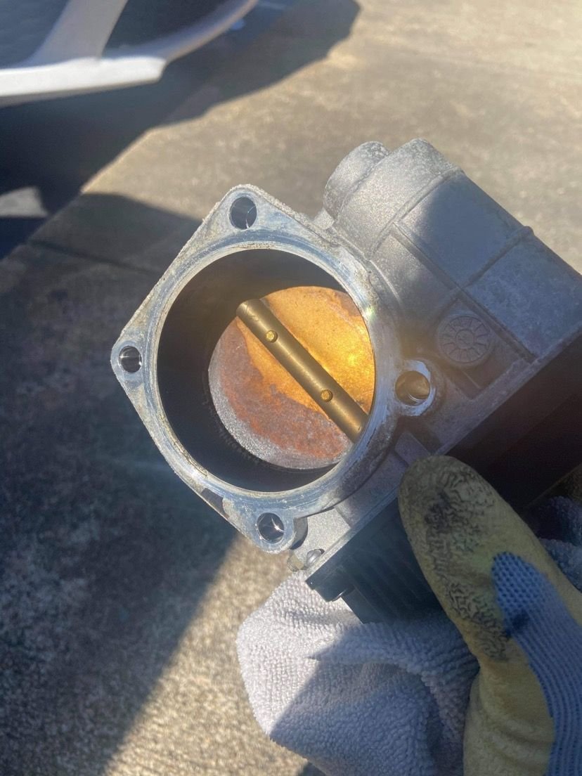

Brought it a few weeks ago it was stalling when it warmed up So I went 2 pick and pull grabbed a sensor clean it up (Maf) and threw it in figured it was that cuz of the cold air intake car still stalled on me after I took apart the throttle body and intake cleaned the maf again and cleaned the throttle body I did the ecu reset and the throttle body reset or relearn couldn’t get 2 do the idle one because can’t get the car 2 idle long enough now the car just turns over and dies don’t wanna turn the car over and **** anything up AND BEST THING OUT OF ALL OF THIS BS NO CEL OR ANYTHING ALSO PASSED INSPECTION LOL( pictures are before I clean the throttle body and after u clean the gasket) Ik I need a new gasket cut just asking just in case that’s not the issue

Make sure you are doing the idle relearn procedure correctly - you need to do it whenever you touch/clean the throttle body. Check for vacuum leaks too
Also, those steel gaskets are supposed to be replaced after every disassembly
