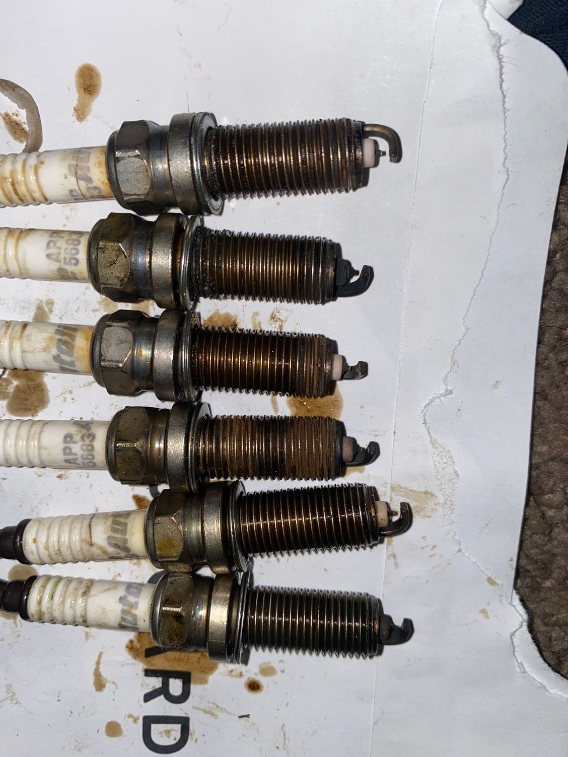

SO! I did get them out all six and this is what I have found
They are in cylinder order 1-6. So 2 4 6 are burnt out almost and number 5 was just covered in oil badly. I know that means a valve cover gasket replacement is needed. But let’s say I change the spark plugs and my problem still isn’t solved what’s the next step?

Something is definitely wrong with bank 2, I suspect the O2 sensor is making that bank run rich but you would need to test the sensor.

I would start by checking what the fuel trim is on that bank.
OBD2 bluetooth adapter, BAFX makes a great one.
Nissan Datascan 2 app for an android phone.
Then you can monitor all the sensors in realtime, and log the data.
I also noticed that the plugs you removed were not the OEM Denso FXE22HR11 irridium plugs. Strongly recommend sticking to factory plugs and not using Autolite platinum plugs like the ones you pulled out.
If checking the OBD2 data is over your head just run your plugs for 1000 miles then pull and inspect them. That will tell you more anyways, learning to "read the spark plugs" is a very useful skill. Plus it will give you a second chance to check the spark plug tube well for oil, you do this BEFORE the plug is removed.
If you pull out the plugs and they look fouled again in 1000 miles then you probably need to do a compression test as well.
EDIT: It's also possible you have the injector on the middle cylinder starting to flow less, thus that bank will be reading a little leaner and the ECM will compensate more fuel for the entire bank which causes the other two cylinders to run rich.
