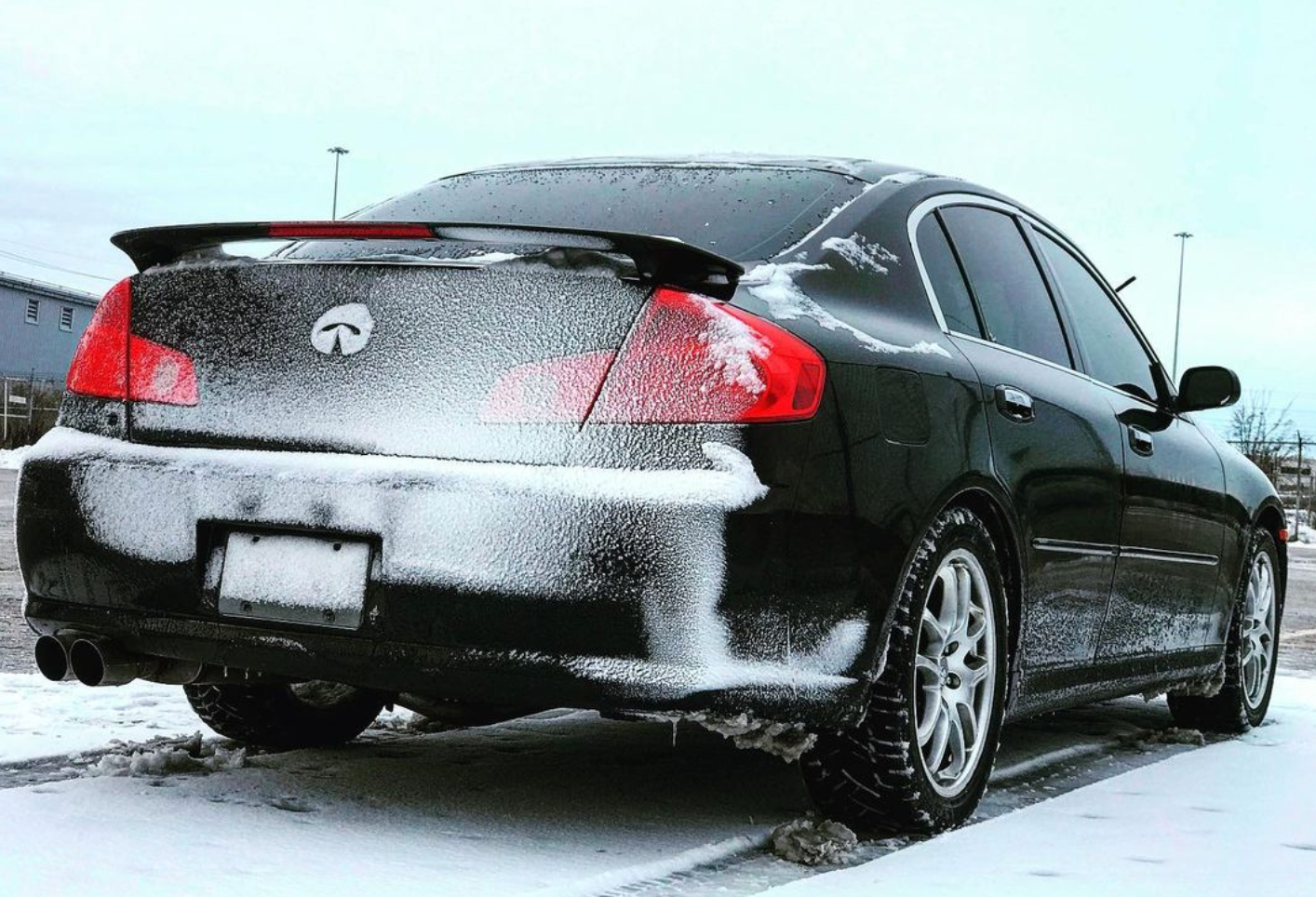

Here is a photo of my ride. It is my current winter daily driver in Canada.
