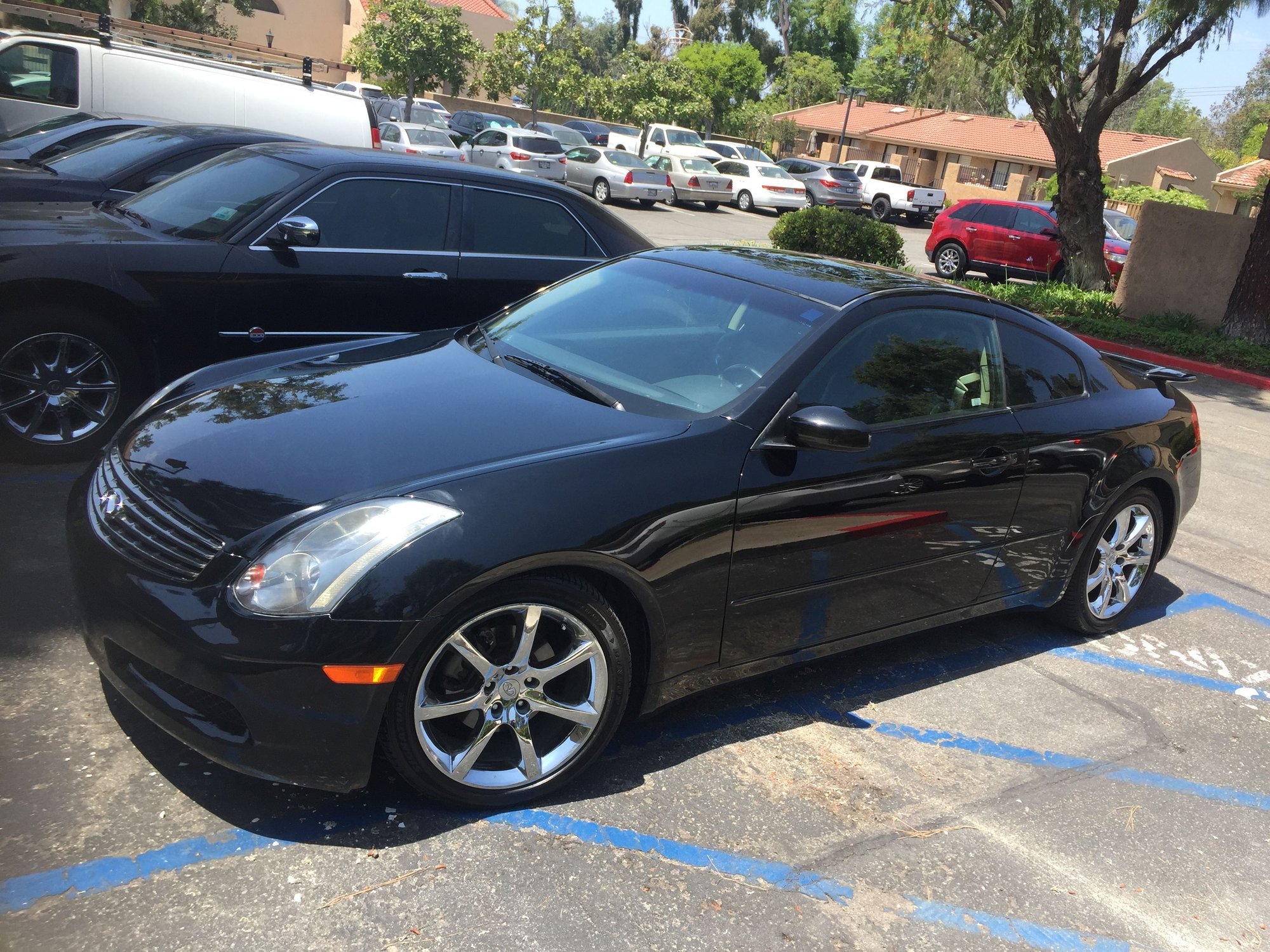

Infiniti G 35 I think its fully loaded I just received it
03 g35 vortec little power
Full vortec system not much power gain
03 g35 vortec
