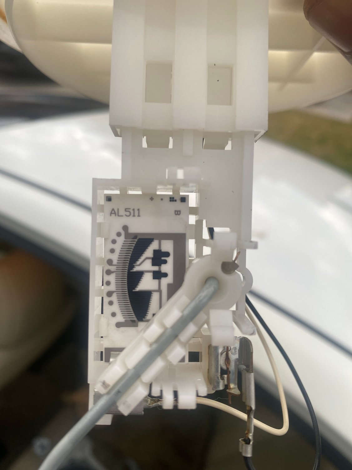

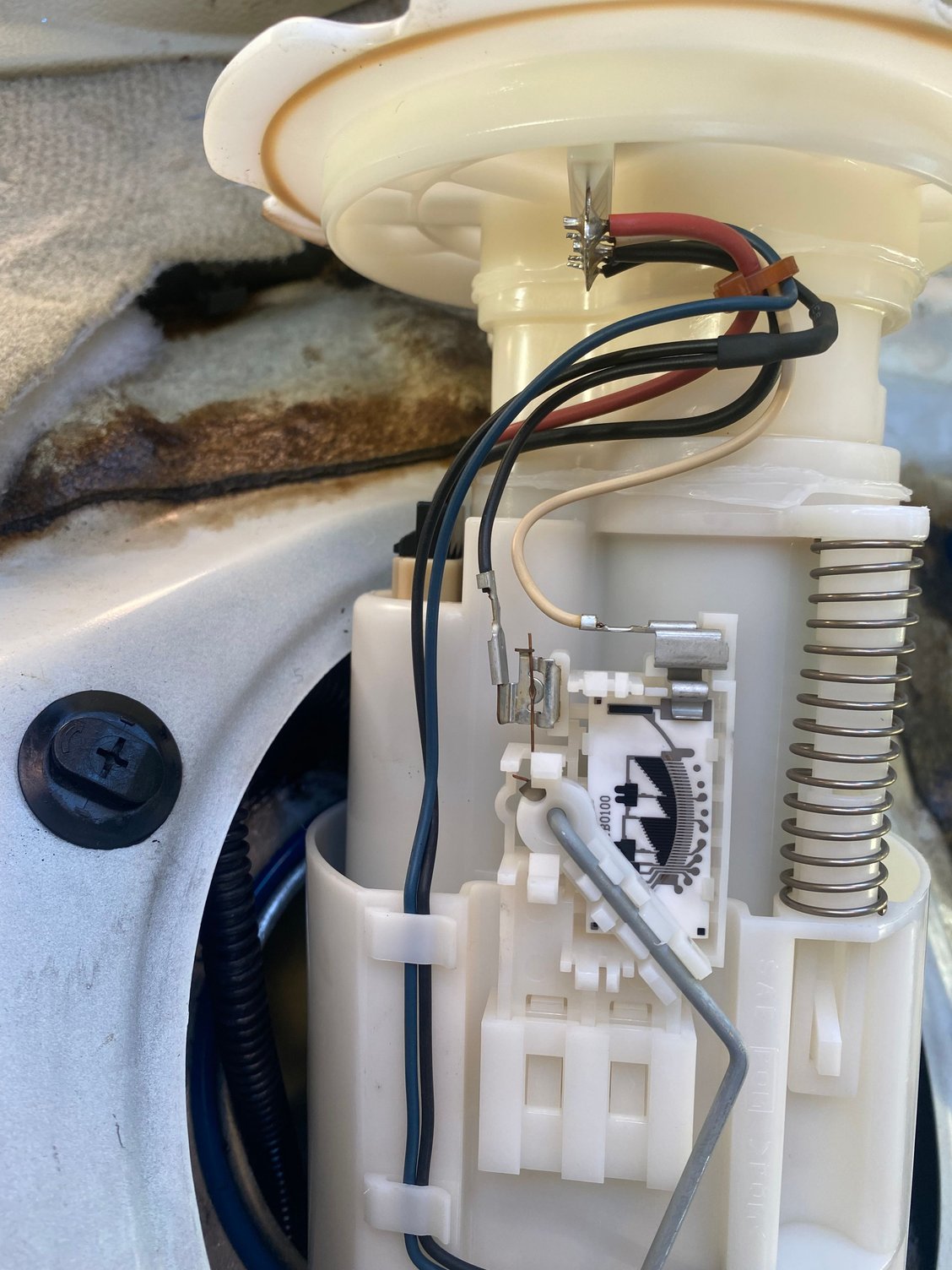

My miles reads inaccurate and fluctuates at its own digression. I literally just put 10$ right now.I cleaned both sending units in the backseat and on my driver side one looked like the sensor has been fried or damaged when i cleaned it off with a q tip. Does anyone know if replacing my the driver side sending fuel unit will fix my gas

This is drivers side i just cleaned it

Does the resistance scale correctly when you move the float arm? That one is the sub pump.
Idk what you mean. If you mean the needle then yes. I literally ran out of gas in front of my house after putting 10$ In thursday at 5:25pm and only driving about 10 miles. I really have no idea how much gas i have since my fuel gauge still read blank ***** after putting 10$. If my mpg really is that bad. Could it be faulty fuel pump or fuel injector pumping too much gas into the engine? Idk because when my car is in “acc” mode you hear the fuel pump priming so i do t think its that or is my oxygen sensor getting old ? I have no check engine light so im trying to rule out any reasoning for my terrible mpg. I admit i do occasionally floor it or idle sometimes longer than I should i know waste gas but 10$ should at least give me 2 gallons which compared to approximately 16mpg we get that should be 32 gallons i should’ve had.

No I mean back on post 5 where I was talking about how to use a multimeter to measure resistance (ohms) to actually verify the float arm is sending the correct signal.
With the sub pump unplugged and removed, put a test lead from the DMM onto each of the two wires (there's only two wires in that harness for the sub), now watch the resistance reading on the DMM as you move the float arm to the full and empty positions. Does the resistance scale properly as I described in that previous post?
If it does then check the primary pump, same thing, disconnect and remove from the tank, this time you need to put the test lead probes on pins 2 and 5 of the pump while you move the float arm.

Any cheap multimeter will work, even the $10 Cen-tech one from harbor freight. As long as it can measure ohms/resistance.
Sub pump should be roughly 3ohms full tank, 10ohms 3/4 tank, 20ohms 1/2 tank, 30 ohms 1/4 tank, 40ohms empty tank.
Primary pump (the one with the fuel pump on it) is roughly 3ohms full tank, 20ohms 3/4 tank, 40 ohms 1/2 tank, 60 ohms 1/4 tank, 80 ohms empty tank.
If you measured the sub pump (one you pictured) and it was 1/4 tank at roughly 36 ohms that's a correct reading.

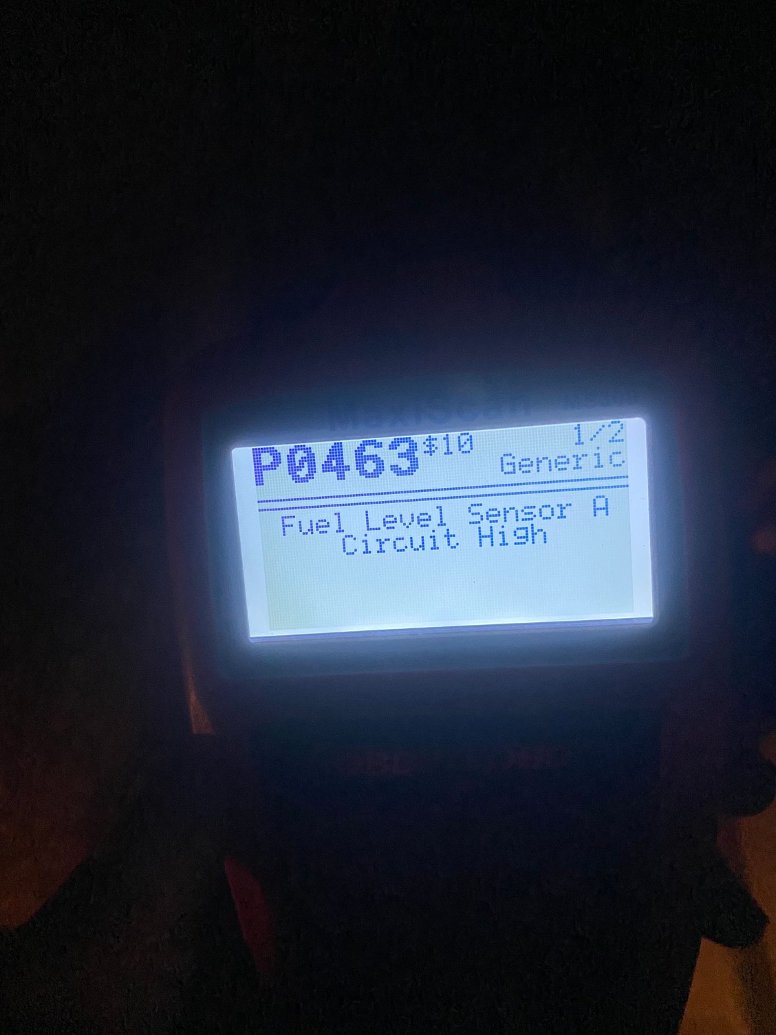

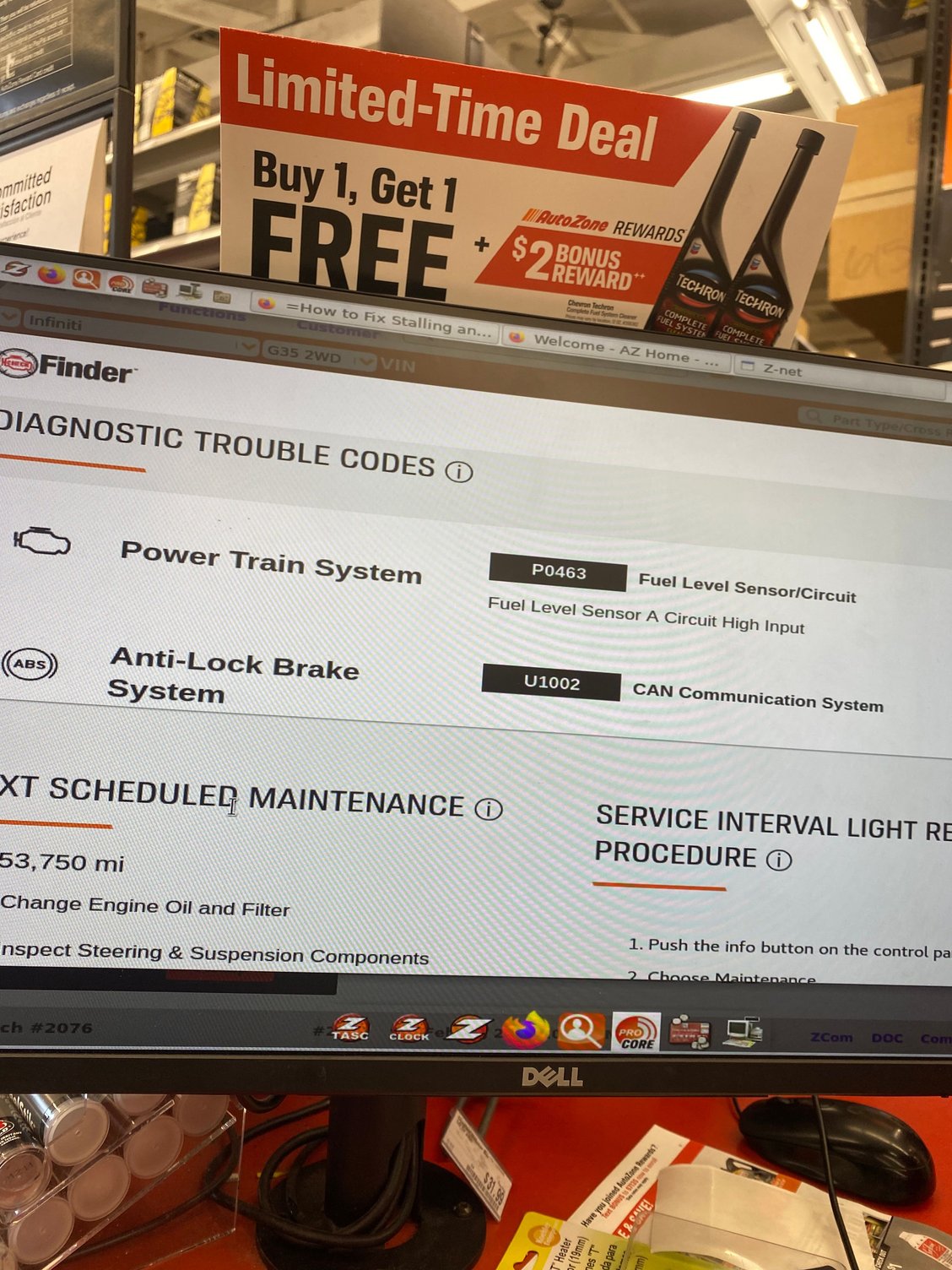

So i just got a check engine light for P0463 code “fuel level sensor a circuit high” im curious on which one has to be replaced. The whole fuel pump assembly (passenger) or the fuel sending unit side
Also can you tell me what that code about the brakes mean. I did change my front brake pads last week with a friend.
(driver) I still need to buy a digital multimeter i seen one at harbor freight for cheap i will purchase soon.
