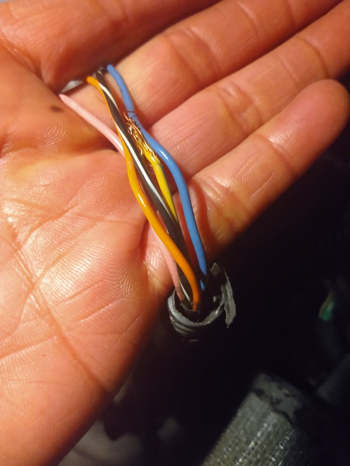

Need Help Again!! Which wire goes with which? I'm so confused. Should I solder the wires together or not? 2004 G35 coupe.
These are the wires from my car.

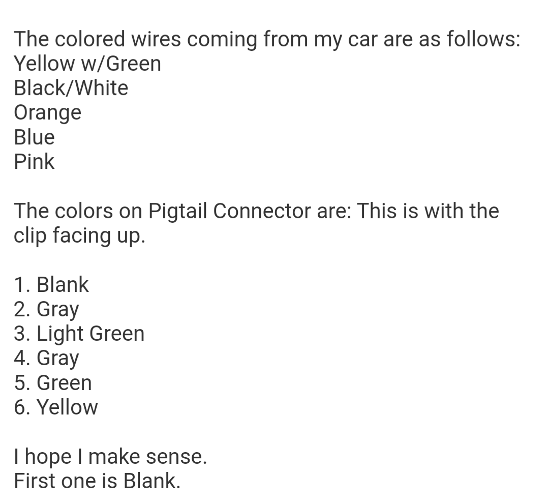

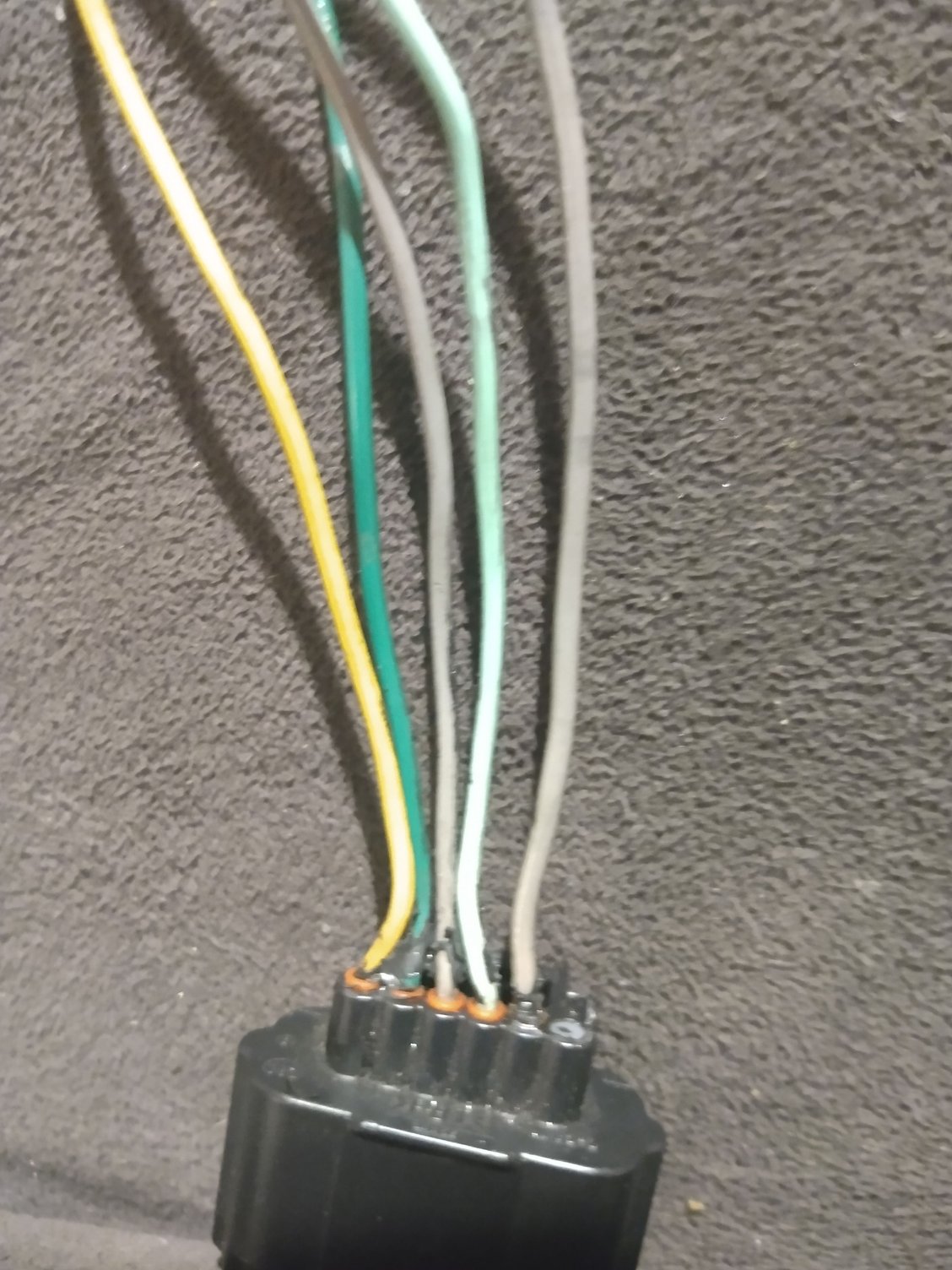

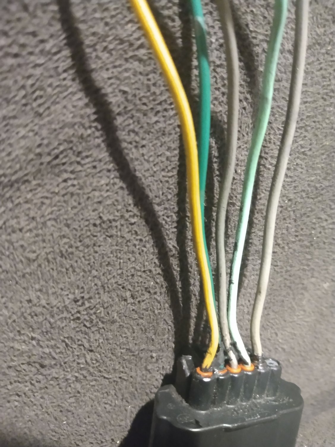

Yes! So I printed all the info you guys provided for me. I gave my mechanic the info. So this whole time I thought he was working on it or job was completed.I was in no hurry to get my car back. Anyways, long story short. My mechanic passed away on 1/3 from Covid. So I decided to bring my car home. I couldn't. He never got around to working on my car. I don't have the means to have someone do the job. So now I wanna try and figure this out myself. The colored wires on the
pigtail are different from the wires on my car.

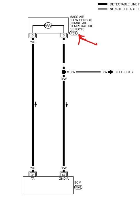

Here's the schematics again.

So on the F39 harness, if you are looking straight at the harness with the locking tab facing up, it should be left to right (pins 1 - 6)
1Blank, 2Pink, 3Black/white stripe, 4Orange, 5Yellow/green stripe, 6Blue
It doesn't matter what color the wire is on that pigtail, just make sure the correctly corresponding engine wiring hooks up to the correct pin on the pigtail.

Here's a screenshot of your pm to me with wire colors.
Old Jan 24, 2022 | 10:13 PM
cleric670's Avatar
BANNED!!!
Joined: May 2017
Posts: 14,837
Likes: 2,497
From: Washington State
Coupe 6MT Premium RAS
Pin1, Nothing on the blank pin obviously.
Pin2, your car pink wire to pigtail grey2
PIn3, your car black/white stripe to pigtail light green
Pin4, your car orange to pigtail grey4 (one of those two grey wires is probably a different color or has a stripe btw).
Pin5 your car yellow/green stripe to pigtail green
Pin6, your car blue to pigtail yellow
