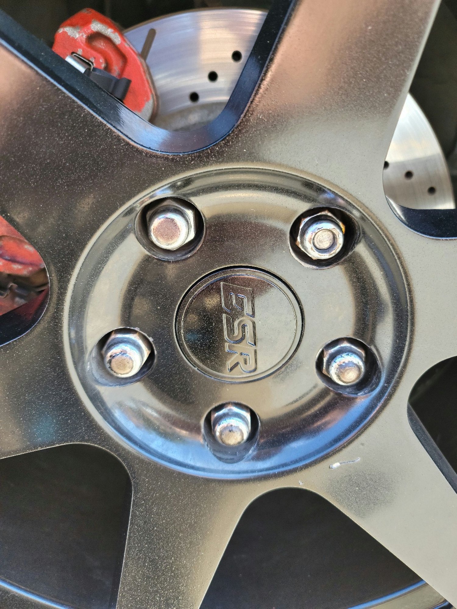

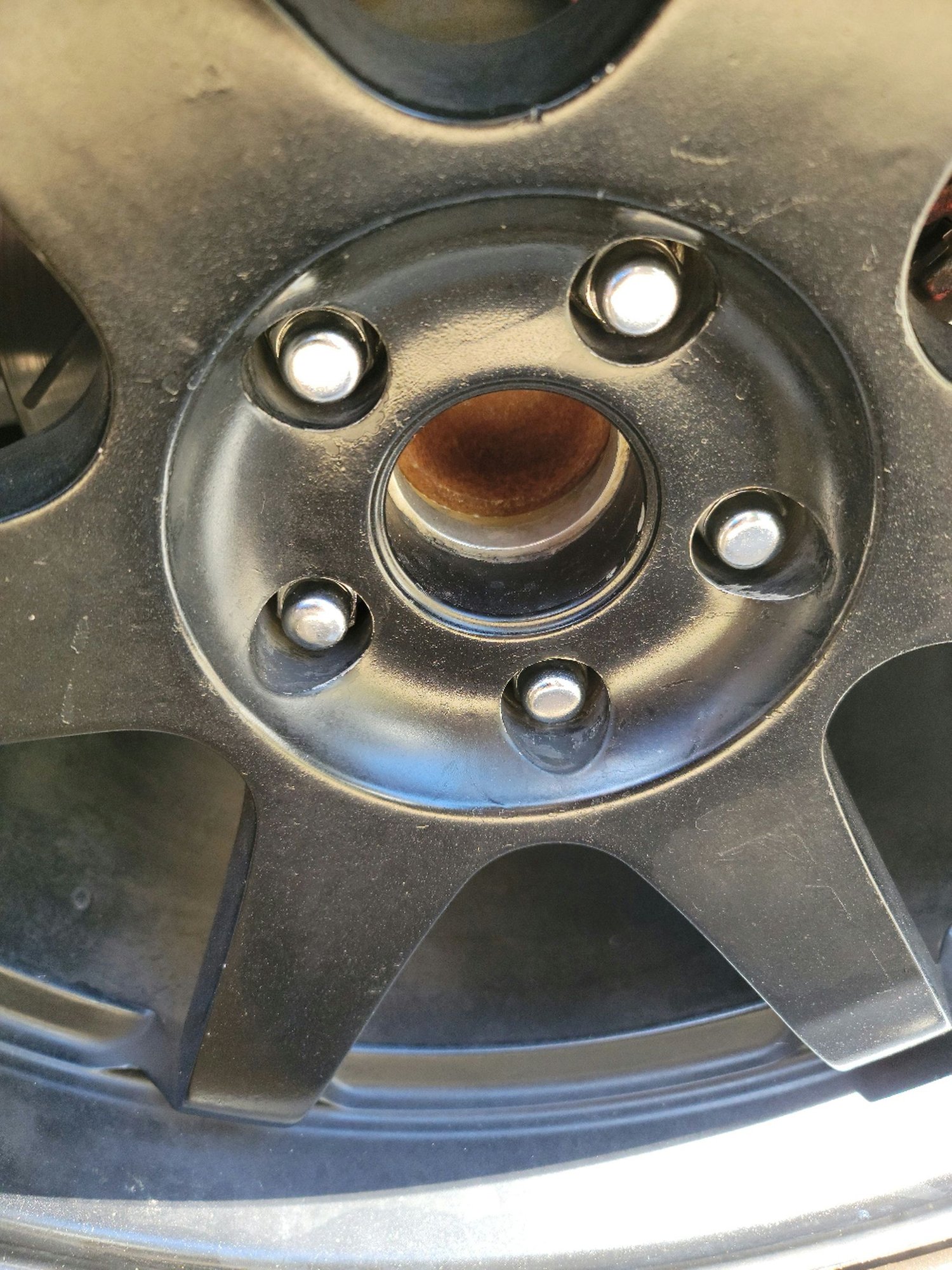

Heres what i have in the rear and the wheels i have

The spacer sizes I quoted are what the community has confirmed work for the OEM 19" coupe Rays at stock height. You need to run the offset info on your ESR wheels through a calculator to figure out what size spacers will work without rubbing (or just take it off if you only have one, which is probably the better idea). If you don't know the offsets already, you'll have to pull a front and rear wheel and read what offset is stamped on it. Pay attention to tire size too.

So it's just one front wheel that's rubbing and looks like it sticks our further than the other? Are you sure you're not running a rear wheel up front (and a front in the back)? It's tough to tell from the pictures. As G2B35AGN stated, pull the wheels off and take note of the size+offset stampings on them.

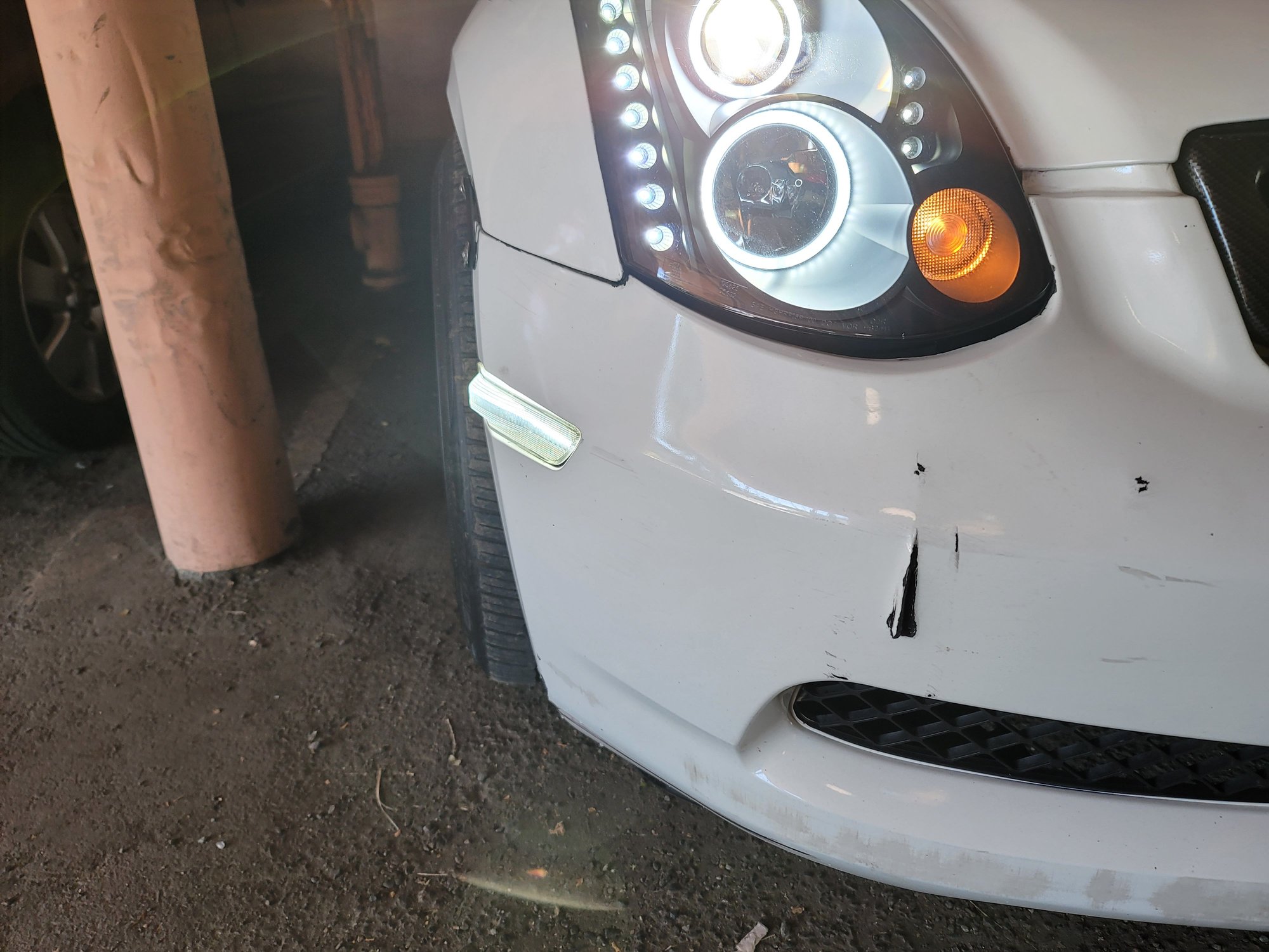

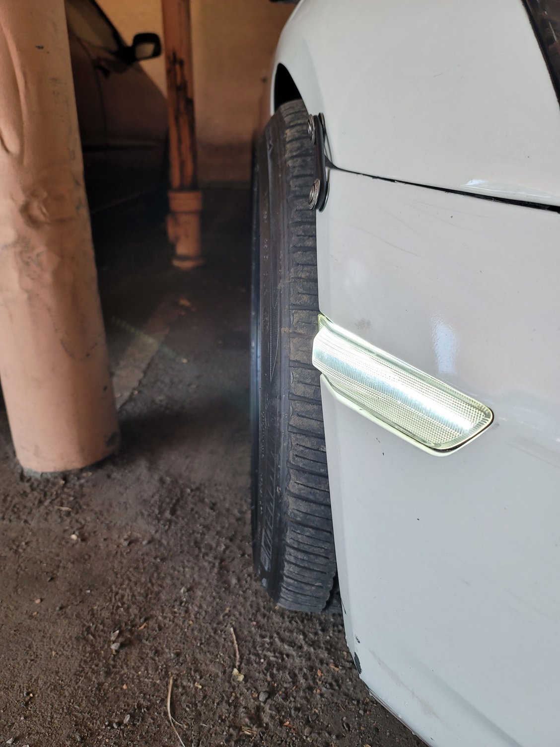

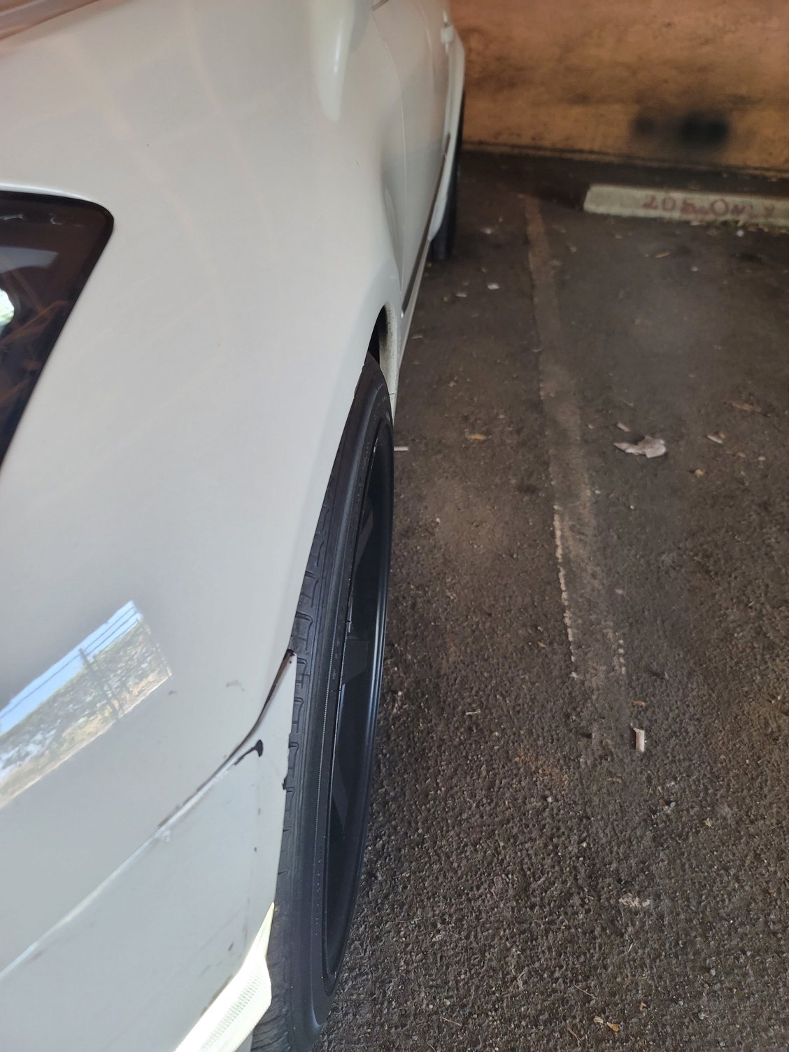

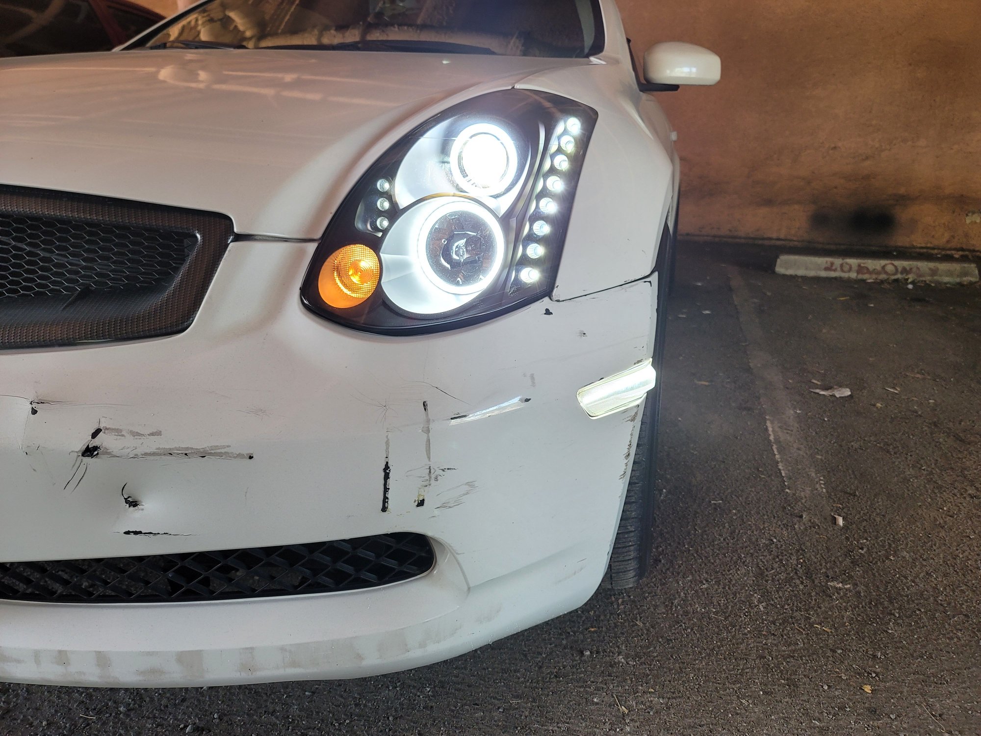

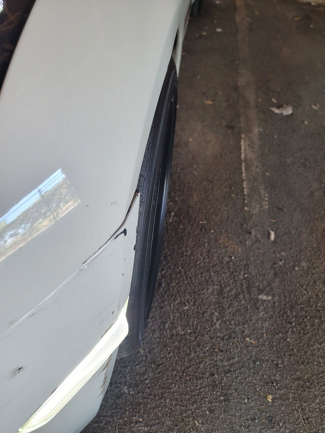

Hey guys, so thie is what i mean from 1 wheel sticking out from the other
Old Jun 30, 2022 | 03:41 PM
Kris4655's Avatar
Joined: Mar 2021
Posts: 48
G35 coupe
it rubs when i hit almost any pothole or anything when im at rolling speed

It looks like the passenger side fender is pushed in; are you sure it's not that?
I don't know what else you expect here. If you really think the wheel spacers are different sizes, measure the thickness. You probably don't even need to pop the wheels off to do that.. Beyond that make sure that if the wheels are indeed different sizes, that they're on the correct end of the car. The size and width should be stamped on the inside of the wheel somewhere.

After seeing the second set of pics though I'm starting to lean towards an issue with your car. Clearly the fender is bent, the front end of the car could also be skewed due to an impact.

Thats what im debating towards, maybe its the fender
