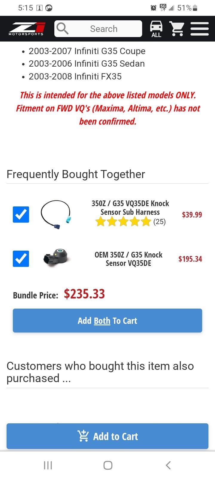

I ordered a Hitachi crankshaft sensor I will most likely take it to a shop for the knock sensor to be done can you send me the parts I need to buy for harness an sensor or can I just buy the knock sensor an harness from o reilys
