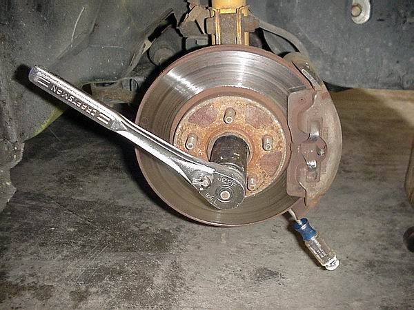

CV axle nut it doesn't matter whether the suspension is loaded or not. Usually I just stick a screwdriver into the vents of the brake rotor, jam it up against the brake caliper, and tighten the nut without the wheel on.
Rear CV axle nut torque is 152-202 ft/lbs. I normally go for the higher end of that range, 180 to 200 ft lbs.

Here's how to place the screwdriver.
