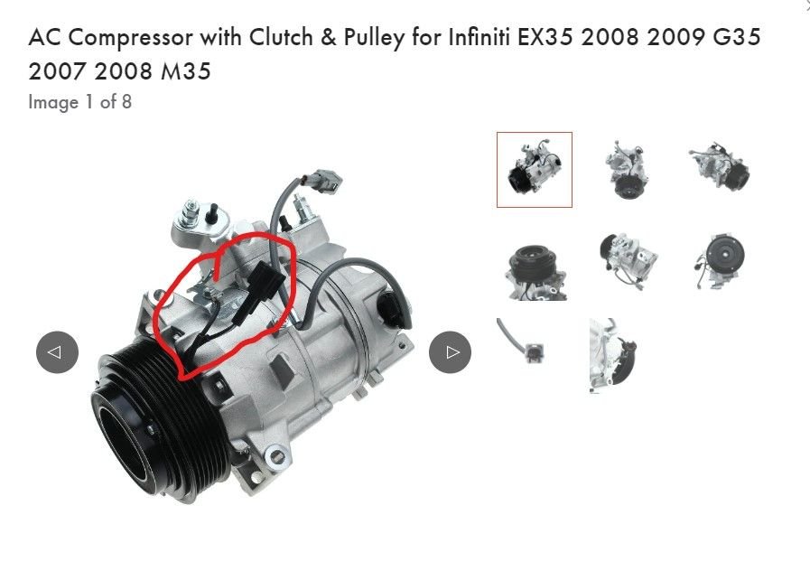

My 2008 G35S AC compressor clutch locks up and stalls the engine. I'm looking to replace the car in 4-5 months and trying to buy some time. Can the clutch be disengaged by unplugging the wire connector? The tech that diagnosed this tells me that unplugging the connector will not help, as the clutch starts even when the AC is off. That seems very strange if it is not connected to power. Either he knows his stuff or he's trying to make me approve a $1,500 compressor replacement job. Thank you for helping me sort this out. Gregg

Lol that's total bullshit, it's an electromagnetic clutch, if you disconnect the harness then there's no power, thus the clutch literally could not engage.
I suggest you never go back to that technician since he literally lied to your face.
Yes you can absolutely disconnect the compressor harness, it's located at the compressor which is under the vehicle on the HR engine I think, you will need to remove the lower engine splash shield to access it probably. Here's a picture of the compressor for the HR engine, it's a variable pitch compressor so it has TWO harnesses, you want the one I circled in red, it's wires will go to the electromagnet located directly behind the pulley wheel. You can unplug both if you want but for the sake of protecting the pins in the harness you should only unplug the clutch magnet one.
You might just poke around with a flashlight and inspection mirror to see if you can see the harness from the top of the engine but I doubt it.
If you have some electrical tape it wouldn't hurt to tape up the harness to prevent moisture from getting inside the engine side of the harness since we're going into the winter months with typically higher humidity and more wet on the roads. Depends on where you live really.
Also, I think $1500 for a compressor only job is insane, it's like $300 for a compressor and takes maybe 4 hours for the total job including refrigerant recovery and refill, it's an $800-$1000 job. I bet the dealership doesn't even charge $1500

Hi cleric670, THANK YOU!! You confirmed my suspicion and I appreciate both of your responses and the picture. I can deal with some window fog, especially living in Georgia, where the winters are easy. I will proceed to unplug the clutch harness and wrap it in electrical tape. Before I power up the engine, I will double check to make sure the clutch spins freely, just in case it has bound up, which I'm not aware of. Thanks again for your expert help, have a great Sunday, Gregg
