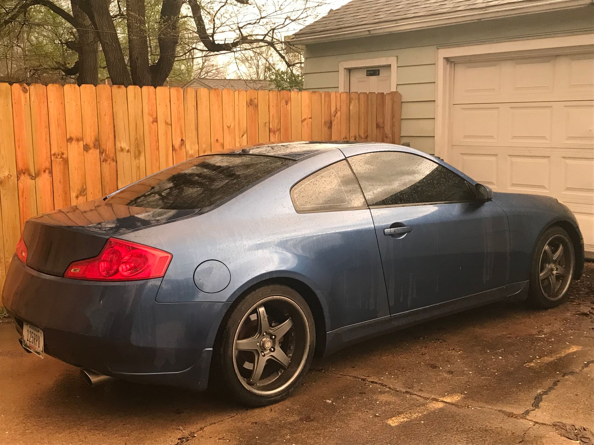

5ATs were available with sport suspension option. Does the steering wheel have orange stitching? If so, you have sport suspension. Front bumper is different with a slightly more pronounced "splitter" treatment. Side skirts are also different and have a "swoop" treatment. Can't tell from your photo on that. You have mud guards, and for the front, they would be different from the non-sport guards. You also have the horrible OEM Sirius XM puck antenna, so you probably have a receiver in the trunk floor on the left side if you don't already have a subscription. Unfortunately, that early era receiver had no buffering, so when you are not in a city with a terrestrial signal, bridges, tall buildings, next to a tall tree line, you lose the satellite signal and the music drops out....

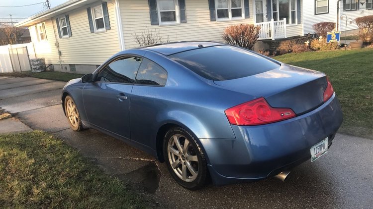

This model doesn’t have orange stitching on the steering wheel, only leather wrapped, and the shocks are black, so I would say not a sport package. That would mean no VLSD unless it was ordered specifically from the factory? This G is strangely optioned, with the convenience package, sunroof, Bose, but no spoiler. The factory radio had no NAV but the pedals have aluminum covers, I know that was a sport package option also. The rims with low profile tires in the first picture came on the car from the dealer, and the second picture has the second set of rims with the meatier winter tires. I wonder what rims it had from the factory. There is a Kenwood touchscreen radio in it now with the Bose adapter so no need for Sirius. Thanks for pointing me in the right direction fellas, I just want to make sure I’m ordering the right stuff for this! I will say this, the low profile tires exaggerate the suspension issues 1000x more than the winter tires do, when I switched them over for this season it was much more apparent. Would the compression arm bushings cause the steering wheel to be slightly tipped when it wasn’t before, is that just from the worn shocks or a combination of both? As I mentioned in my first post, the car will hit one small rock in the road and it bounces like a fat lady on a trampoline. The tie rods are tight with no end play, the end links are solid, so are the ball joints but the bushings in the compression arm where the shocks mount are absolutely trashed. I don’t drive the car very much so I got in it the other day and felt a noticeable “thunk” when braking at the end of a normal stop coming up to a red light and also when letting off the brake from a complete stop. I just worry about my gf’s safety especially on the sh**ty roads where we live. This was her ex husband’s car and he didn’t really drive it much so she got it when the separated, however he didn’t maintain a thing on it so now we are trying to keep it going on a limited budget. My only vehicle now is a 95 Ford Explorer with 320xxx miles on it, because owning a home comes before modding cars at this point in my life but I love being a mechanic and want to keep her G going strong because I know these Nissan motors are solid. It’s the other things that will nickel and dime me to death here. I’m seeing here that sport suspension shocks will fit a non sport suspension as long as they’re for a coupe, so I guess I’ll pull the trigger on the KYBs from Rockauto and hope for the best. One more question: will the stock springs end up damaging the sport shocks more quickly than normal due to the different spring rate? Thanks again y’all.

Yeah that’s the non-sport bumper. Dealer might’ve also installed the aluminum pedals if they were swapping out other things. What’s missing is an aluminum cap for your parking brake. I was able to retrofit the aluminum cap for the clutch pedal to the parking brake when I got this car (I had the cap from the pedal mod I did on my previous 5AT non-sport sedan…bought a 6MT pedal set from a forum member).
