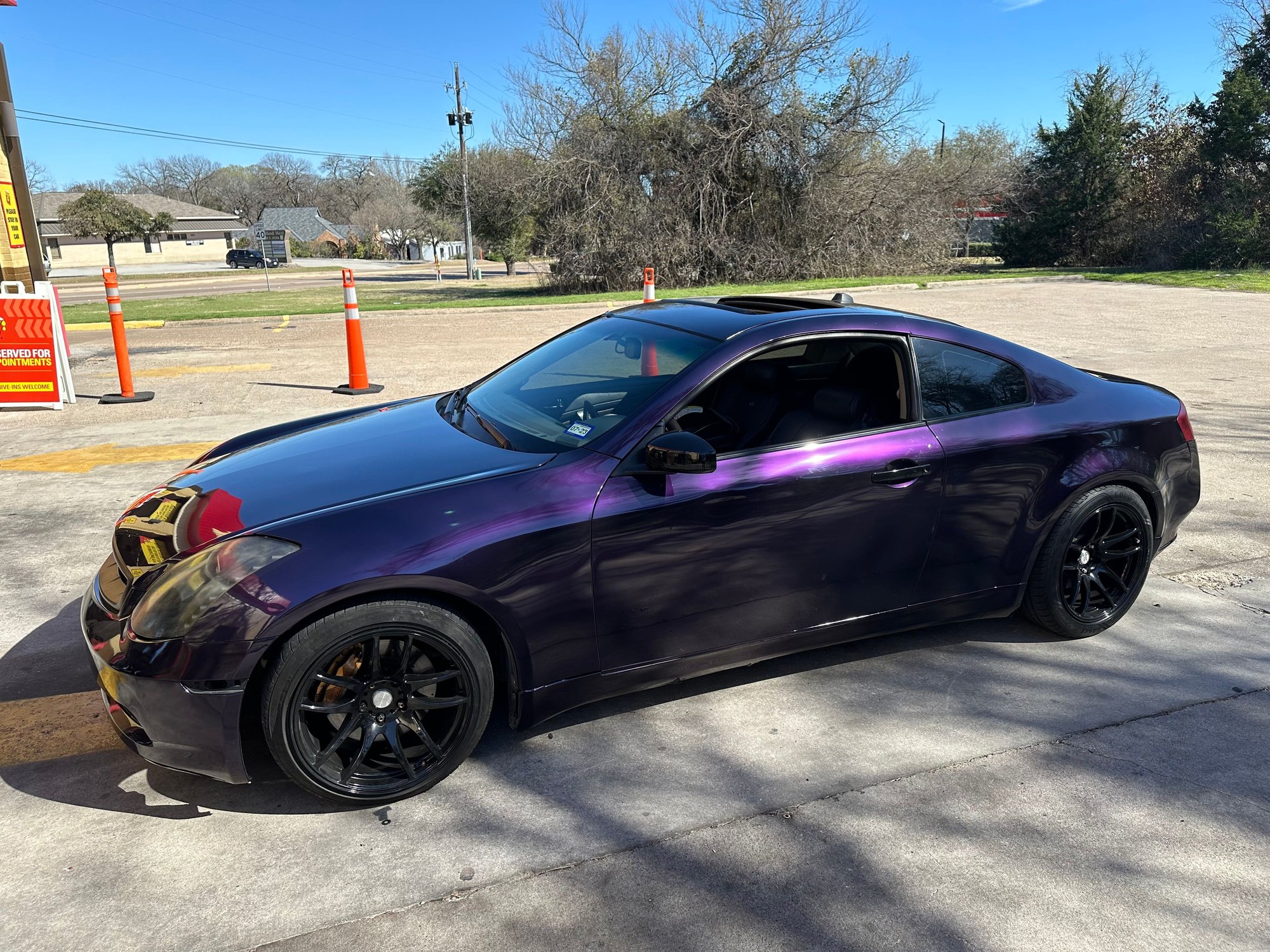

Hey everyone. First time G35 owner, copped one with 185xxx mi, few owners, for an relatively steal of a price. Totaling for an overall 5.8/10 car (needs moderate amount of work). My goal is to build a fun but not over the top daily driver. Would love to for the fun of it, possible see a 80+ hp gain on the DE with an tubro kit eventually down the line.
Wanting to first start on major maintenance
  • What should I start with?
  • What do people usually do maintenance wise when buying a used vehicle?
  • What problems should I suspect to happen in this mileage range?
Then after would like to improve handling/suspension, the trans, and finally exterior/interior work.
Any recommendations would help thank you
Looking forward to enjoying the VQ platform!
