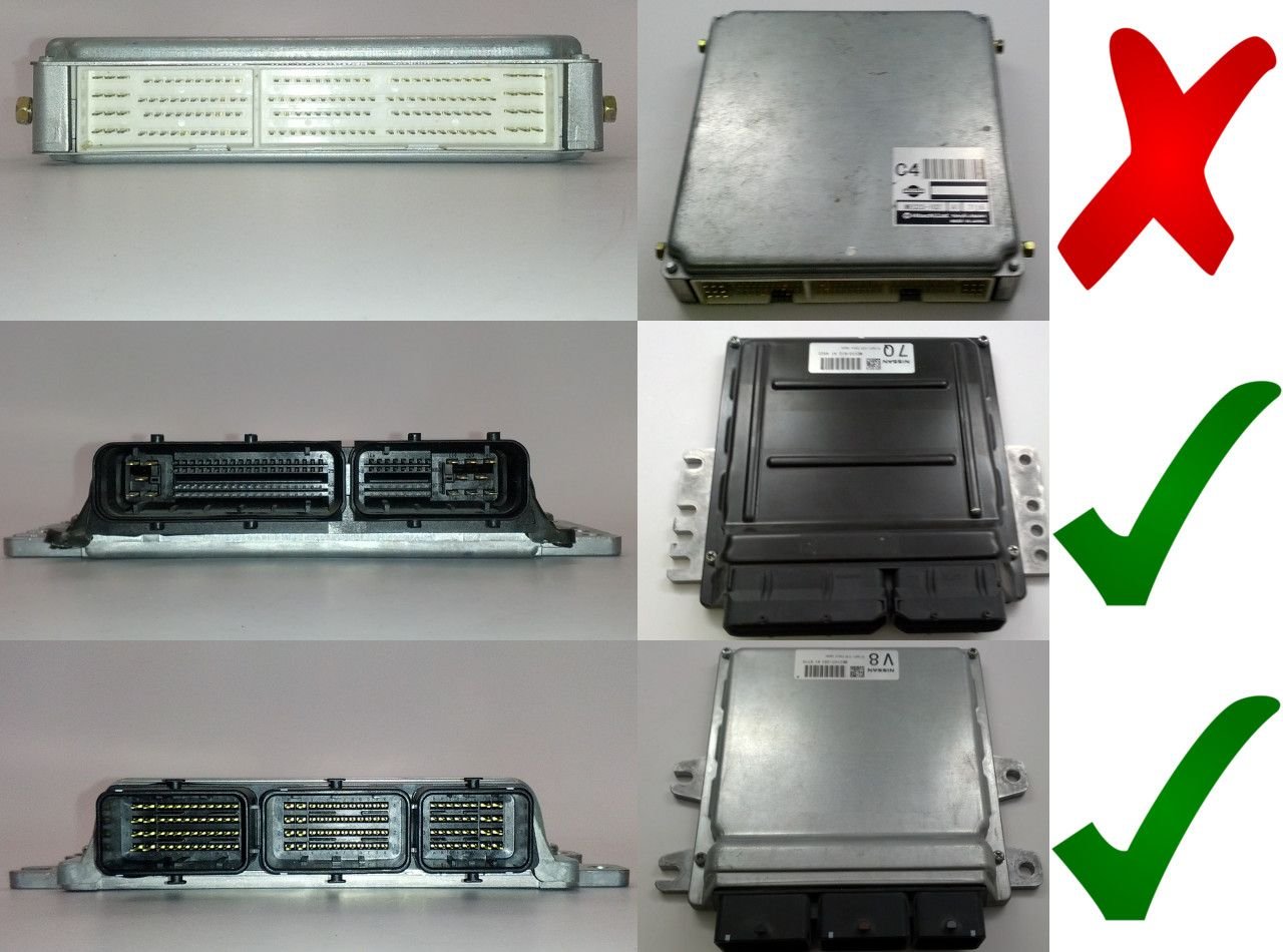

Sounds like you've got several issues going on, but P1615 is definitely NATS (the immobilizer). A NATS malfunction will give you a crank no start, but has nothing to do with how fast or slow it turns over. Sounds like an intermittent fault right now but it will get worse over time and eventually leave you 100% stranded. We can completely bypass NATS with an Uprev flash and make it a lot more fun to drive, fix the factory throttle restriction and really open it up. Even on a completely stock G35 the tune makes a huge difference.
Bigger issue is if your ECU is even tuneable or not, the early 03 sedans have an old version of the Nissan ECU that we cannot flash. Passenger side kickpanel, take a look and see which one you have.
