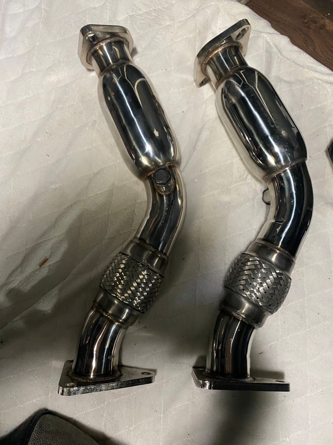

I have a infiniti g35xs 2008 AWD and I'm wondering if a g35 2003-2006 test pipe will fit on it
Thank you to whoever responds
update,
are the pictures below for a rwd or awd?
Old May 10, 2025 | 09:29 AM
G2B35AGN's Avatar
Joined: Mar 2013
Posts: 2,004
Likes: 390
From: Raleigh, NC
Very likely no. AWD transfer case will almost certainly be in the way, even if they did fit the HR motor.

Let if you want to sell them lol shoukd fit my 04 coupe ? These are resonated right?
Old Jun 1, 2025 | 11:46 AM
Siknin's Avatar
Joined: Oct 2017
Posts: 76
From: Virginia
04 TB G35 coupe 6mt w' Brembos
No, they won't fit. DE/revup test pipes wont bolt to HR headers because they have a different bolt pattern and shape. You have to use the HR testpipe version with your 08 sedan.

huh? Im cunfused. Let me make sure we got our info correct. So i have a 2004 G35 Coupe that has the DE motor in it. Will rhay fit?
Old Jun 14, 2025 | 07:56 PM
Siknin's Avatar
Joined: Oct 2017
Posts: 76
From: Virginia
Yea you are good, the test pipes the guy posted will your 2004 G35. I was just saying why they would not fit his 08 G35x
