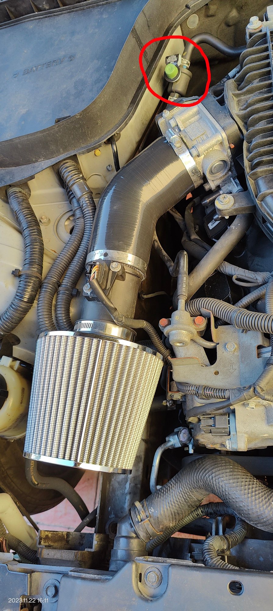

If your fuel damper don't look like mine (dry) then pop it off and replace the o-ring. Also check the hose going to it, could be leaking at the crimped connection..

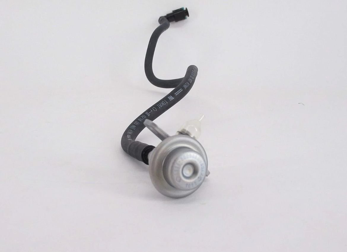

My fuel damper doesn’t look like what you circled , it looks like this ;
the O was covered in what looks like fuel , light brown color

What i circled above was EVAP valve..
this little guy has a rubber o-ring (under that "condom" looking thing in your picture) that could've failed. clean it up real good and then start it first thing in the morning, then go and look and see if it's leaking any fuel. pretty common for these (o-rings) to fail.

The FPR (fuel press reg) is inside the 'fuel module' meaning part of the fuel pump assembly inside the fuel tank. Pop the cover under rear passenger seat and you'll see the pump. That would not cause any fuel vapors to enter the cabin unless the fuel tank cover holes have blown seals which would leak fuel outside the fuel tank and/or body covers not sealing properly (covers under the seat).
