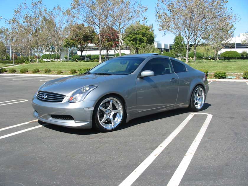

Here's mine..Volk Sf challenge Mercury silver...9.5 front 28 offset
10.5 rear 23 offset...fits perfectly
