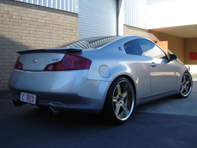

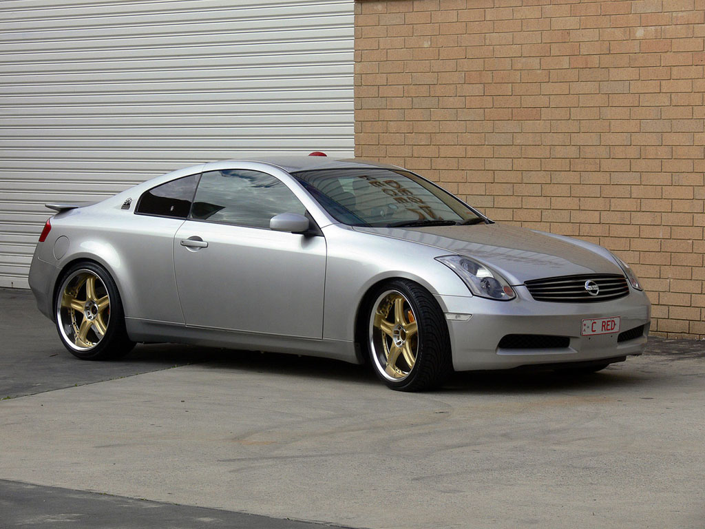

Have finally done some work to the 35...
Volk GT-C 20x9.5/20x10.5
Tein CS Coilovers
3.7 Final Drive (From a GT-8)
Whiteline Sway Bars
Full Borla Exhaust including extractors - note to other RHD Skyline owners - LHD extractors rub on full lock...
Still waiting to install the NOS and the UTEC. Have also just started cobbling the bits for a single turbo conversion together...using mostly Nissan Parts...
Jash

what is the offset on those, do they rub and do they clear bbk?

+20 front - +18 rear. The fronts catch slightly on standard guards. I really should have rolled them before we put them on...The rears havent touched at all - as yet.
Forgot to add - we've also reversed the shift pattern on the manualmatic. now you pull the stick back to go up a gear, and push it forward to go down a gear - just like it should be...
Jash

Old Jul 11, 2006 | 03:08 AM
c-red's Avatar
Joined: Jan 2006
Posts: 27
From: Perth - Western Australia
Here are some more pics - Nice and sunny for the middle of winter here...
Jash
