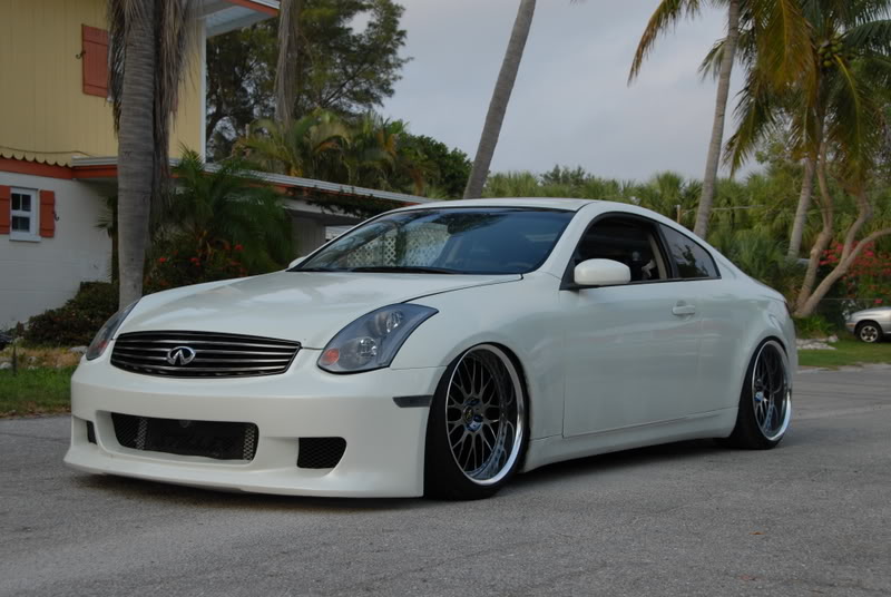

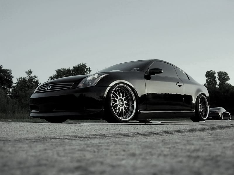

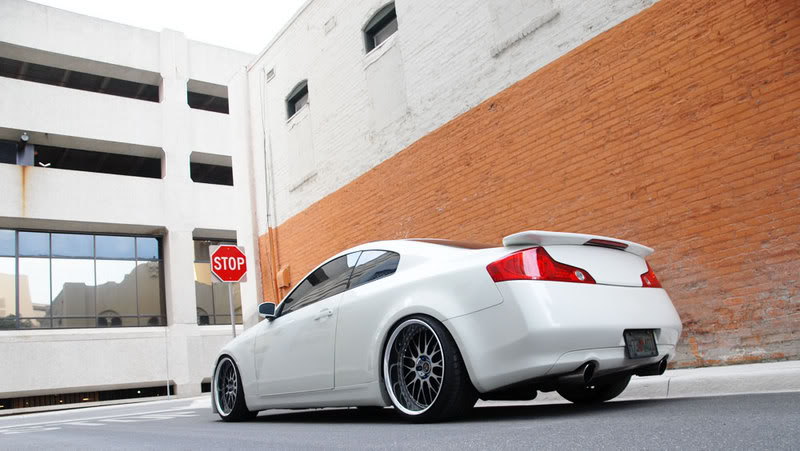

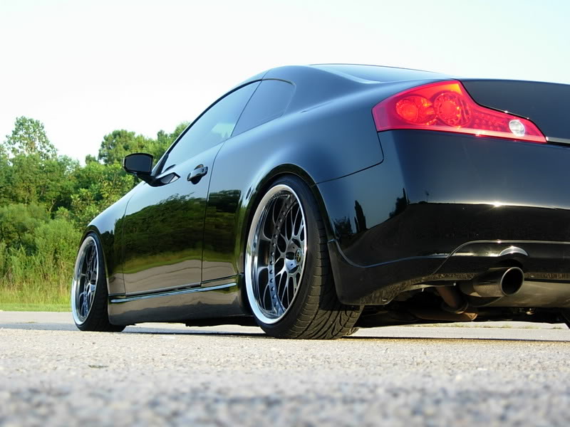

By any chance does anyone have a g35 coupe with work vs-xx in 18s or 19s aggressive stance and width + offset.

quick search for vs xx brings us
Name of Rims: Work VS-XX
Rim Size: 19x9.5; 19x10.5
Brand of Tire/ Size: 255/35/19 Pilot sport A/S; 275/35/19 Toyo T1R
Offsets: +3 F +4 R (25mm spacers all around)
Lip Sizes: 1.5 F 4 R
Camber: -2.1 F, -4.1 R
no stretch but aggressive and clean
also from this thread
https://g35driver.com/forums/media-s...ork-vs-xx.html
robzone
Surfquikslver
Bashar368

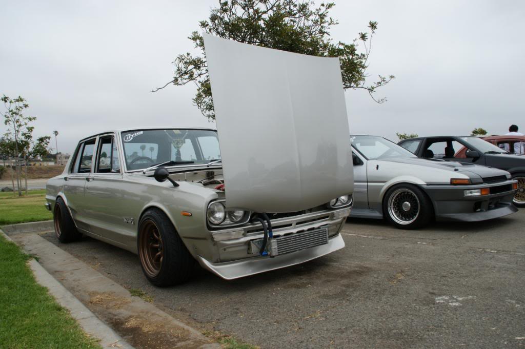

lol i kinda stopped there as well
this is an old school skyline, no?

^ yep 71 I believe.
