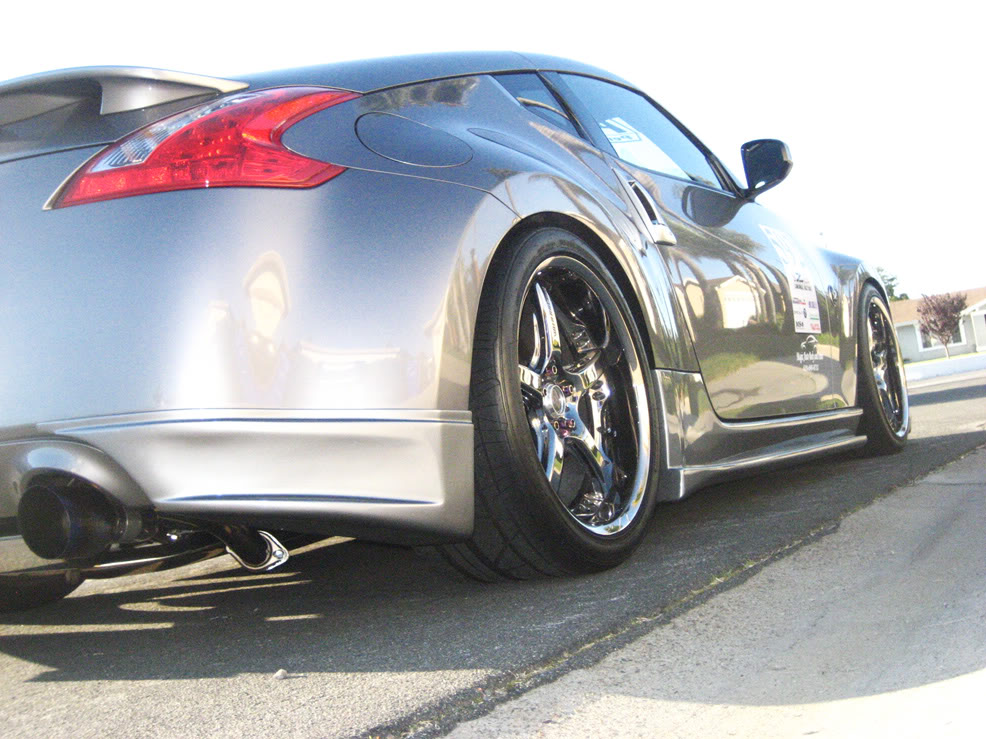

^ Obsessed, Jookyshank is correct, the reason I need more traction is not due to improper suspension ( I have bc coilovers, sway bars, camber arms), but due to the low end torque that I'll have to deal with once I do the LS swap
I found some pics of 305's on the Volk GTSs.
By the end most ppl are running 255/35/19s with their 305/30/19 rears

Polished faced GTS's…..so sexy
