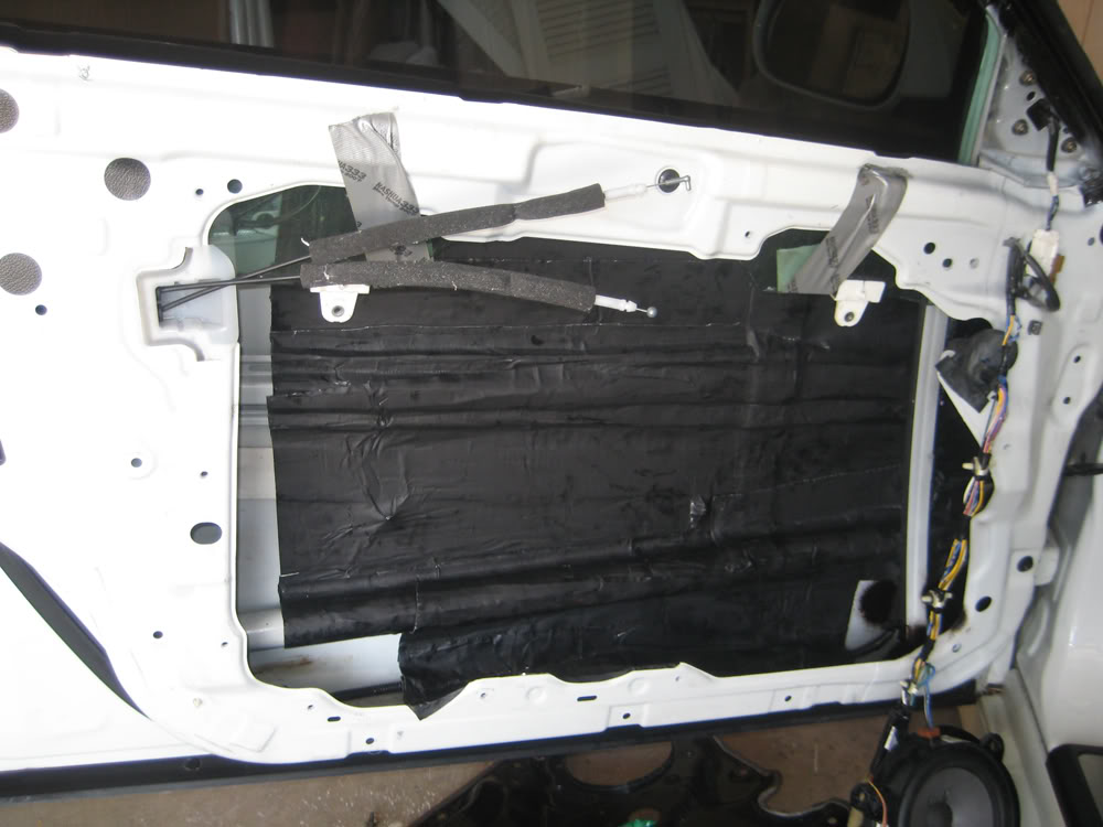

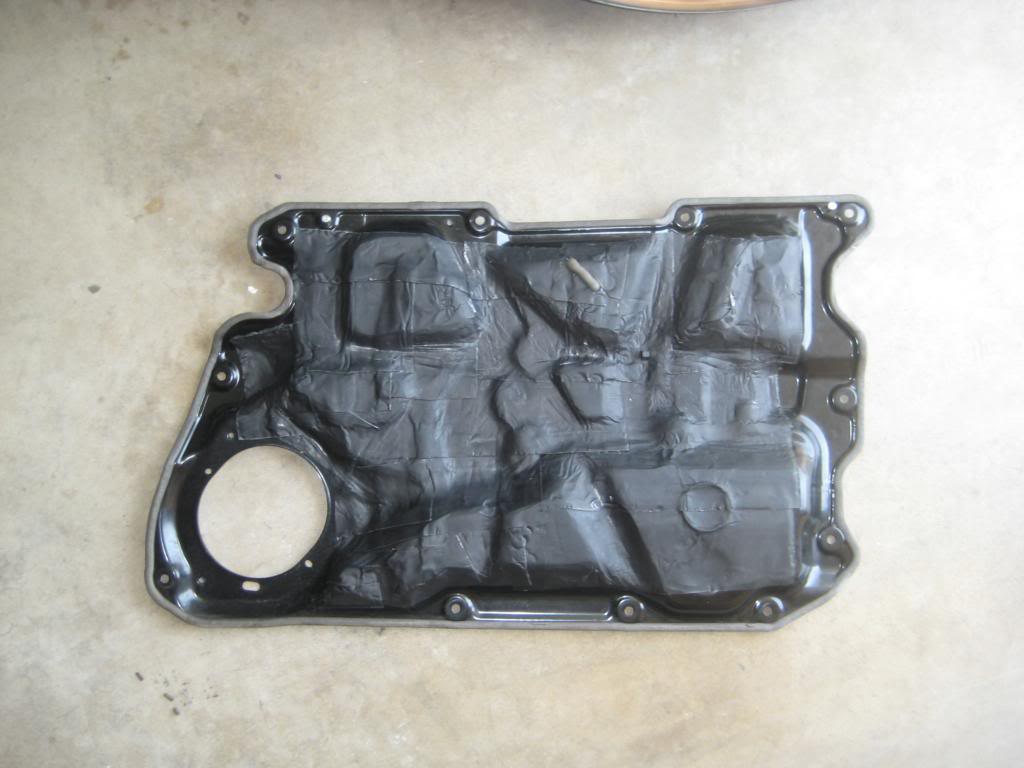

May 14, 2010:

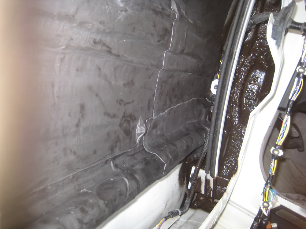

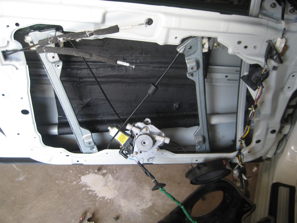

Started deadening my doors and I will do it as follows:
Inner part of door: 1 layer Damplifier Pro, 1 layer Overkill Pro
Inner black metal sheet: Same as above
Outer black metal sheet: 1 layer Damplifier Pro, 1 layer Luxury Liner Pro
Outer part of door: Same as above
Some areas are tough to get to so I'm using rubber undercoating (what you spray on the truck beds, and Spectrum.

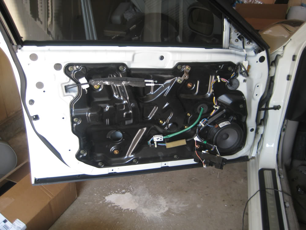

Untouched door:
Black metal sheet removed and cleaned:
Starting the deadener install:
It wasn't till later that I realized I could remove the two bars to make it easier:

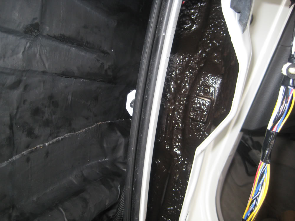

Rubber undercoating sprayed:
What I have done so far:

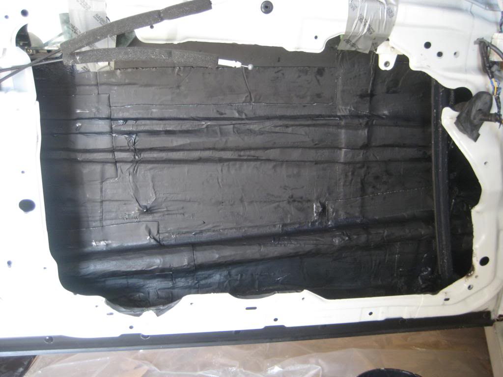

Door completed with Damplifier Pro:
Overkill Pro add to improve midbass:
Spectrum & Rubberized Undercoating Added to get hard to reach areas:

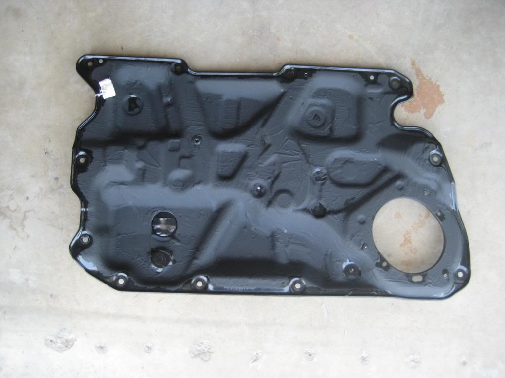

Damplifier Pro on metal covering door shell:

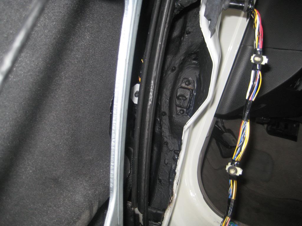

Spectrum on metal covering door shell (facing door panel):
I'll have more updated pics this weekend when I'm done adding the LLP.

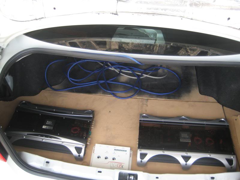

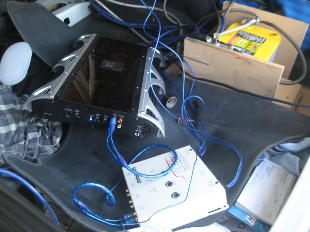

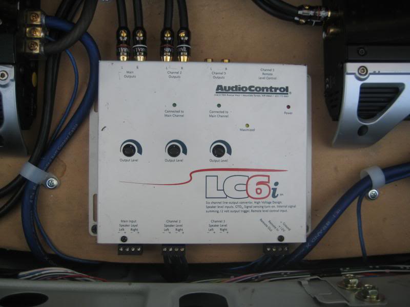

Here's a couple pics, but I have more work to do. Gonna see about hooking up some mids and another amp for them. If all goes well, I'll put everything back together. Found out the cheap Kicker subs I got off craigslist are messed up, so I'm in the market for some other budget subs. Wish I hadn't sold some of my other ones

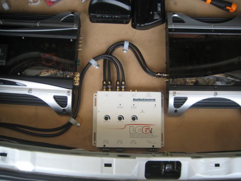

Rather than using a small little LOC I'm using an Audiocontrol LC6i. Got it from a friend and might do some EQ/XO settings with an add on unit, but we'll see. I just need some bass right now. It's been too long without it.

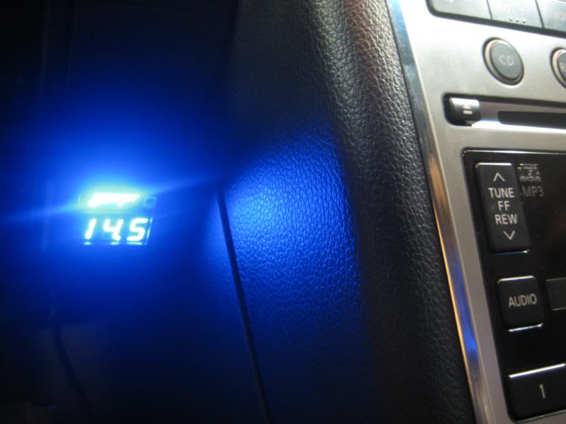

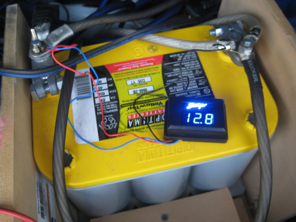

Testing out the Stinger voltage meter. Will be placed somewhere up front that is visible. Will be very useful once I get the full audio setup going on.

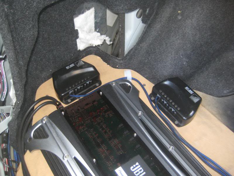

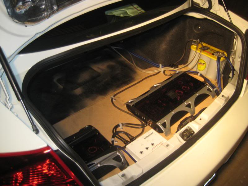

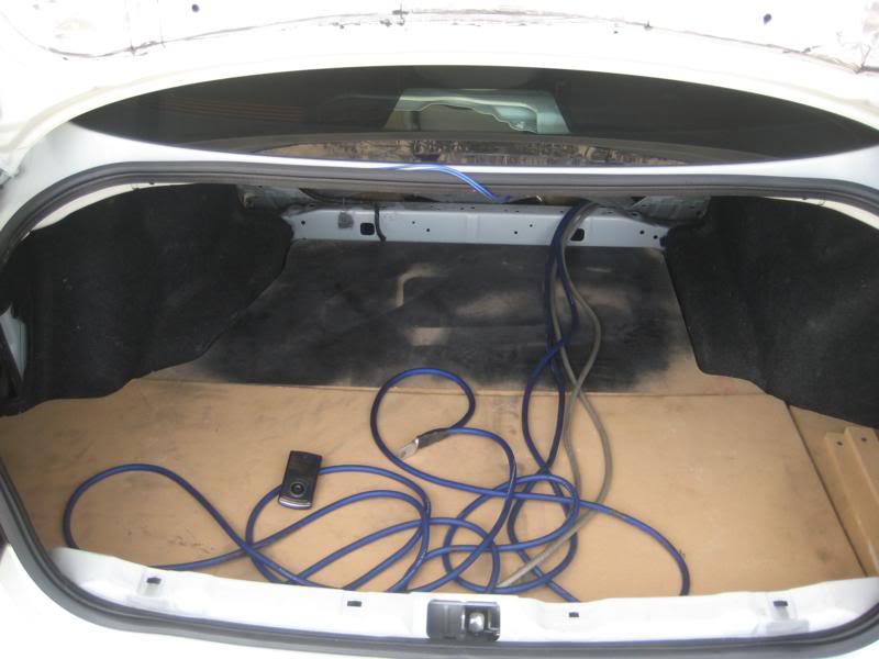

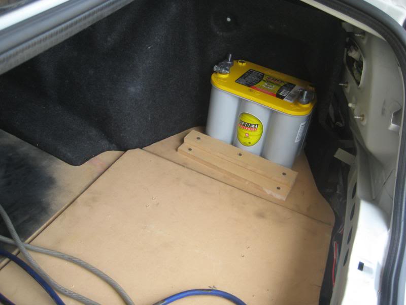

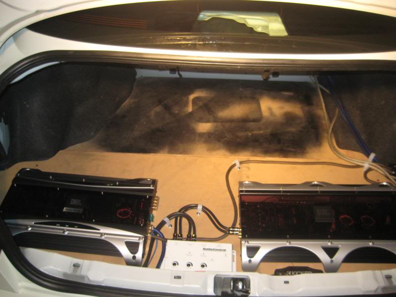

Long ass day. Got pretty much everything wired up. Since I need more wire I'll make baffles for the mids and mount them and the tweeters when I get wire. All that I have to do after that is mount the crossovers in the trunk, hook them up and do some quick wiring to the amps and I'll be done. Still on the search for some decent subs. Anyway, here are pics of what I got done today.
Starting off.....with an empty trunk.

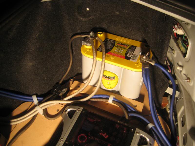

Mounted the battery.

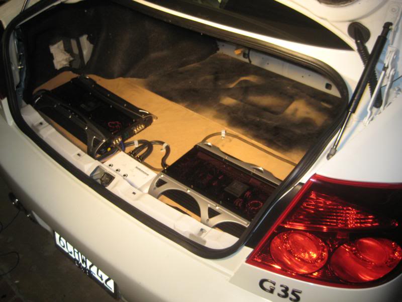

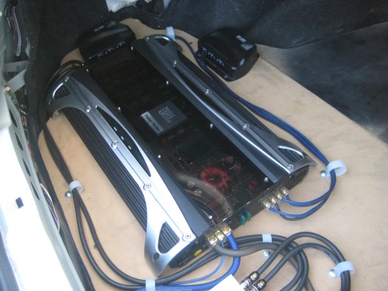

Mounted the amps and LC6i.

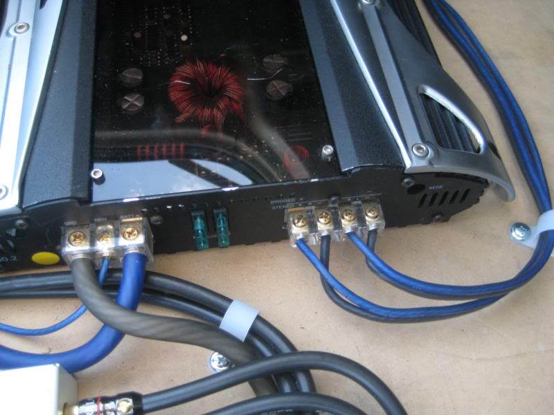

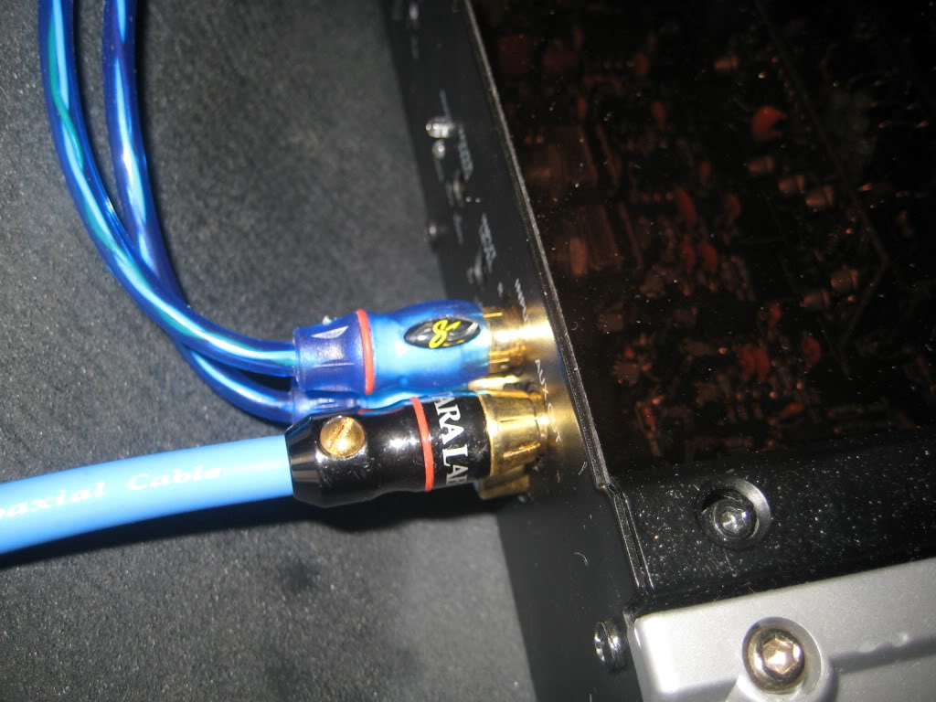

Made some RCA's with Tara Labs RCA ends.

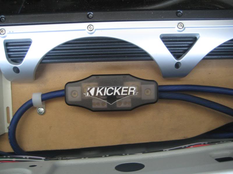

Mounted a ground distribution block next to the battery.

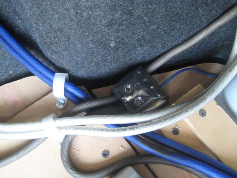

Mounted a power distribution block below the sub amp.

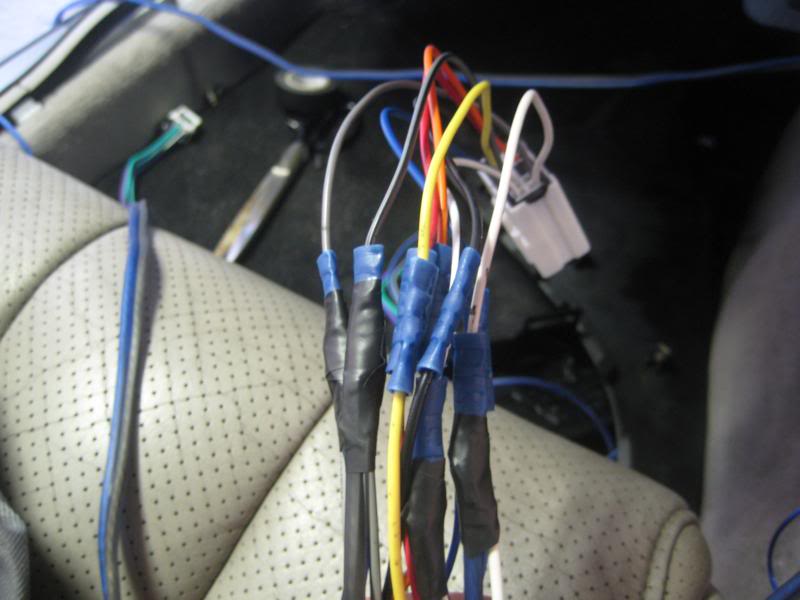

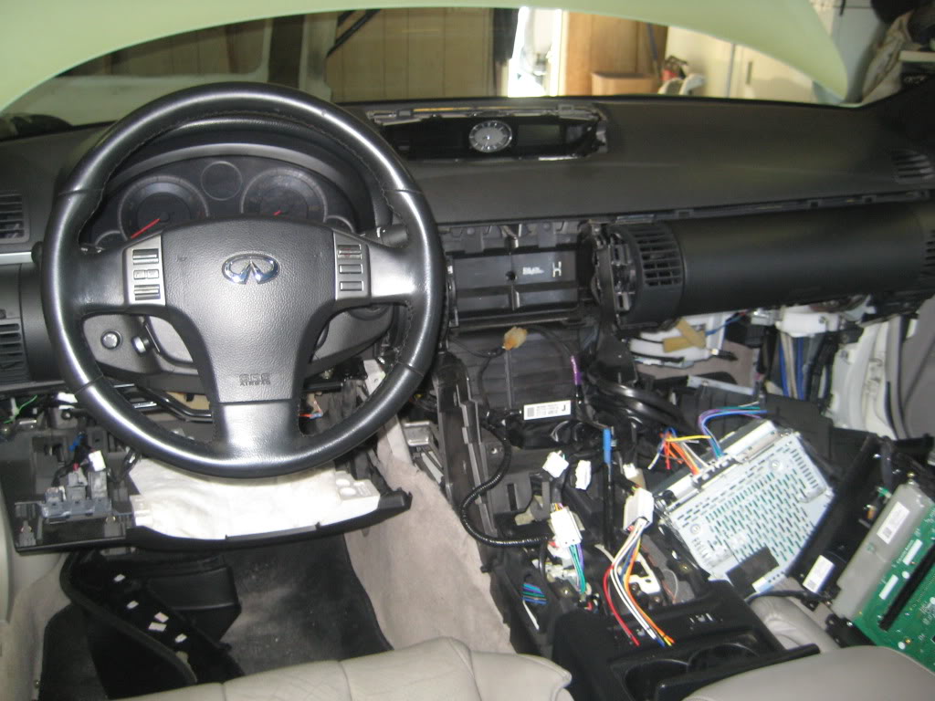

Moved onto the head unit and rather than twisting the wires and using electrical tape, I used butt connectors for a clean install.

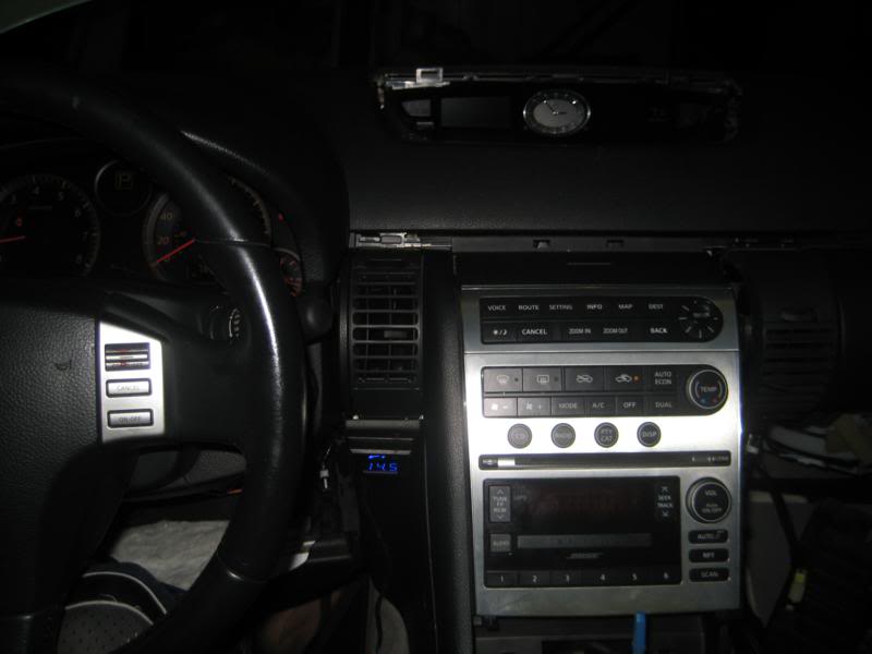

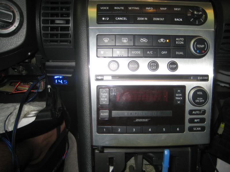

Ran wires from the LC6i to the Stinger voltage meter and mounted it in a location that wasn't distracting to me or the outside and still visible. Batteries run at 14.5 - 14.8V

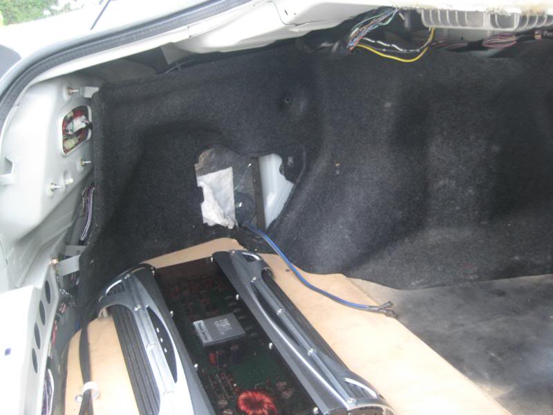

Done....for now.

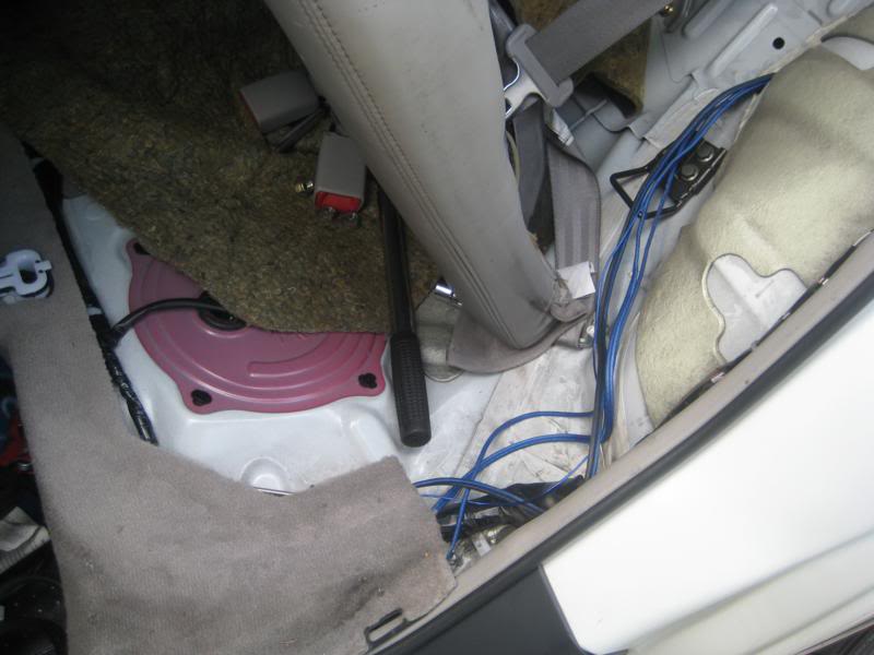

Ran the wires for the voltage meter and the amplifier remote wire from the OEM head unit to the LC6i.

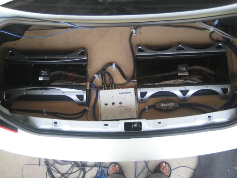

Installed crossovers and hooked them up to amp.
LC6i all wired up.

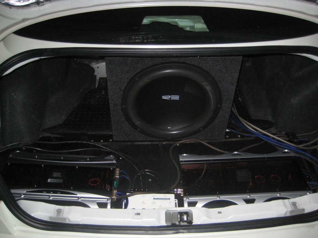

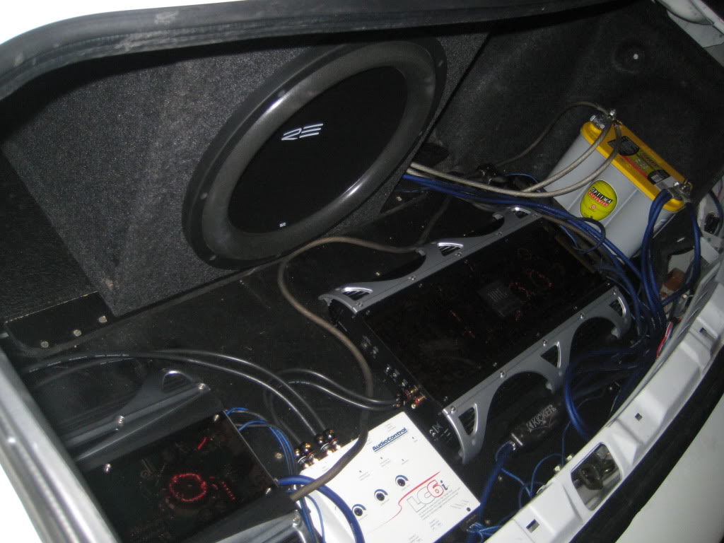

Finally got a sub in. 15" RE SE. Also painted the wood black so it looks a lil cleaner. Barely got the sub to fit in because of the stupid thick foam pieces the car comes with. Had to get a lil creative to get it in, but I got it.
In the vid below I actually turned the gain down quite a bit on both the Audiocontrol LC6i and the amp. It was quite a bit louder before and the rear view mirror immediately vibrated down, and much faster. Sunroof was also flexing quite a bit earlier. Sub sounds like it's rattling but its the old digital camera I'm using. Sounds pretty good though.
