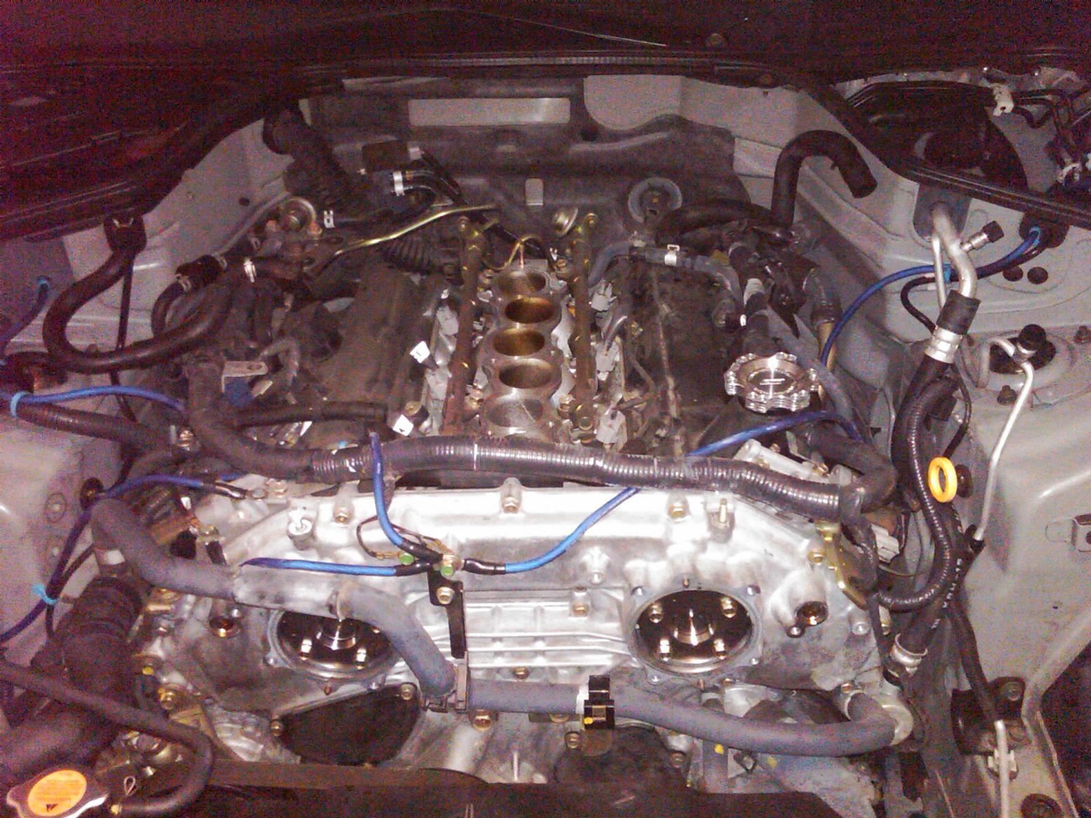

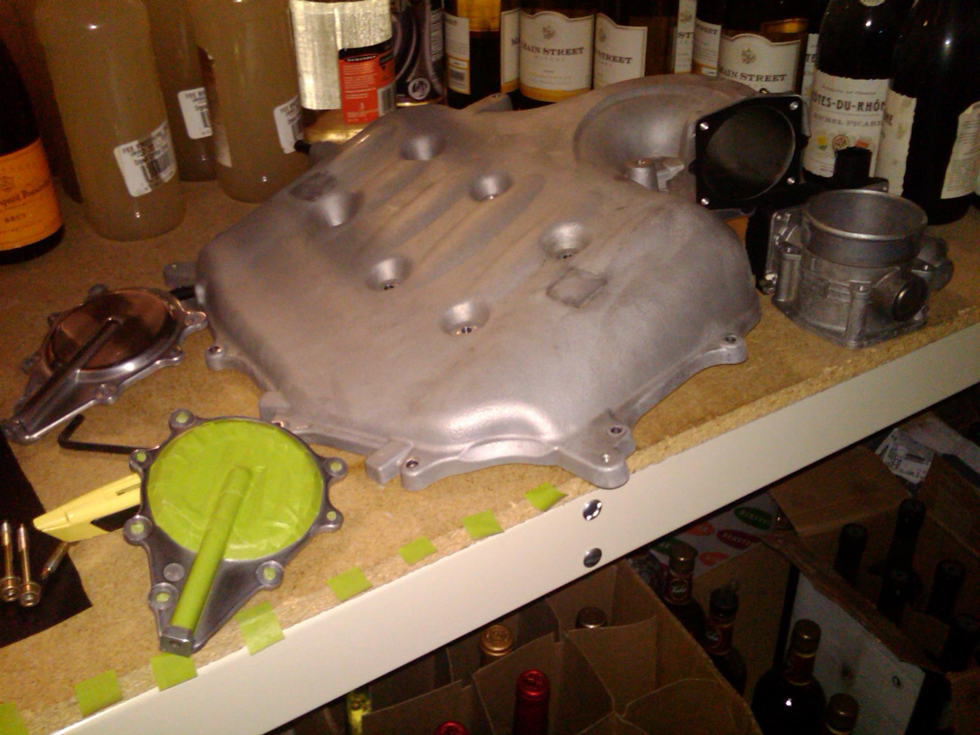

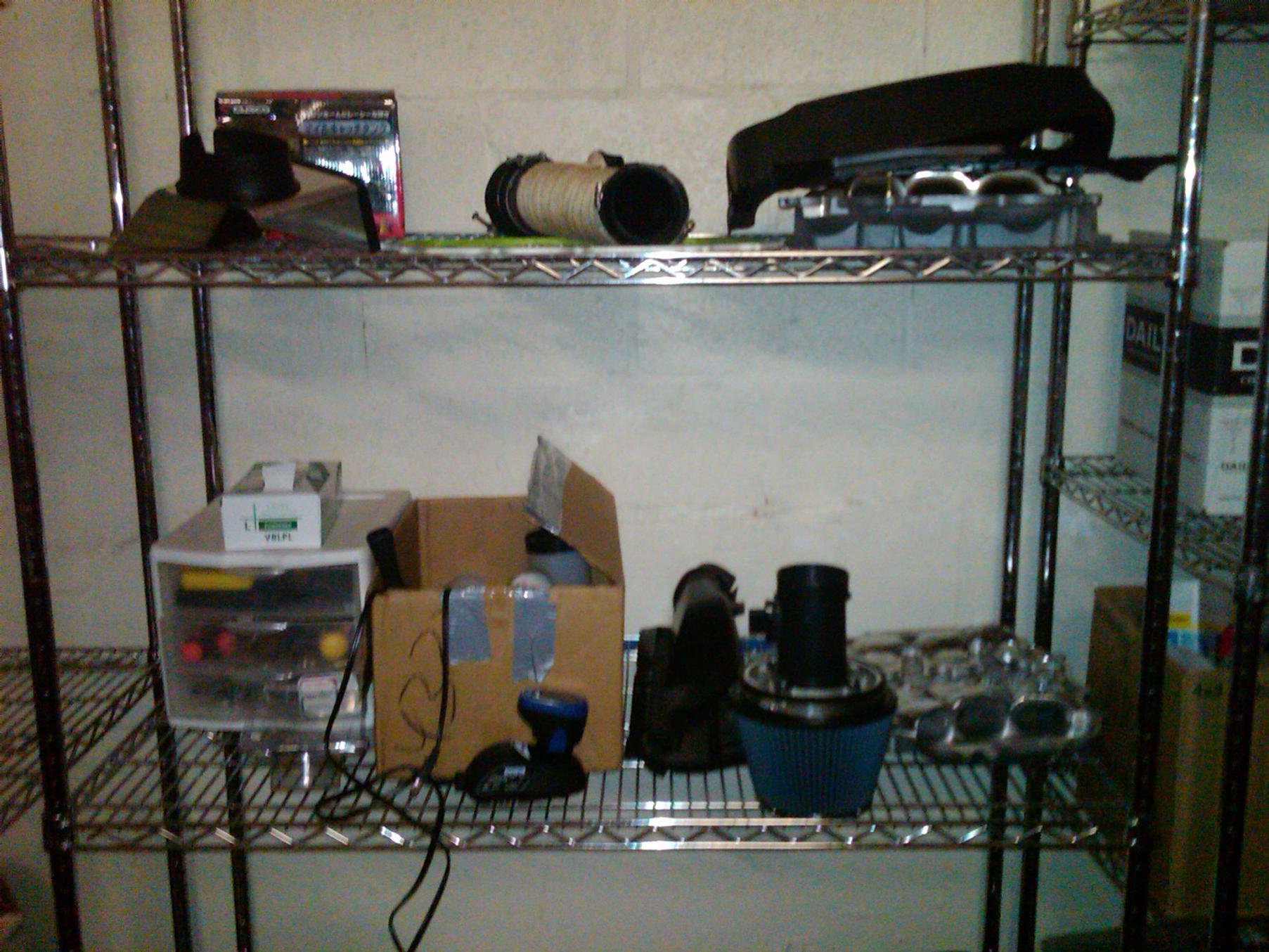

Easy you jackals... Here are some quick pix with my blackberry... Will be powder-coating and installing most of it this week.
Attached Thumbnails JLAW Build Thread-stripped-engine.jpg   JLAW Build Thread-shelved-parts.jpg   JLAW Build Thread-cam-covers-plenum.jpg   JLAW Build Thread-taped-trim.jpg   JLAW Build Thread-restore-black.jpg

So i stripped down the engine of the upper and lower plenum, intake, cam covers and a few brackets and brace pieces.

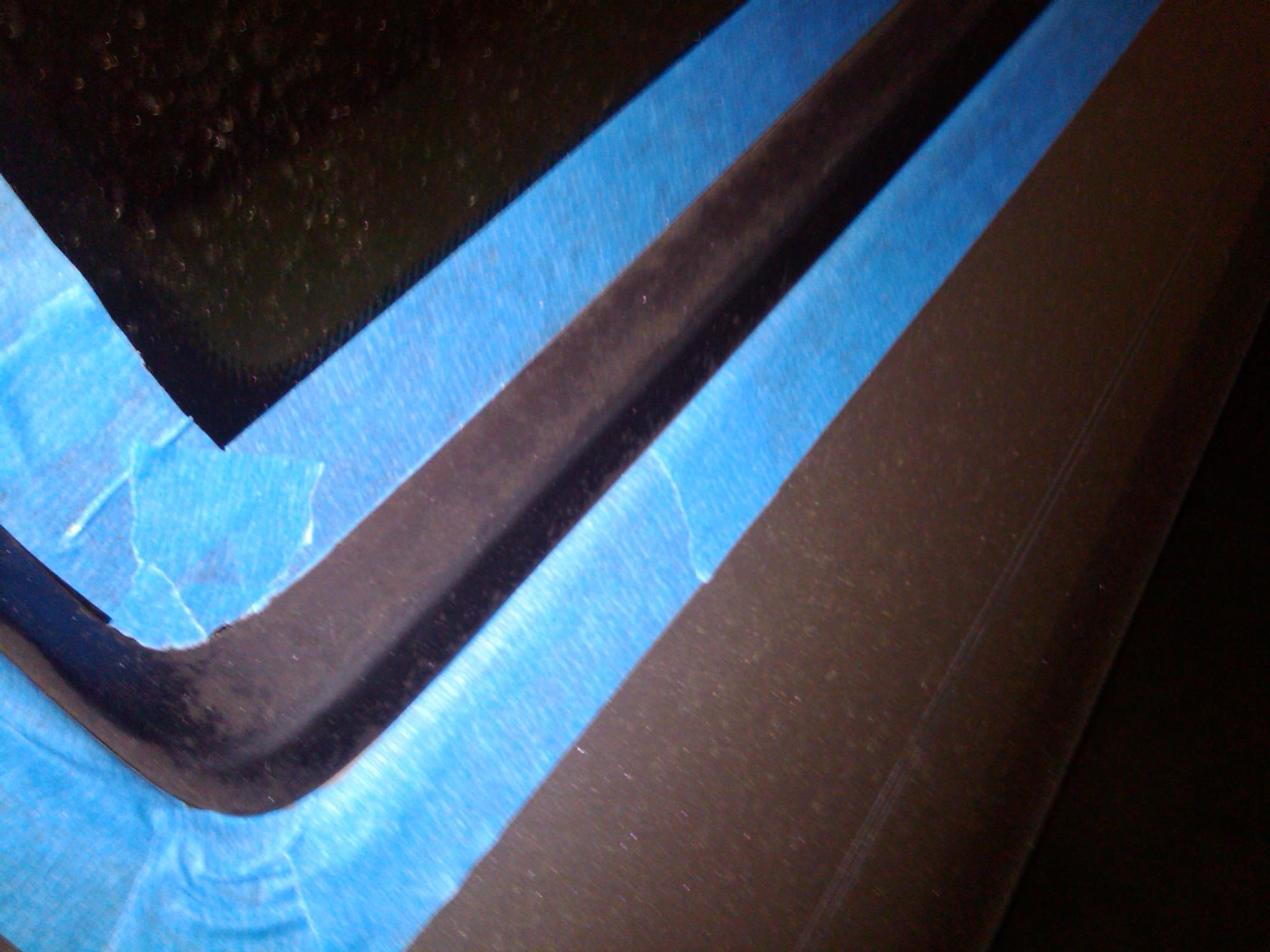

My black rubber trim looked awful from the florida sun even though its an 07 so i taped up the glass on the doors and side panels and my sun roof, wet sanded with 400 grit and hit it with 2 coats of this bondo black restorer, it came out much better but it was hard to get a perfect finish as the product is applied with a sponge and needs to dry, no wiping excess.
I removed my TB to either paint or powder coat if i decide to pop the rivets off to remove the plastic.
Cam covers were polish by hand (80, 150, 220, 320, 420, 600, 800, 1000, 1500, 2000, 2500) then some meguire's metal polish... no joke... i decided that the polished look is boring and will be trying out a new look.

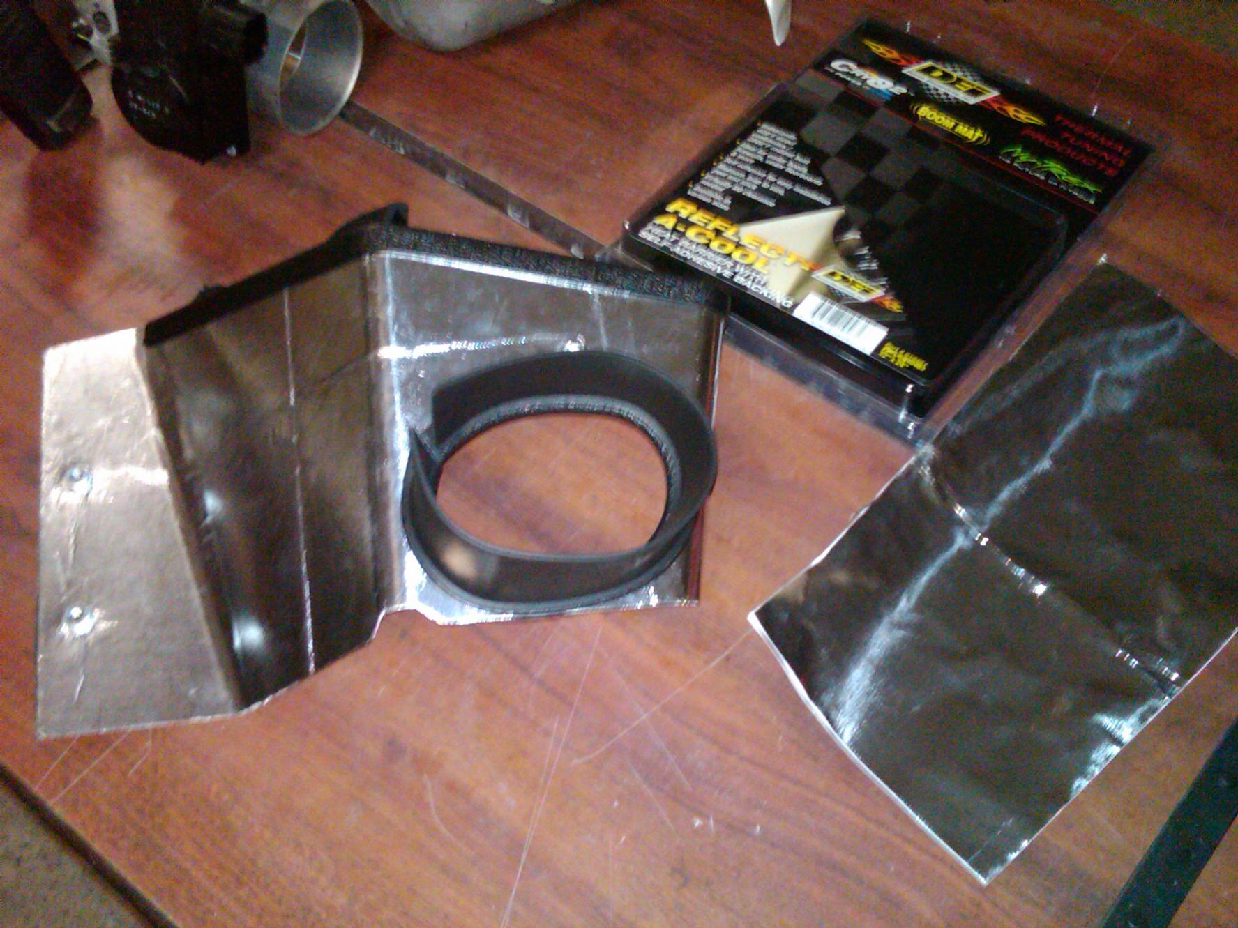

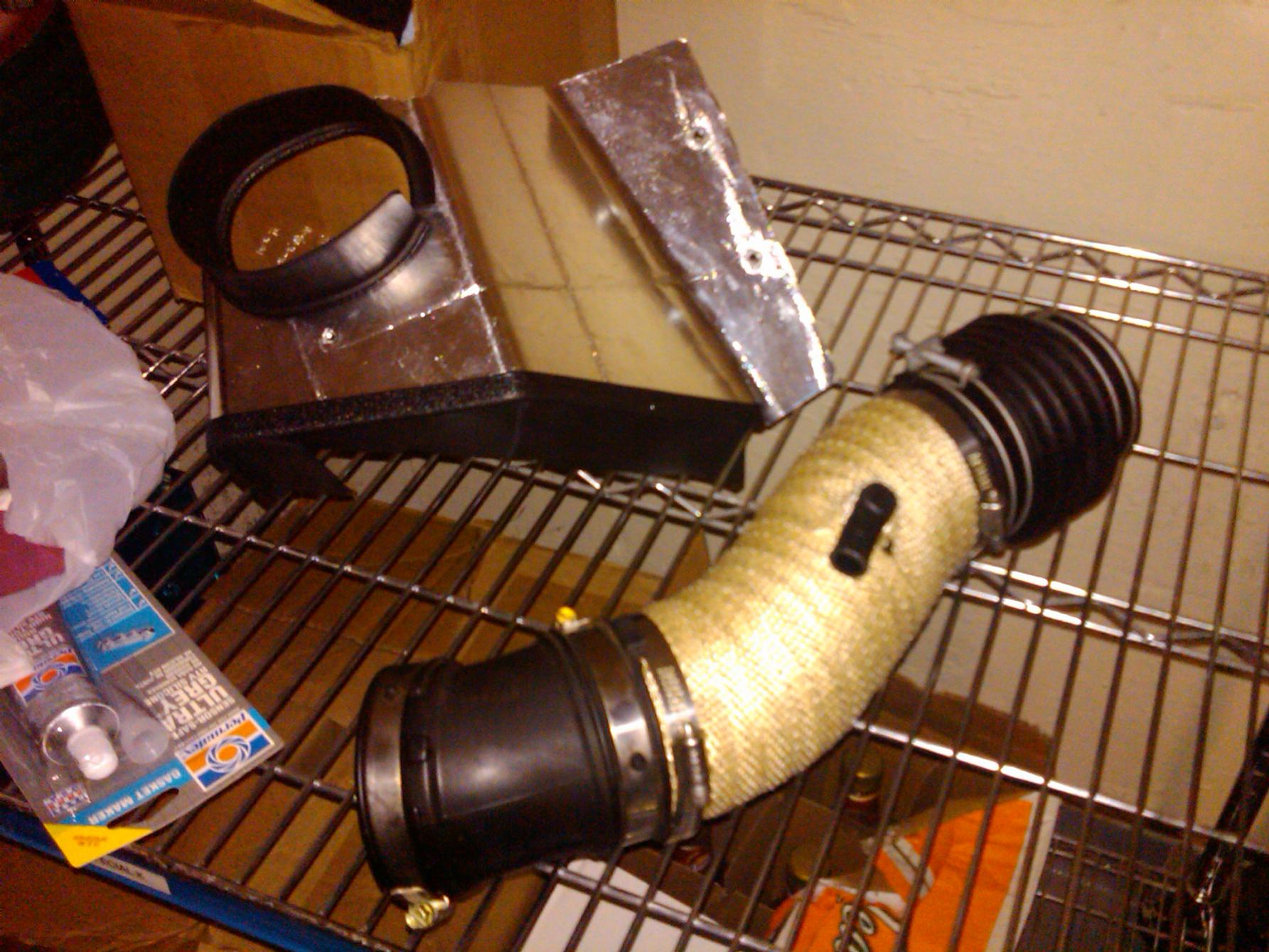

More....

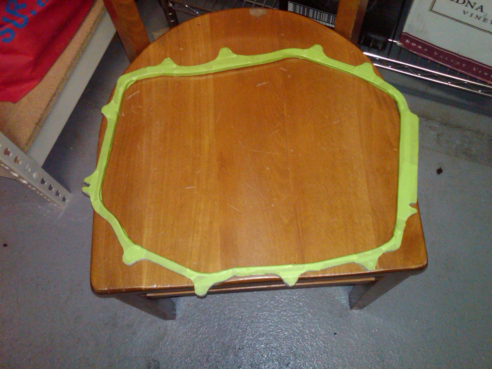

I also was going to polish my spacer but am going to go a different route.
I hit DEI hard and wrapped my pop charger in there heat deflector wrap and used there exhaust wrap on my Z tube.
Attached Thumbnails JLAW Build Thread-heat-wrapped-pieces.jpg   JLAW Build Thread-wrapped-pop-charger.jpg   JLAW Build Thread-taped-spacer.jpg   JLAW Build Thread-taped-spacer-2.jpg   JLAW Build Thread-poor-boys.jpg

If you notice the pix of my upper plenum and MD spacer, i've turned my hotels Liquor room into a garage as it is just off the parking garage, its nice to be surrounded with booze when hand polishing metal and when you drop washers and bolts all over your engine bay.
