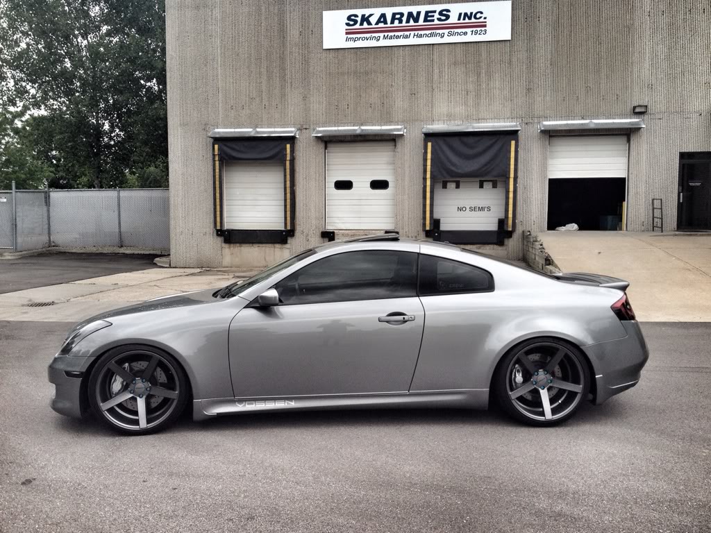

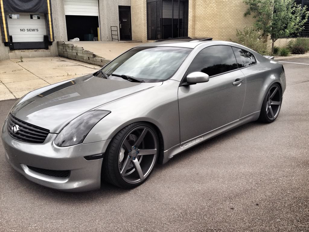

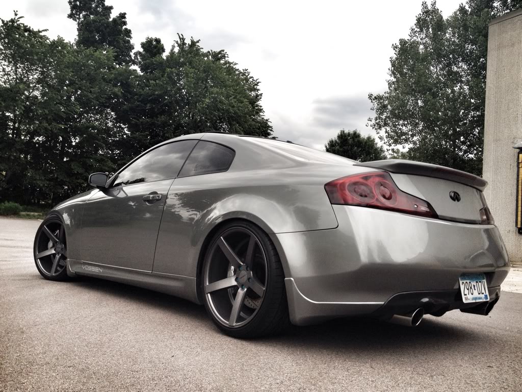

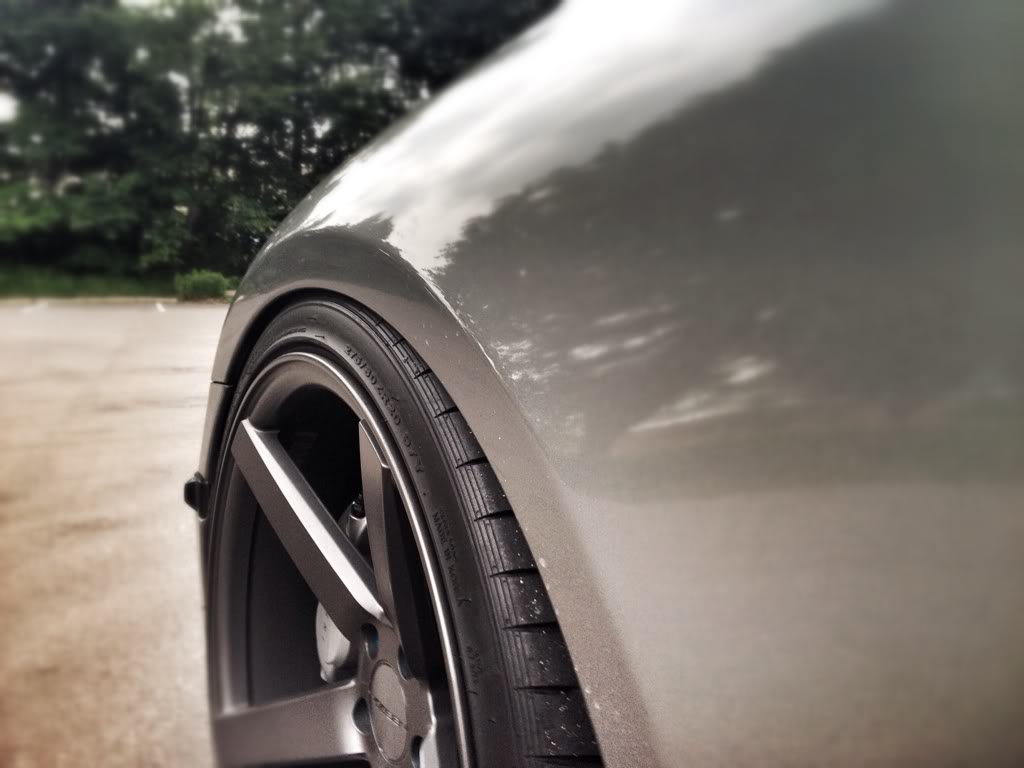

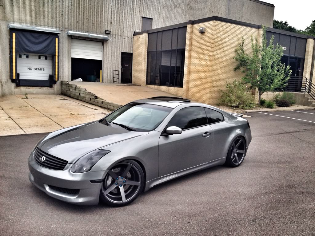

So last night I got bored and wanted to test fit my rear 10.5'' CV3 (+25 offset) up front for some possible plans in the future . After seeing VossenG37S in person with the 10.5'' CV4 all around I fell in love. It is such a mean look with concave on all fours, and it is still VERY functional. We were in NC/TN two weeks ago on Tail of the Dragon and I can tell you it didnt affect his ride one bit!
I am running Hankook V12 275/30 for tires and running -1.8 degrees camber and had some rubbing turning (I am fairly low on KW Coils as well). If I do ever want to do this set up I plan on running 265/30 on either falken 452's or some generals to lose some side wall. Here are the pics, enjoy

Mmmm akebonos!! Wheels and brakes look good together!!

Thanks guys! The akebonos are quite the upgrade from stock. Def glad I had them on tail of the dragon. The guys running stock brakes were smoking like crazy after we finished up!

So that pix was a +25 front and rear? Looks tight up front...no spacer? and only fender rubbing issues? Are you able to turn full radius? Anyways it looks pretty dang good so I might have to join the club.

Yep you are correct. It's +25 all around, I plan on getting a +15 offset rear and then +25 front if I decide to do this for my next set up. My beefy tires are rubbing on the inner part of the fender but I can turn in full no problem. Running a tire with a smaller sidewall and a 265 should eliminate the rubbing I have now. I can always run more camber too

rear needs spacers. it dont look wide at all.............

I believe he swapped the front and rears to test fit the rears in the front....

Front and rears are both 10.5'' w/ a +25 offset. The rears are slightly tucked, I just got my fenders rolled so I can space them out 10 mm now
