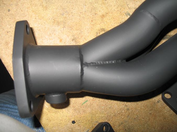

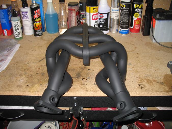

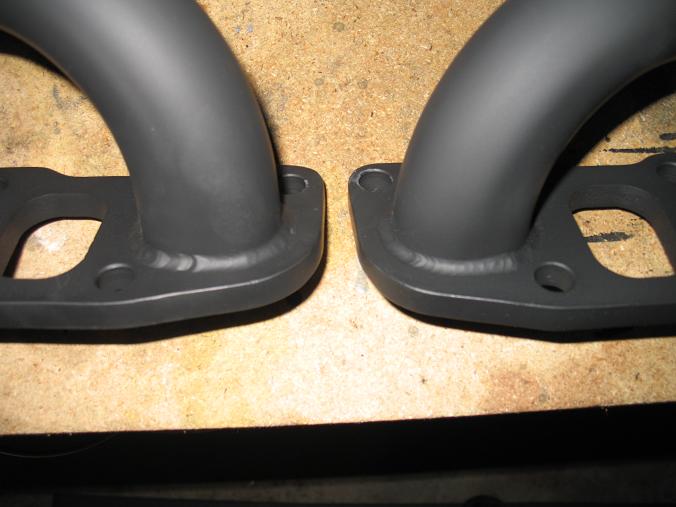

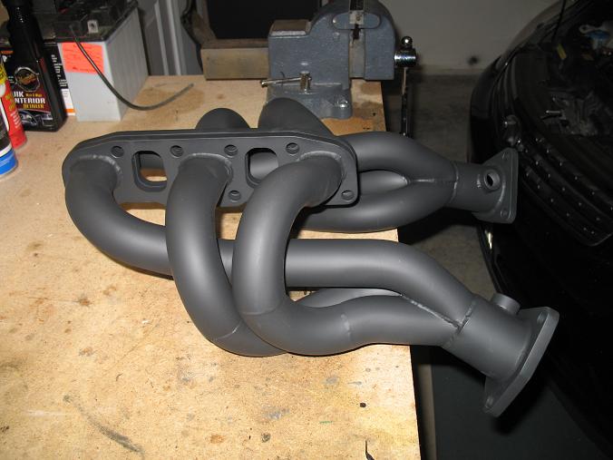

I decided to take a look at these. For $314 and stainless, they look pretty well constructed. I measured the pipe lengths and they are within .75" of being equal. Should flow much better than OEM.
I decided to ceramic coat them to reduce radiated heat and any chance of corrosion. Going to install in the next week or so and will dyno with pre/post install #'s

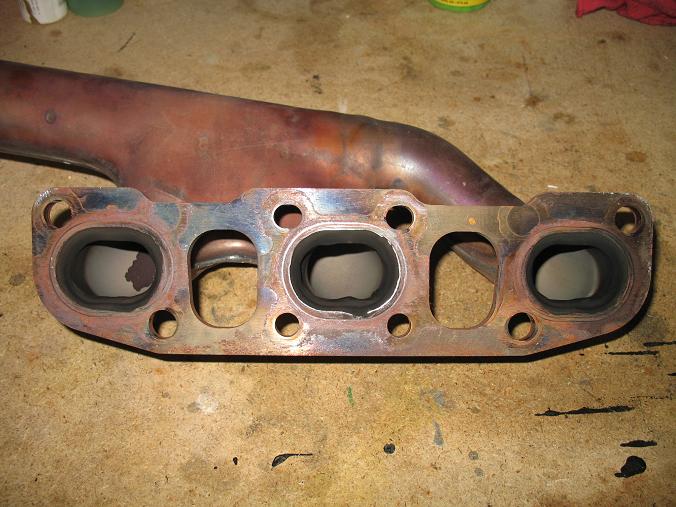

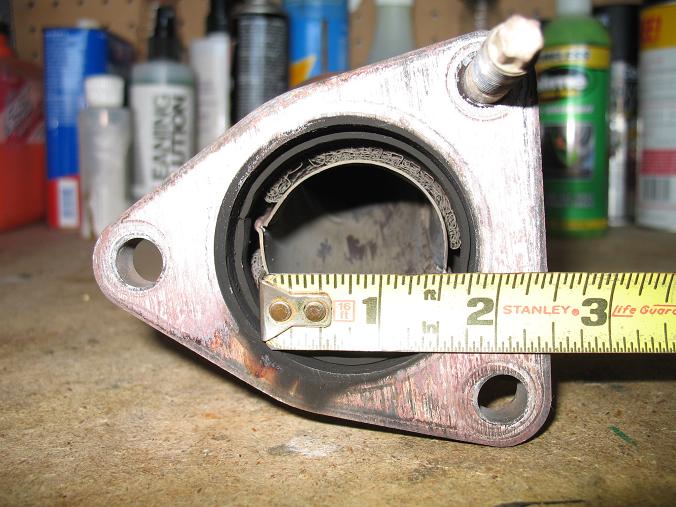

Got them installed today. Was a 5 hour job for the installer. Very tight in there with lots of stuff to move and get out of the way before you can even get the old manifolds out. Glad I didnt attempt this myself with jackstands. Even my mechanic said he didnt know how anybody could even do it without a hoist.
Impressions? So far, so good but havent really been able to get into it too hard because the coating needs a few heat cycles to cure before you subject it to full throttle temperature. But I can already tell the midrange pull is much better and it just revs more quickly. Hard to explain, but the exhaust actually sounds more mellow and smooth than before. If you look at the pix, you can see how restricted the stock manifold exits are. Only 1.5" diameter (1.76 sq.in area)! The header collector is 2.25" (3.97 sq. in. area) or 2.25X the cross-sectional area of the stock setup. Ill dyno next week to see if they actually do anything for power.
