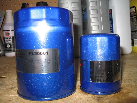

Now that the car is out of warrantee and don't have the dealer service it anymore, I wanted to make changing oil easier. This relocation kit is pretty nice as all I have to do is snip some tie wraps and pull it up and out instead of crawling under and taking off the cover.
http://www.jegs.com/webapp/wcs/store...14813_-1_10467
It also allows the use of a huge filter that must have 3X the surface area of the stock one and increases oil capacity about 3/4 qt. With the 5W/40 turbo diesel oil and pureone filter, I bet I could go 20000 miles on a change.
I'll do an analysis at 10K just to see where it is, but it should be capable of at least 15K with filtration like that.
Recommended for turbo/supercharged applications as the high oil flow is a good thing.
Attached Thumbnails Big filter-oilfilter1.jpg   Big filter-oilfilter2.jpg   Big filter-oilfilter3.jpg   Big filter-oilfilter4.jpg   Big filter-oilfilter5.jpg

I thought about a Remote Mount kit as well. Does the standard single mount kit ($45.99) work without any other adapters?
I see you zip tied it beside the power steering reservoir. Would you be able to just mount it below the coolant overflow tank. That way, it's just one bolt to remove for the tank to get to, and it would look a bit neater.
It says it now uses a Fram PH8A or equivalent, so I'm assuming you could use a K&N HP-3001 or Mobil One M1301?

I just called Jegs, and they told me that they don't have an application listed for the G or Z. Did you just use the standard 771-10695 Single Mount Kit ?
I looked into a better place for this, but its pretty cramped in there. I did this mainly for the extra filter size, so I thought about mounting it on the engine crossbrace down below (driver side) above the cover. But then I thought how nice it would be to just grab it from above. The coolant resv. may work, but its still really tight. Zipties dont look so good, but I'm the only one who looks in there anyway.
Any filter cross referenced to the PH8A will work (3/4-16 thread). The PureOne is what I always use, so the 30001 was the equiv. of the PH8A. And yes, I bought the single-mount universal kit. There are about 5 different adapter threads in the kit that mount the block screw-on piece. You just have to find the M20x1.5 one and it threads right onto the motor. Good luck.
Thanks, I'll look into it.
I'd love to be able to just open my Fumoto valve to drain the oil, and not have to remove the cover each time to remove the filter. Also, if you orient the filter so the open end is up when you remove it, there would be minimal drip and mess.

Originally Posted by ttrank
I wonder if it could go anywhere else. My catch can is mounted right there.
I didnt see any other place that was open. If you are doing this mainly for the larger filter/flow, then it will definitely go along the driver side of the engine crossbrace. You will have to drill 3 holes in it to mount, but it will be very clean, solid, and protected by the lower cover.
The other option is to mount it by the radiator. I kept that spot open, because I plan to mount another one of these filters inline with my transmission cooler line before it goes into the radiator. Should grab all the fines out of the ATF fluid and make the unit last much longer. Should have done this long ago.

Originally Posted by Q45tech
If 2/10ths [99.8%] are passed how long does it take to accumulate enough to bridge the clearance gap? A month? A week?
I won't speculate or argue the point further. What I do know is that the filter I have now has 4.25X the surface area than the OEM. I like that and I think the engine will too.
