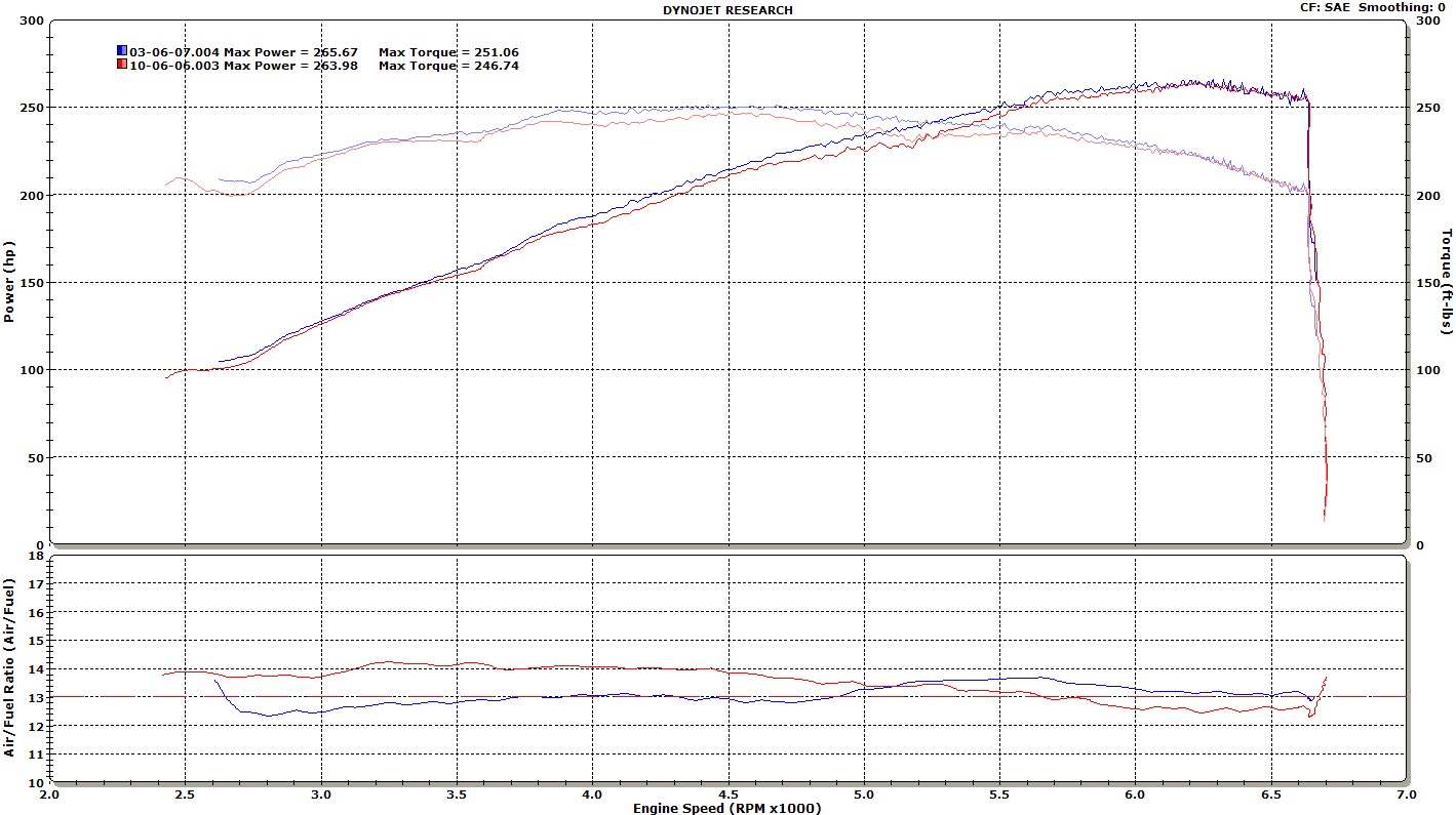

I attended a concert in Atlanta this past Friday evening, and had Sharif install and tune a utec the following day.
Last summer, my car put down 240hp STD on his dyno dynamics. At the time, I had a stillen airbox, ztube, mrev, crawford cats, and stillen sedan exhaust. My best baseline run on Saturday only put down 237hp STD; this is with a new longblock(~1500 miles), kinetix resonated test pipes in place of the crawford cats, and ichiba headers. After a couple of hours, the best Sharif could get out of the car was 246hp STD.
Keep in mind this is on a dyno dynamics. I'm not going to discuss the differences amongst different vendors' dynos, but I gotta say this dyno is pretty slick. I particularly liked the air intake temperature probe. But regardless of the technical aspects of the dyno, it doesn't produce nice graphs like a dynojet. It does support the export of pulls to text files, but we couldn't get that option to work. So you guys will have to be satisfied with dynojet carts and analysis.

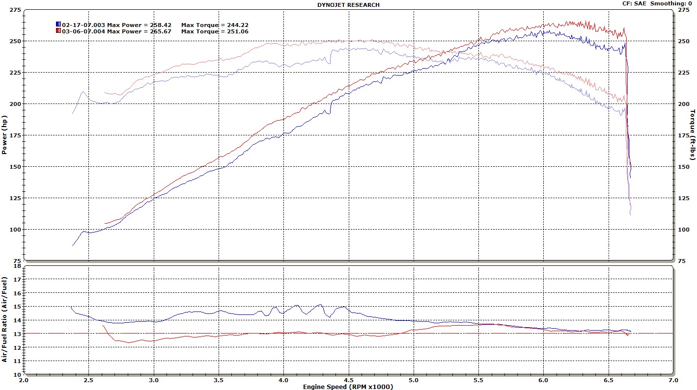

Two weeks ago I dyno'd the new engine at my local dynojet, and it put down quite a bit less than my old engine with fewer mods. I started a thread with charts for that session, and it can be viewed here.
Today I went back to the local dynojet. I had an idea of what the numbers would be like, because of the ~9hp gain at Sharif's shop. But I've dyno'd most of my mods on this dynojet, and wanted to get some numbers in a form that I could use for more in-depth analysis.
When I dyno, I usually perform the first two pulls in 4th gear, then the last in 5th gear. This allows me to see the curve all the way till redline, and the last pull I use for peak numbers. Unfortunately, for the revup sedan at least, I can't pull 5th all the way till redline because of the factory speed governor.
My new numbers are 265/251, compared to 258/244 from two weeks ago. Contrast that with the 263.98/246.74 that my previous motor put down last October(no headers, and no utec).
I have attached two graphs. The first plots my most recent run against that of the new longblock baseline of two weeks ago. The second graph plots the most recent run against the previous motor's best back in October. Today's 5th gear pull is red in the first graph, and blue in the second.
The gains at peak are short of what I was hoping. But honestly, I did pick up quite a bit in the midrange. The tune gave me the power that everybody else got from the mrev+(for those of you that haven't followed the path of mods on my car, I saw just less than half the gains with the mrev+ than most others have reported). For example, 3k rpms sees a gain of 6tq. 3500 shows 13tq. 4k rpms, almost 15. Plus, horsepower isn't dying off past peak as badly as it was two weeks ago.
I exported the pulls to text files, and imported them to excel for some analysis. I compared the newest pull against the best from two weeks ago, in the range of 2650 rpms to 6600 rpms(remember, this is 5th), in 50 rpm increments.
Previously, my average HP was 198.76, and average torque was 225.68. Now, my average HP is 206.3, and torque is 234.5.
My average gain in horsepower over the entire range is 7.64, and torque was up an average of 8.83. The minimum hp gain was 1.53, maximum was 16.28. Torque minimum and maximum gains are 2.3 and 18.82, respectively.

Overall, I figure I'm pushing about 320hp at the crank, using Doug Stewart's figure of 17% loss for the 6MT. I might pick up a few more hp as the engine continues to break in, but I'm not counting on it.

Attached Thumbnails Final numbers are in: revup+bolt ons+utec-5thgear.jpg   Final numbers are in: revup+bolt ons+utec-old_new_engine.jpg
