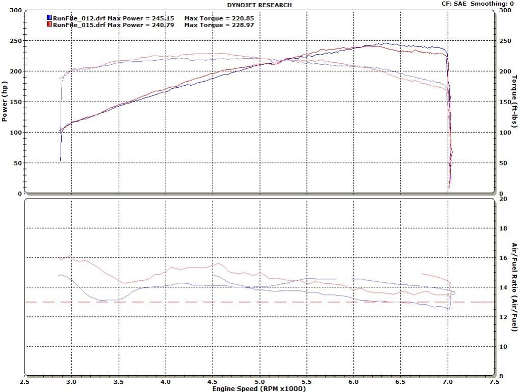

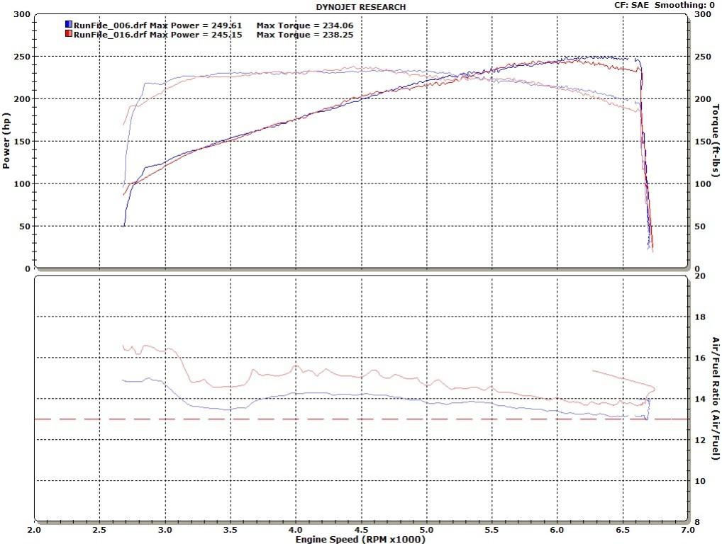

Got the run files. Just to refresh everyone's memory, this shop does 3 pulls. To make sure I could compare against my November baseline(at the time ztube, k&n, kinetix cats, and 350z midpipe), I had the first two pulls performed in 4th, and the last in 5th.
The first graph compares the first pull yesterday to the first pull in november.
The second graph compares the second pull yesterday to the second pull in november.
The third graph.. bla bla bla.
Attached Thumbnails MREV and Stillen 1st Gen installed-firstpull_4th_small.jpg   MREV and Stillen 1st Gen installed-secondpull_4th_small.jpg   MREV and Stillen 1st Gen installed-thirdpull_5th_small.jpg

So, there are 8 graphs to comparison and analysis. At this point, I'm not entirely sure the A/F is *the* problem. I'm honestly quite concerned with the signature of my torque curve. This is just an assumption, an uneducated one at that, but I would guess that even with my a/f problems, the torque signature should show a greater resemblance to what we've all seen for the MREV instead of shadowing my previous curve.
So, next step is to take off the crawford cats and dyno again. Fun fun fun.
Also, for anyone that has winpep and wants to do a more depth analysis, I have attached a zip containing my 3 pulls from November, and my 3 pulls from yesterday for your edification:
