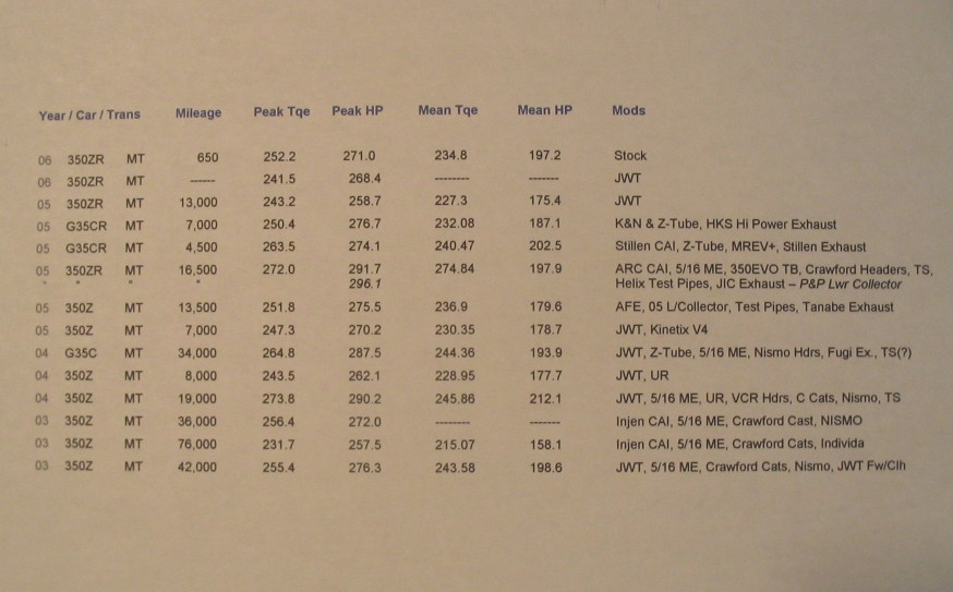

Old Mar 3, 2006 | 10:45 AM
  #89
DaveO's Avatar
Joined: Aug 2002
Posts: 1,129
From: Hi Desert, Kalifornia
G35CR = Coupe w/rev-up engine
350ZR = 350Z w/rev-up engine
