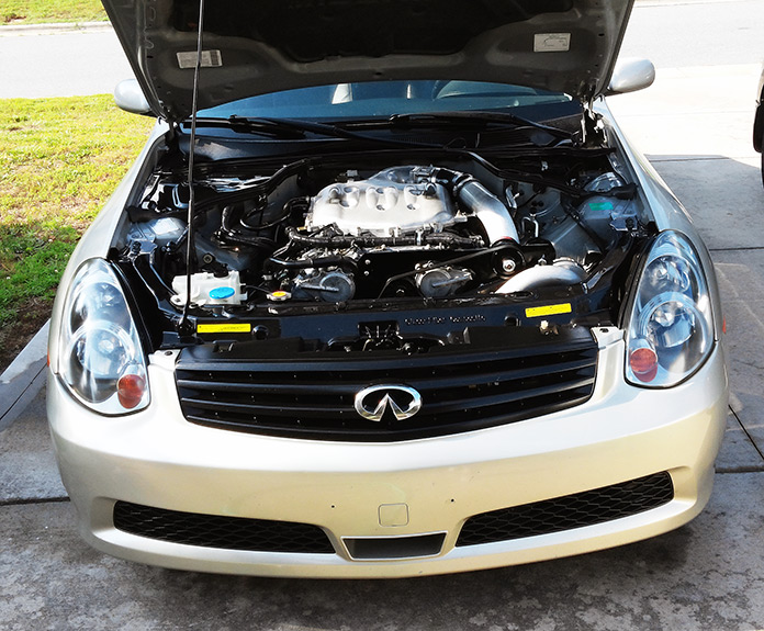

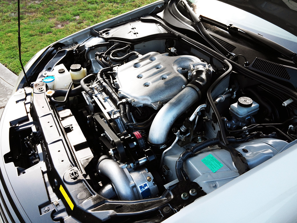

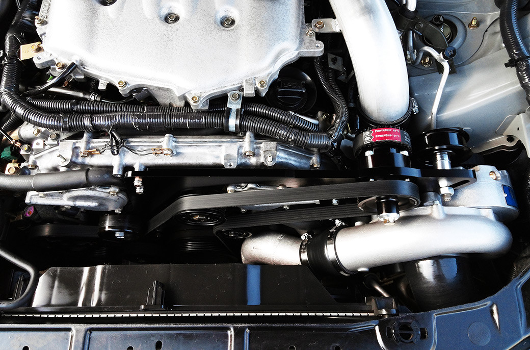

Well I got the car back! Everything is running awesome and I'm definitely happy with the money I spent. Car turned out with 350hp/300tq to the wheels. It sounds awesome and it pulls pretty darn good I think. Not the most powerful car out there but I can't say I've seen many X's with the Vortech kit. Driving back and forth to work is pretty fun now.
Here are some pics of the install, let me know if you need more pics...
