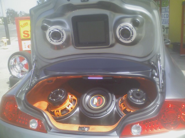

If you have an aftermarket sub and its rattling, it's because you have alot of bass, you need dynamat. The G Coupe sucks badly when it comes down to hard hitting bass, as much dynamat as I try to put in, it still rattles here and there. I got the whole inside of my car and the trunk dynamated and it still rattles sometimes, I don't think the dealer would do anything if you're car rattles, especially if it has an aftermarket sub haha. Get your self some dynamat, do it yourself or bring it into a stereo shop, the dynamat might solve annoying exhaust rattles also.
I had plenty of rattle in my G!
