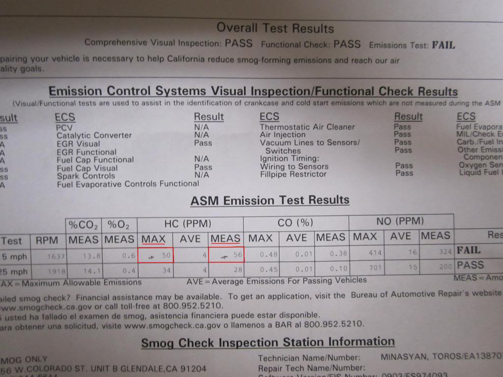

No, They just put the sniffer for the smog check in the tailpipe and run it through it's gears.
But if you have HFCs you probably won't pass, the numbers for the allowed emissions will most likely be too high.
It was for me, so I had to put the oem cats back on and then went back to the same place and passed.
Here were my #s with Berk HFCs the 1st time.

Old Jan 22, 2014 | 09:02 PM
gary c's Avatar
Posts: 19,433
Likes: 1,133
From: Valencia, Ca
Don't be fooled by the above posts! CA. has the new STAR system and requires more than just the sniffer test. They visually go over your car, even after market intakes won't pass without a CARB sticker. HFCs won't pass because there isn't one that's legal in CA., they won't pass the sniffer test! You need to swap the OE cats back on, drive your G for 25 miles and then take the test which you'll pass unless you have error codes.
